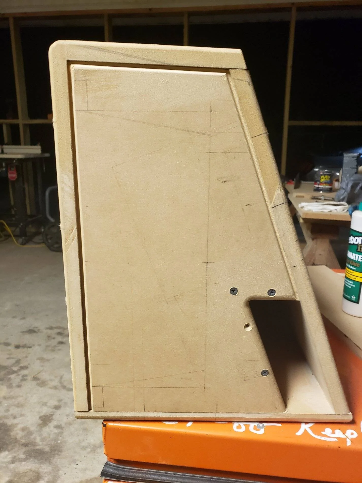

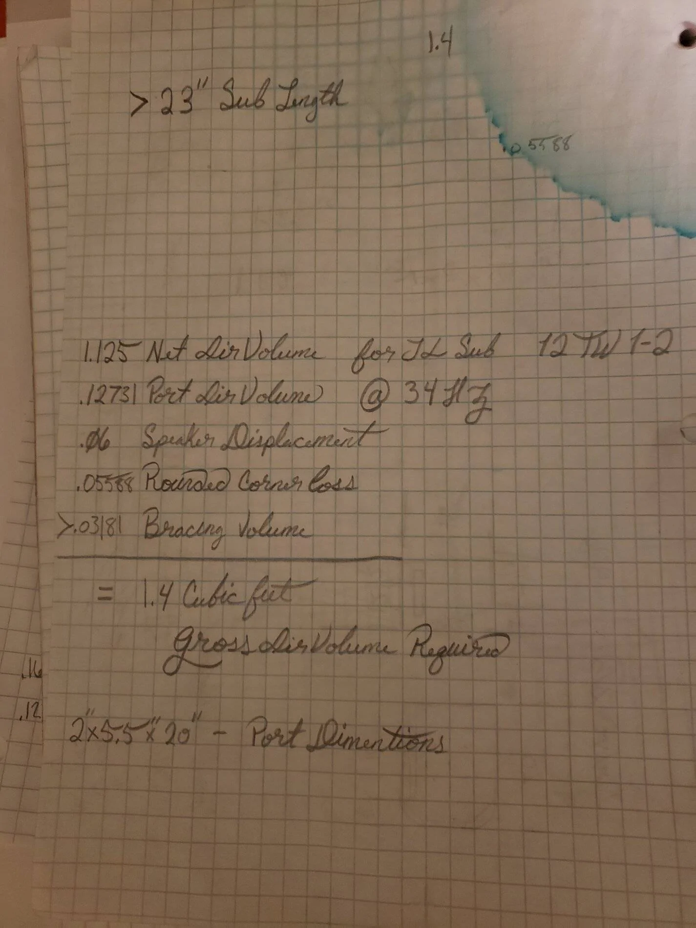

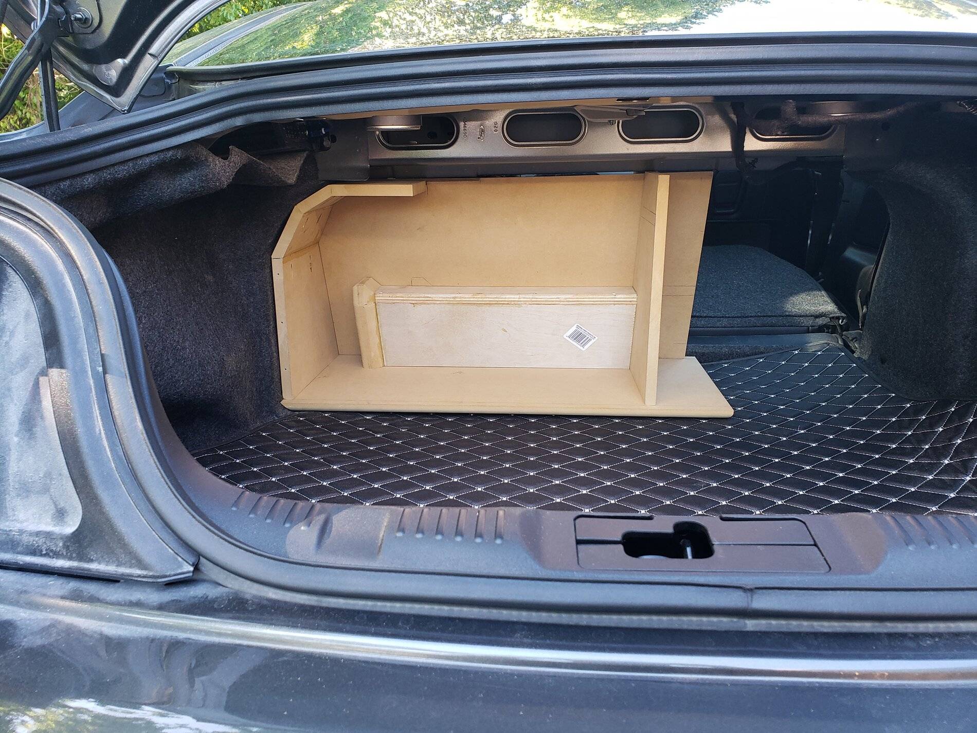

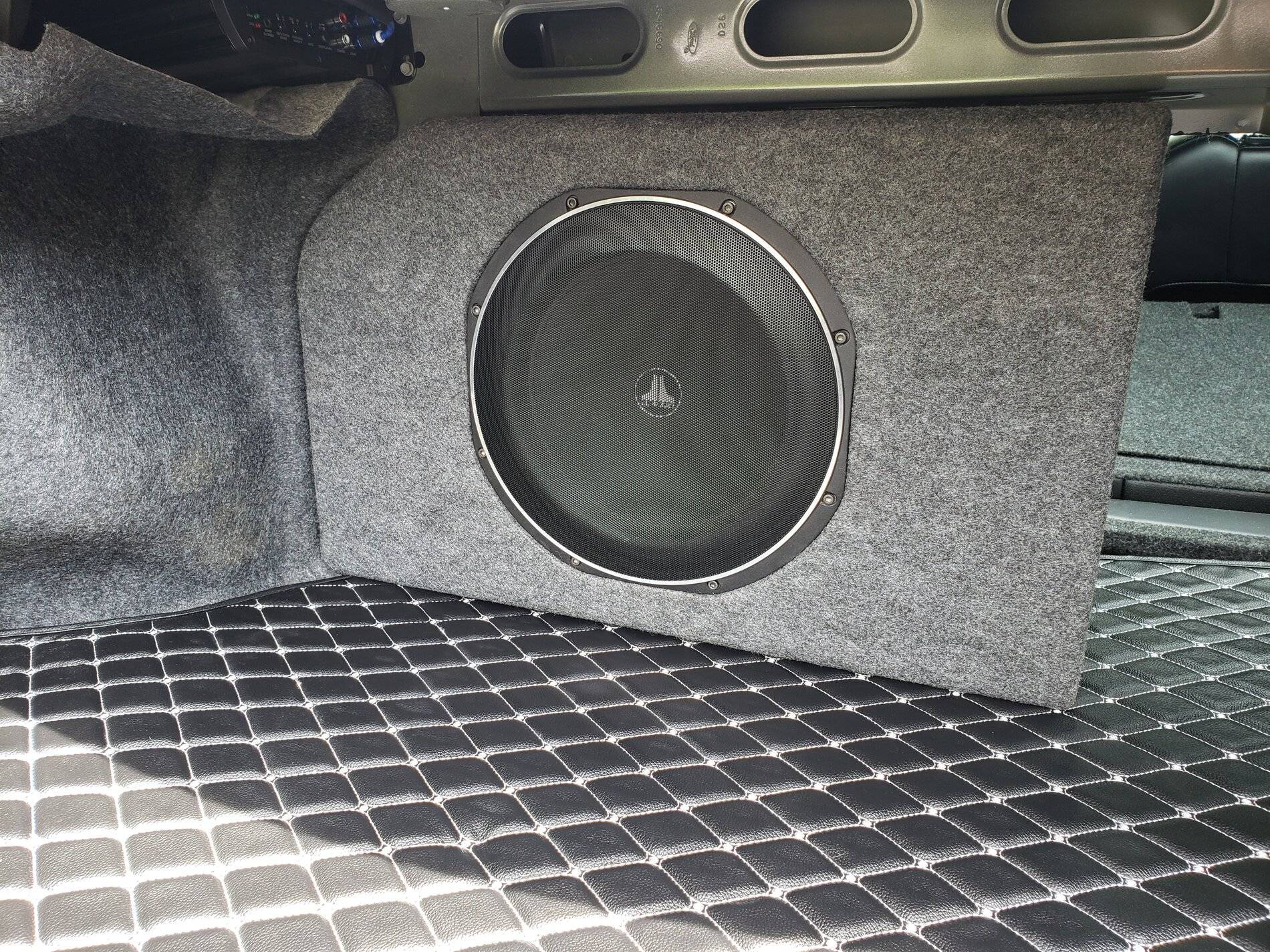

Hey guys, just thought I'd show the ported sub I made for a 12" JL after not finding what I was looking for that allowed me to use the pass through, and after hating the box I had a place make that was too bulky. Hadn't made or wrapped a box before, but came out decent.

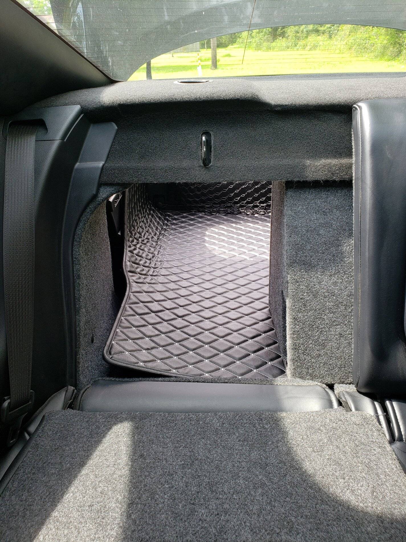

Looks great! I like how you retained the pass through on the passenger side.

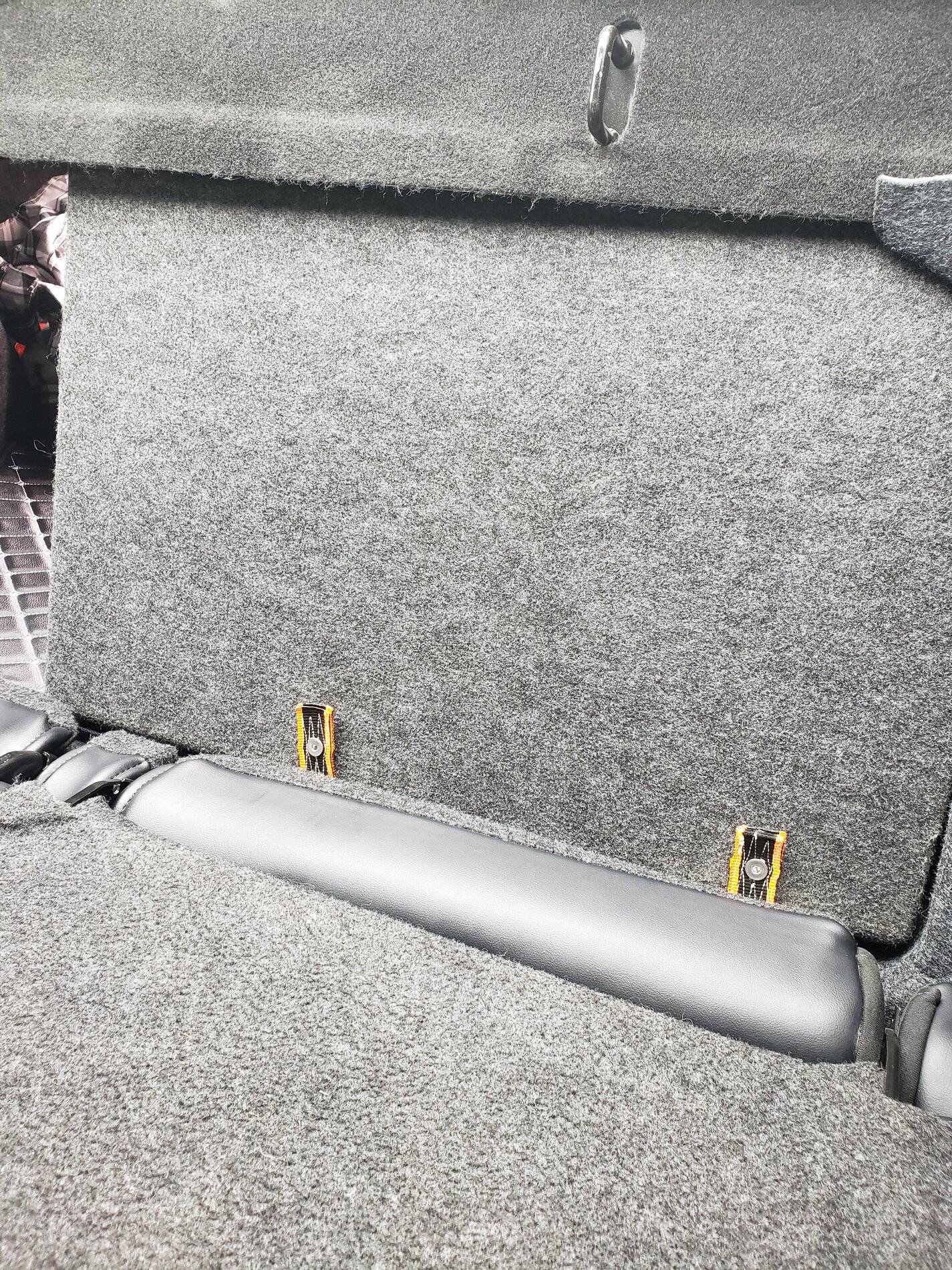

How are you securing it in place?

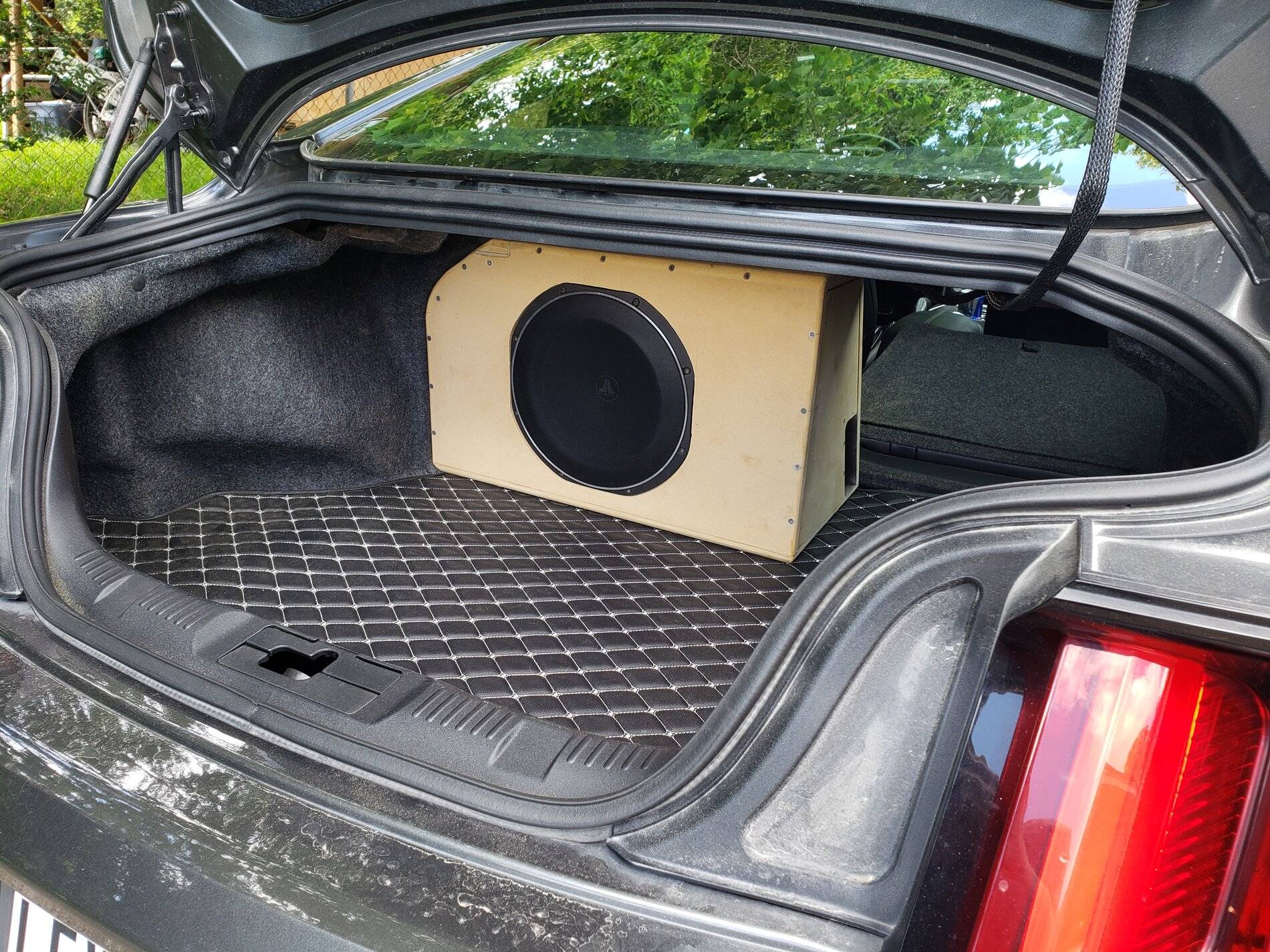

Viscosity6 5
Viscosity6 5
Feb 18, 2021
18 Mustang
I couldn't find a way to secure it more permanently without cutting the liner or having a bracket exposed. So I used 2 cheap nylon looped straps that slip down and just loop around the car seat hooks.
That side is usually up anyway.

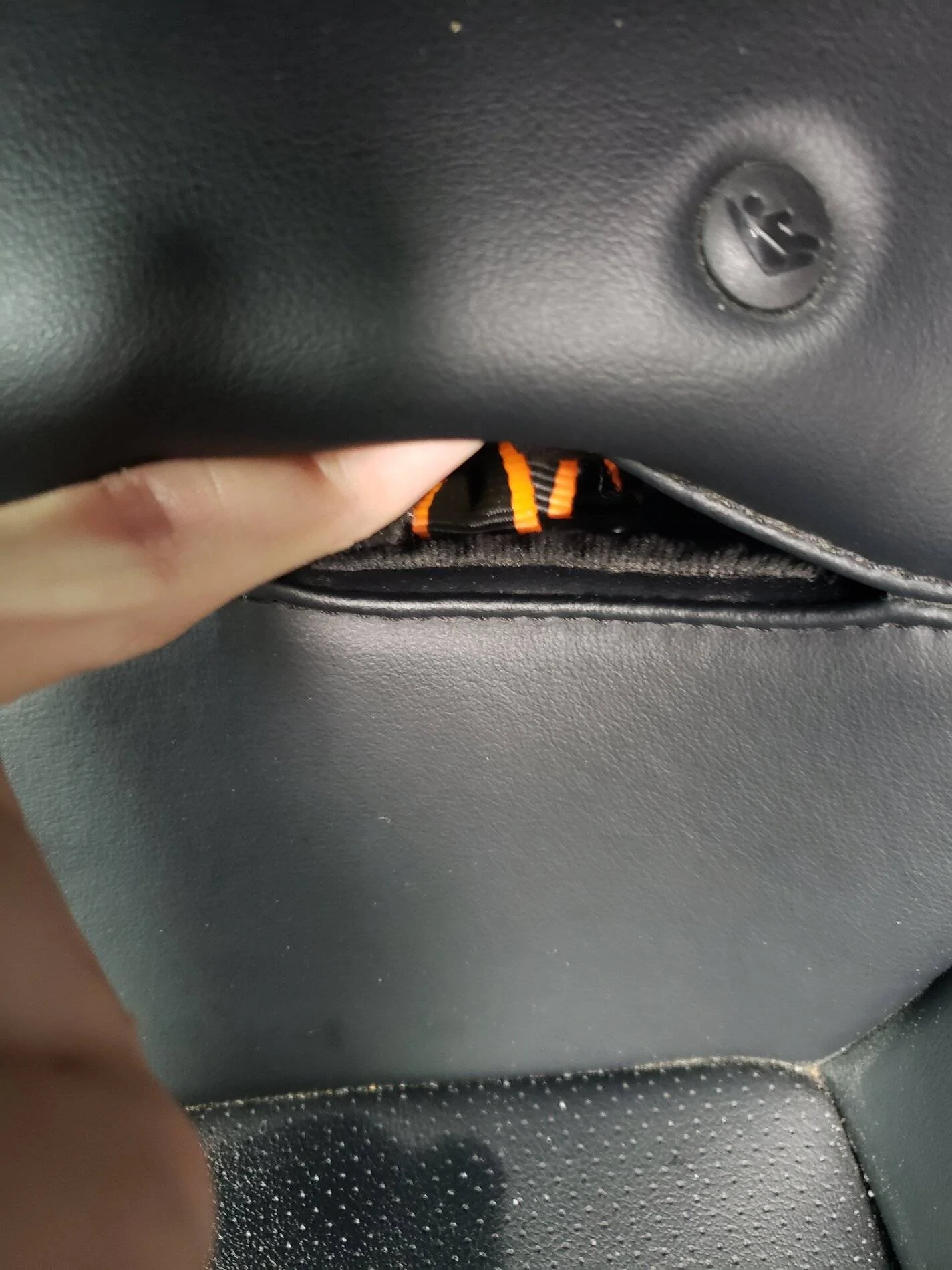

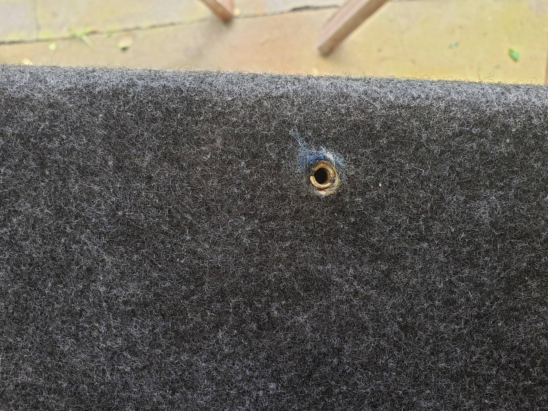

That last photo shows a threaded insert that im assuming a bolt threads into for the straps, correct? What’s that insert called?
Viscosity6 5
Viscosity6 5
Feb 18, 2021
18 Mustang
Yea, I just used a pair of threaded insert nuts for the bolts.
