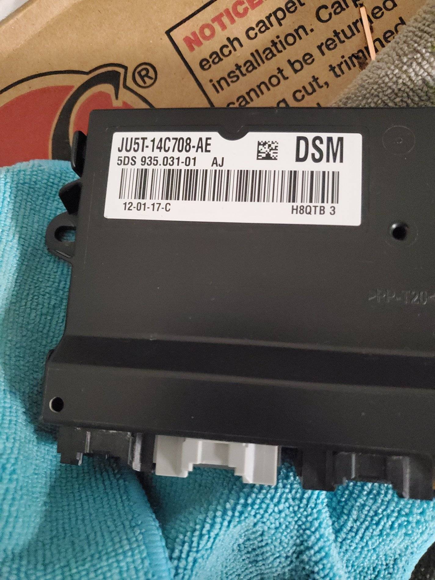

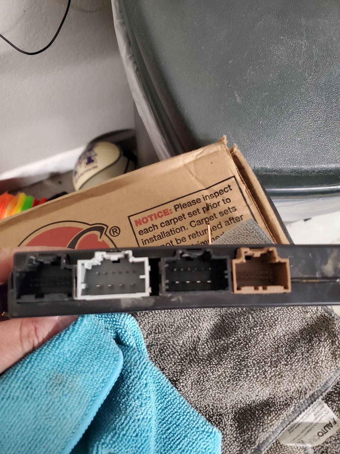

Here is a picture of the only module under either seat and it's under the drivers side. Numbers show that it is a Power Control Module. I wonder if the heating control is pray of this and has stopped working for.some reason. Any thoughts? Thanks

Yeah, that's the Driver Seat Module. If equipped with cooled/heated seats, there's an extra module inside it, called the SCM-E. Then a TED/fan assembly on the seat bottom and seat back (total of 2). I was expecting the seat heating to also activate the fan, but that's not the case. So my guess is there has to be a regular heating element in both the seat cushion and seat back, just like any other car. If nothing is working (both cooling or heating functions), I'd start with the fuse. If okay, then I'd suspect the module, since it'd be extremely rare that everything crapped out at once.
Did you reset both the DSM and SCM-E modules? I'd try that too. I did, and my seat cooling works, but haven't checked if the SCM-E threw the same code again. Will probably do it tomorrow.

So the module pictured does control the heating and cooling seats? How do you reset it? All fuses look good so I might try replacing that module if in fact it helps control the heating/cooling feature.

Yes, it controls the heat and cool functions, but as I mentioned, the other parts of the system might be bad, and not the module. Check for codes; they'd tell you what it is. In my case, I got a seatback TED code where resistance was below threshold. It still works though. I reset both the DSM and SCM-E modules via FORScan (the wrench menu). Tried both the heat and cool functions and they worked (as usual), but haven't checked if the code was thrown again. If it did, I won't erase it anymore. The weird thing is everything still works, but might crap out later, I guess. I won't use the cooling function too long again, which is probably what triggered the code (the back of the seat felt pretty hot).

I ordered a new module. Cost $80. Figure with all the other trouble shooting I have done,.might as well try that. I will respond back when it arrives in 5 days
