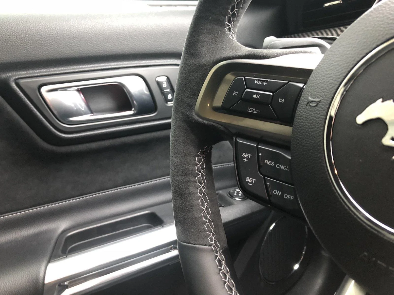

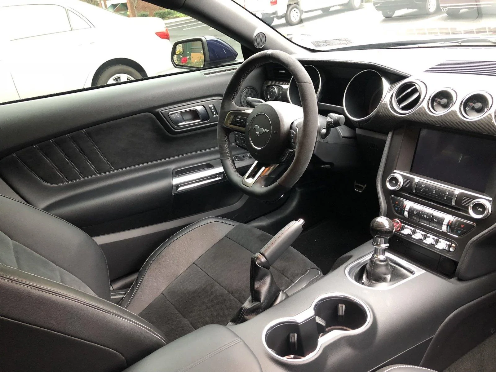

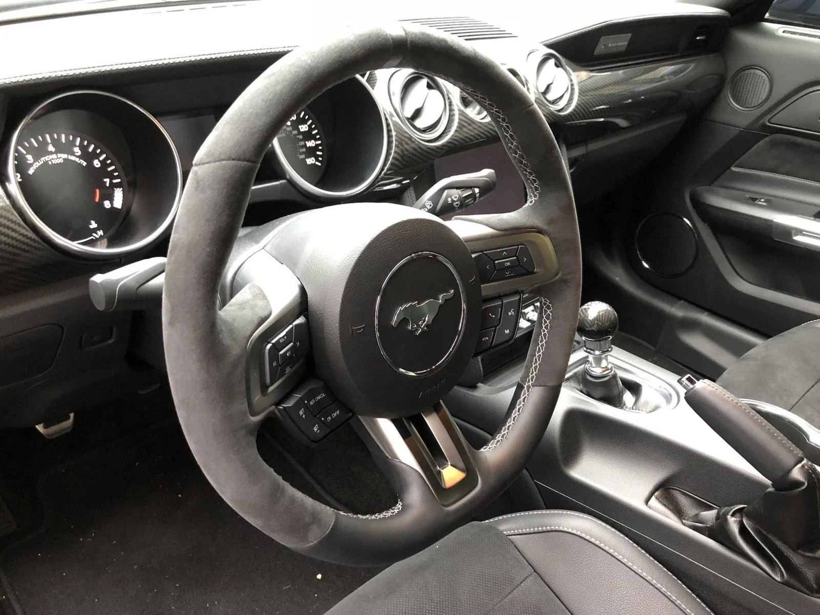

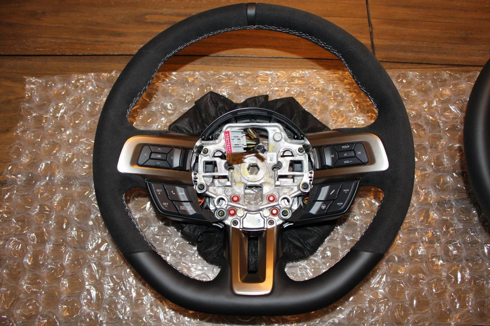

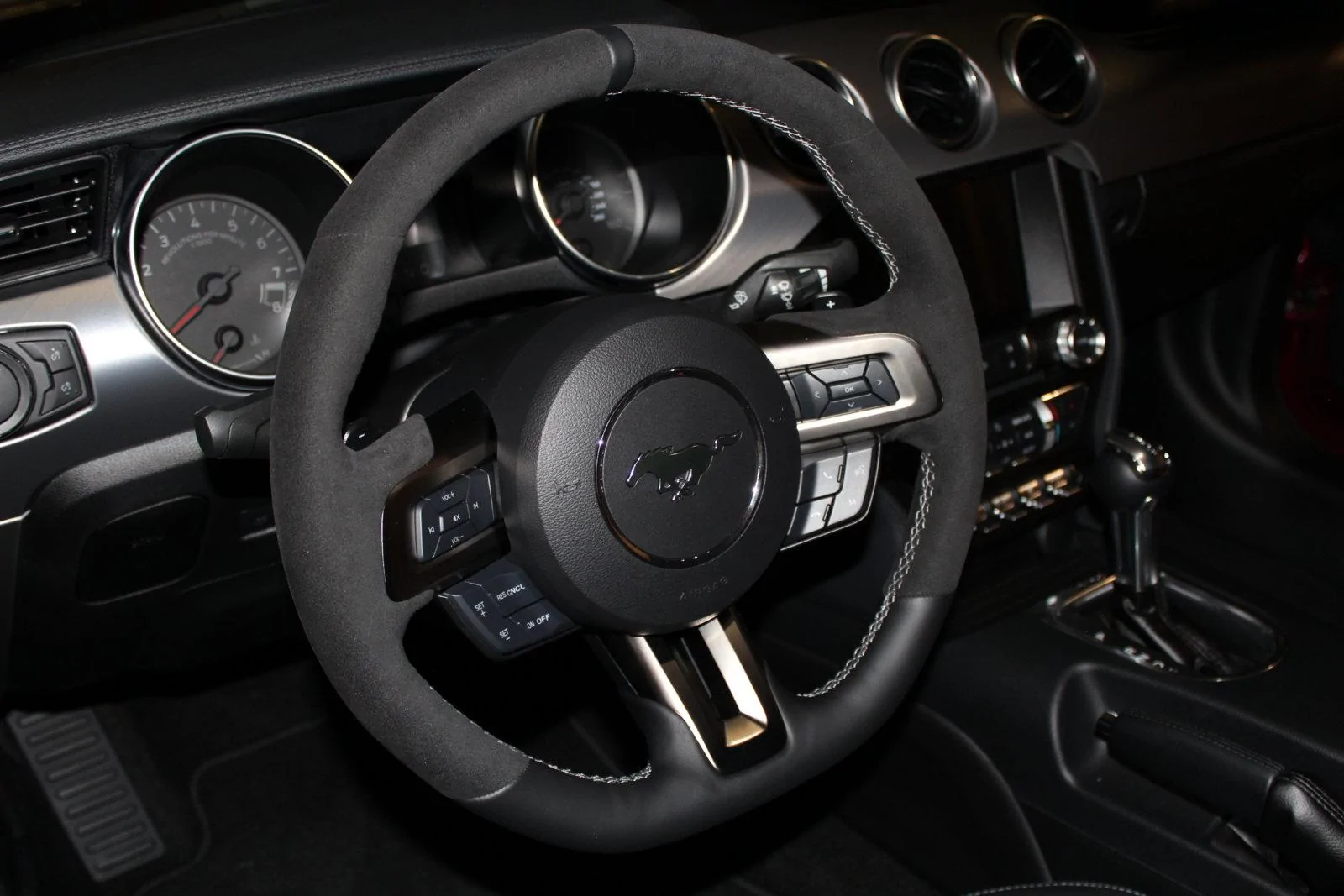

After doing some research, I finally installed the 2018 GT350 steering wheel in my 2018 GT (400A/A10)!!!
Shout out to Mike R @Autonation White Bear Lake for going over VINs and part numbers with me.
The 2018 steering wheel and airbag part numbers are different compared to the 2015-17's.

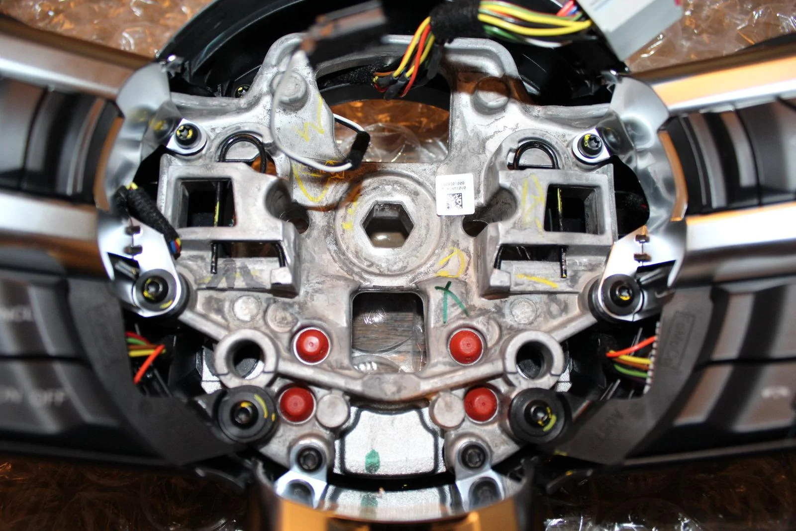

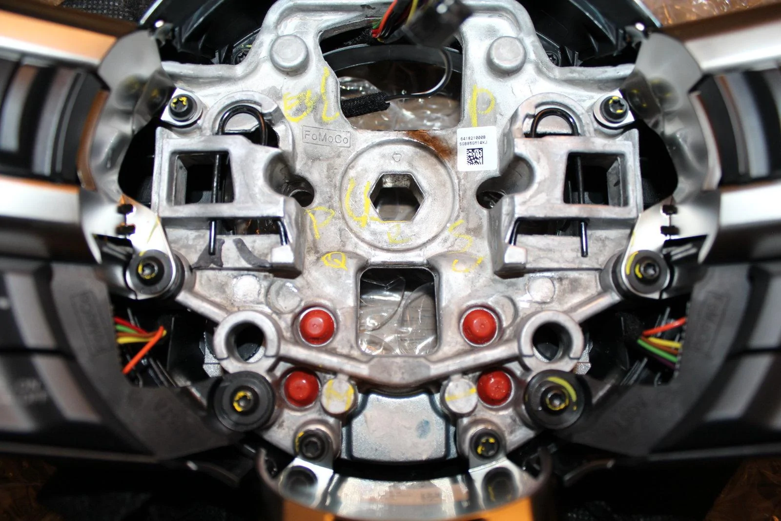

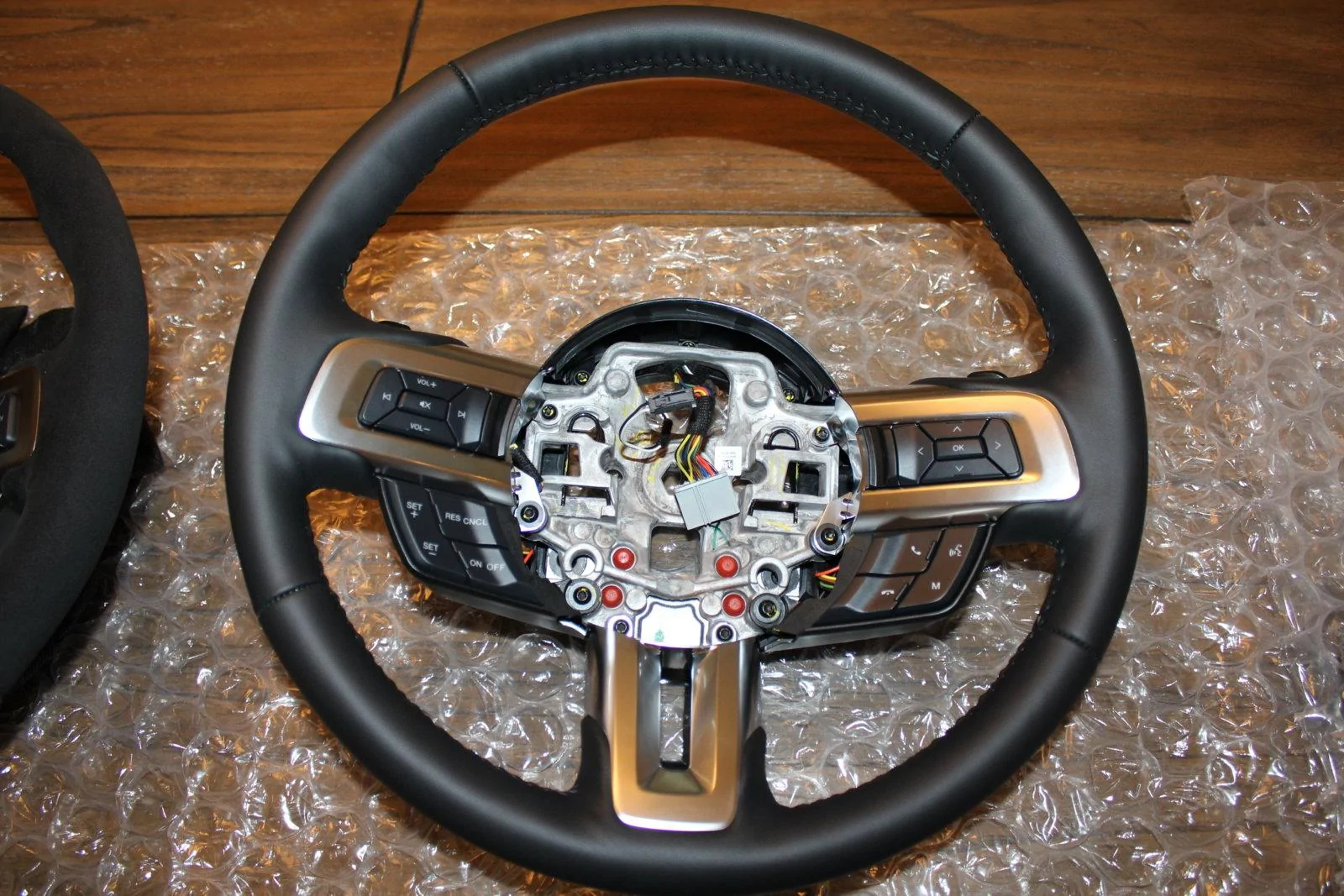

I ordered part# JR3Z-3600-AB.
Swapped over the buttons, trim bezels and airbag. Everything was plug and play.
