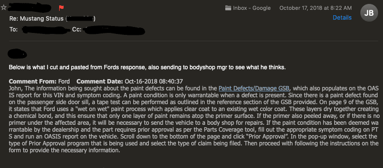

In the response from Ford, they explained the wet on wet process, but only for the paint and clear coat. See their response to the dealership (who then forward it to me) :
