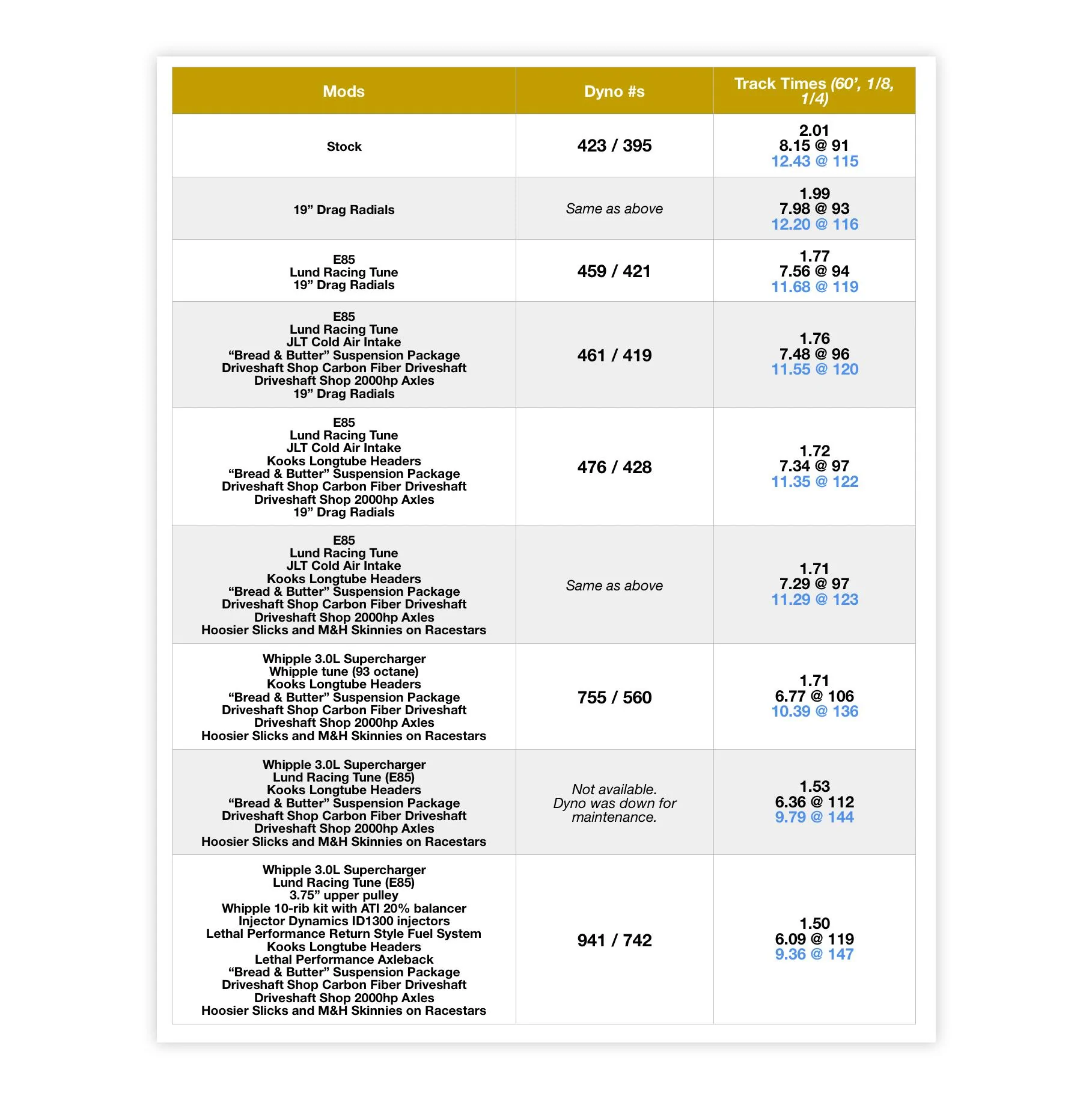

We picked up a good amount by adding the headers over the E85 tune with stock manifolds. We added the Kooks 1-7/8" LT's along with their offroad pipe. You can see on our build progression how they helped with added HP/TQ but also lower ET's and higher MPH's at the track.
Let us know if there's anything we can help you with in the meantime.
