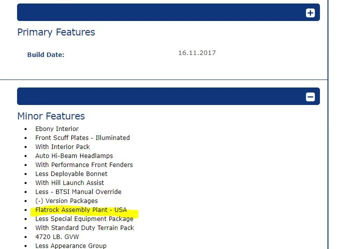

The easiest way (other than door sticker month/year) is to go to www.etis.ford.com and register (free). You will then be able to enter a VIN and get the exact build date. Note that the format will be DD.MM.YYYY. I attached my info as an example. You will also see the Assembly Plant as well.
You can also use this site to lookup other Ford VIN's.
On the window sticker, the closest date would be above "BLEND" at the top which I think is the production start date. 1 YYYYMMDD
