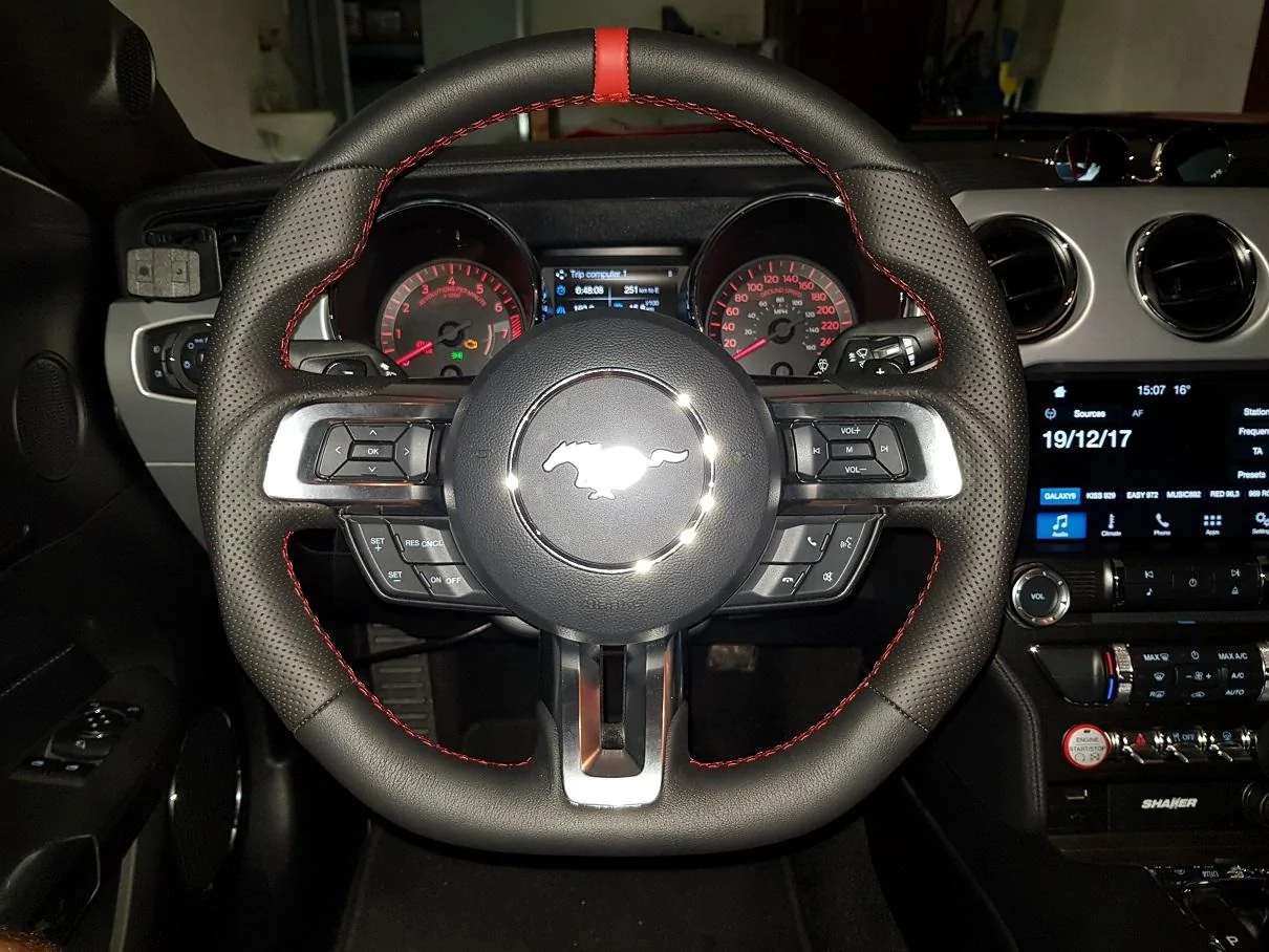

Thanks both for the videos. [MENTION=33326]DallasEl[/MENTION] I have already replaced my steering wheel a couple of months ago, so fortunately I am familiar with this part of the process!

[MENTION=27749]MakStang[/MENTION] old cluster looks good, few friends of mine are huge fans of analog.. and yours looks good..

Thanks @DallasEI, I still remain undecided whether I should switch to the digital cluster or not. To be honest, I really like the analog one a lot and I was reading somewhere that people in the US already started having issues with their digital clusters. Actually there is a recall from FORD and people have to wait a long time for the fix... However, if I can find someone in the US to have the parts sent to, in order to avoid high import taxes in Europe, I might do the swap, for the heck of it! If I don’t like it, then I will revert back to the analog cluster and will sell the parts.
By the way there is a very nice video on youtube that shows in every detail how to remove the steering wheel. It’s useful, especially if your car is an auto with paddle shifters.
