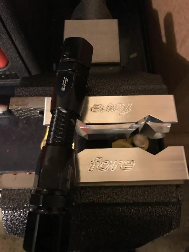

Step one - test fitting my first hose connection check valve to filter to get a feel for those assembly part. It’s about as simple as simple gets. Love it.
OCD has already kicked in though, I misaligned the logos on the fittings... might cut a new section and do it again lol

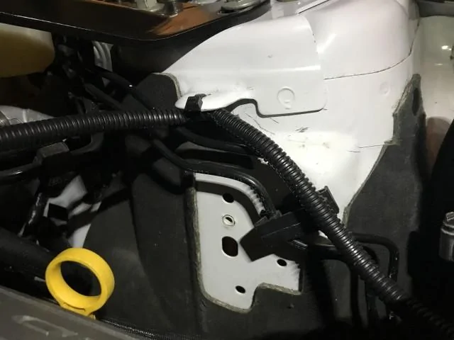

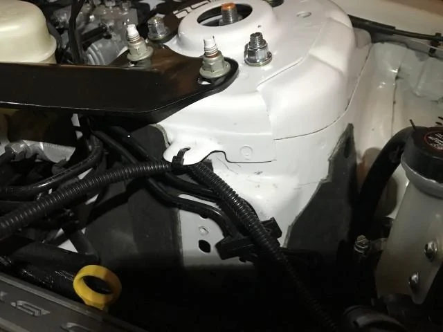

Ok here's a couple pictures I took - I think I see what's different - my car has some sort of bracket welded to it which I think may have been where the stock sound tube or something clipped - I dont remember exactly - it sticks out where your regulator is.
I cut away some of the fiber and was test fitting it as best I could - did your car not have the little bracket at the top of the shock tower like mine ?

Yes, that is the piece that needs to be cut off and your just trying to make a flat area. You have a wire harness zip tied to it so you’ll have to relocate that.
