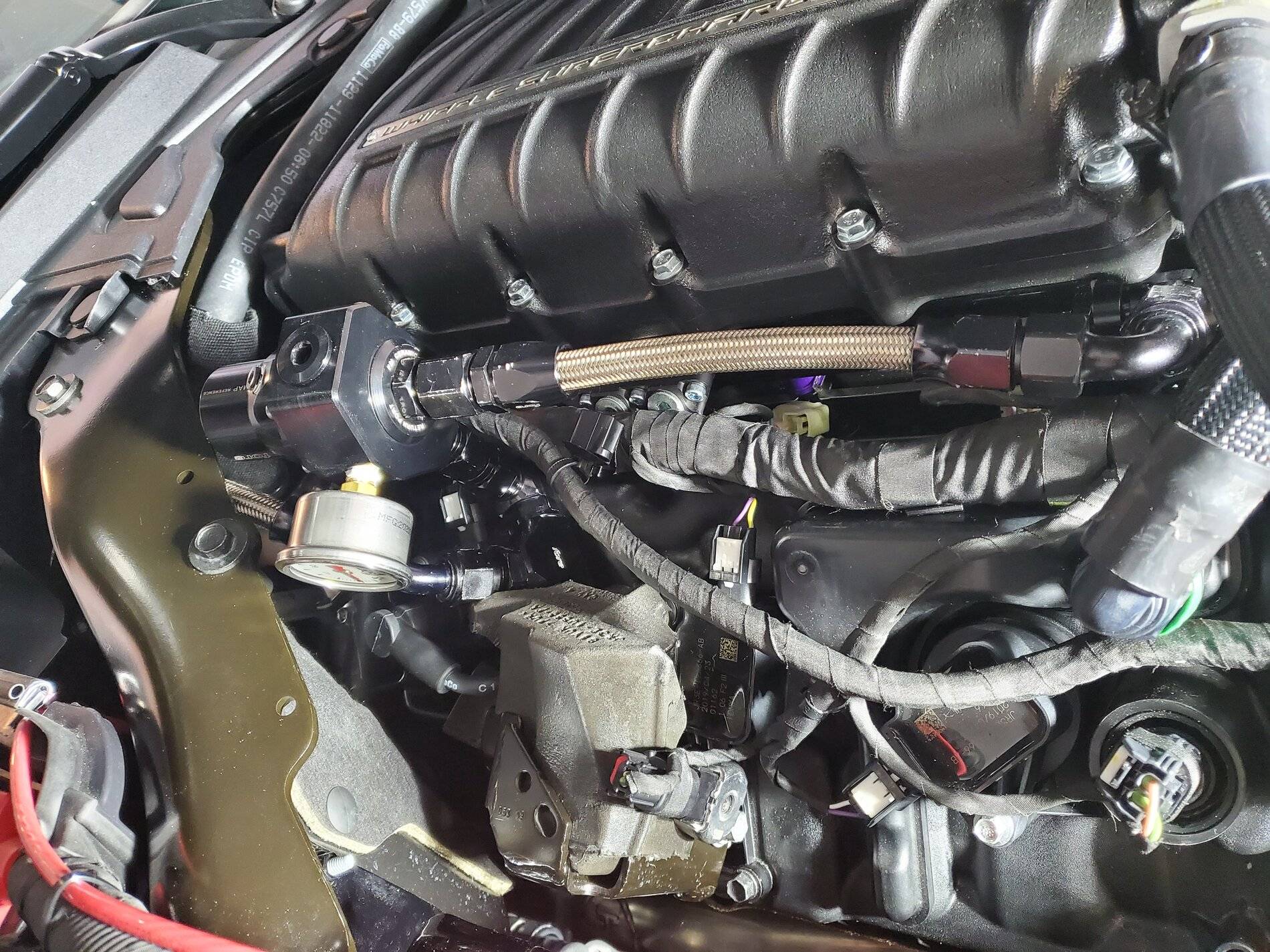

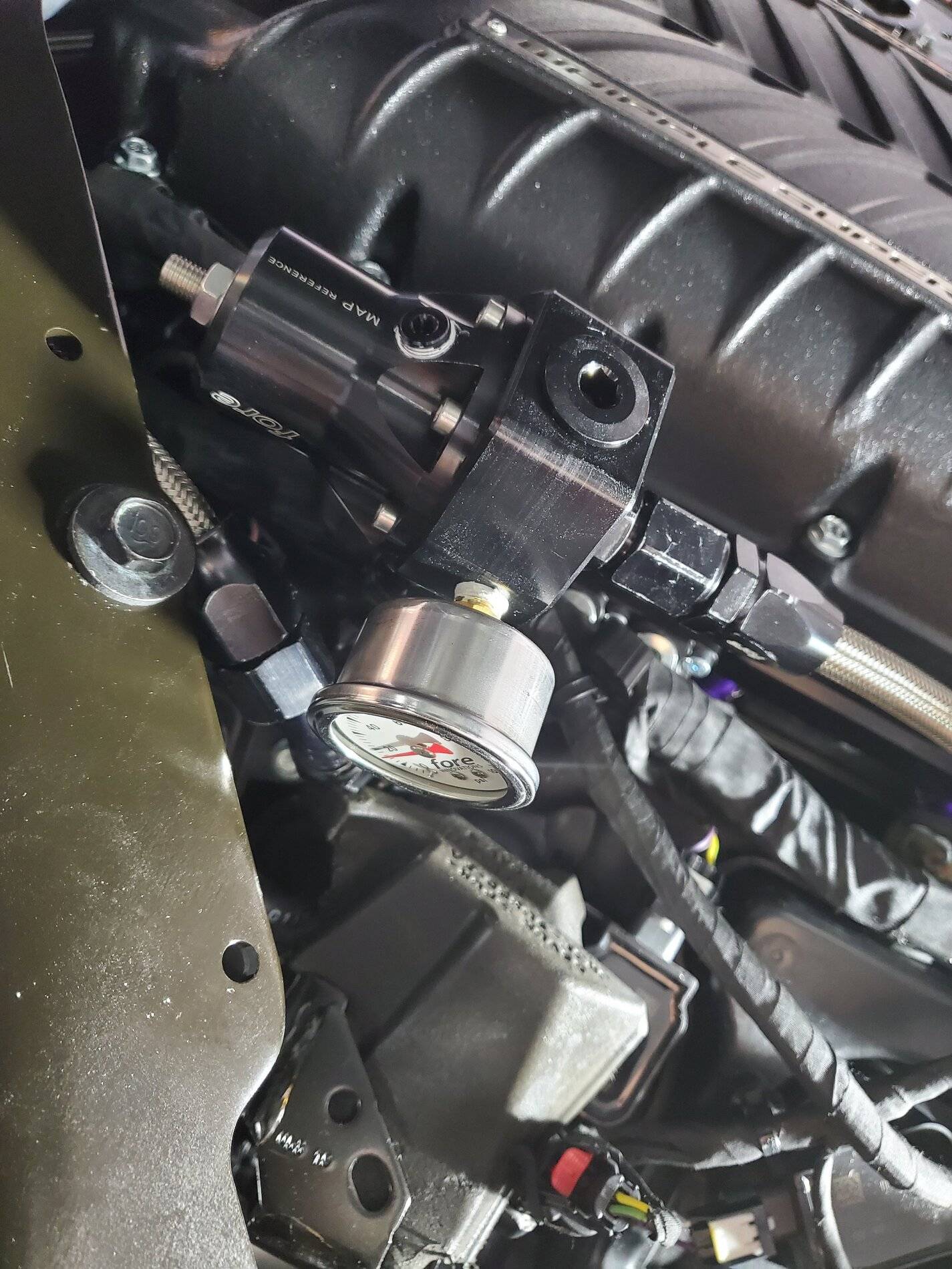

So installing FORE L2 fuel system in my 2019 and trying to determine good location for the passenger side fpr. I have not seen this done yet. I have good clearance under the hood (I do have the motor dropped 1/2" with motor mounts). Anyhow I used a -8 female to female adapter to attach the fpr right to the tblock. Anyone see any potential issues with it? Or should I move it like I see most people do? Any pics of your install would be appreciated. Thanks all.

As long as something is holding up the weight you should be fine
