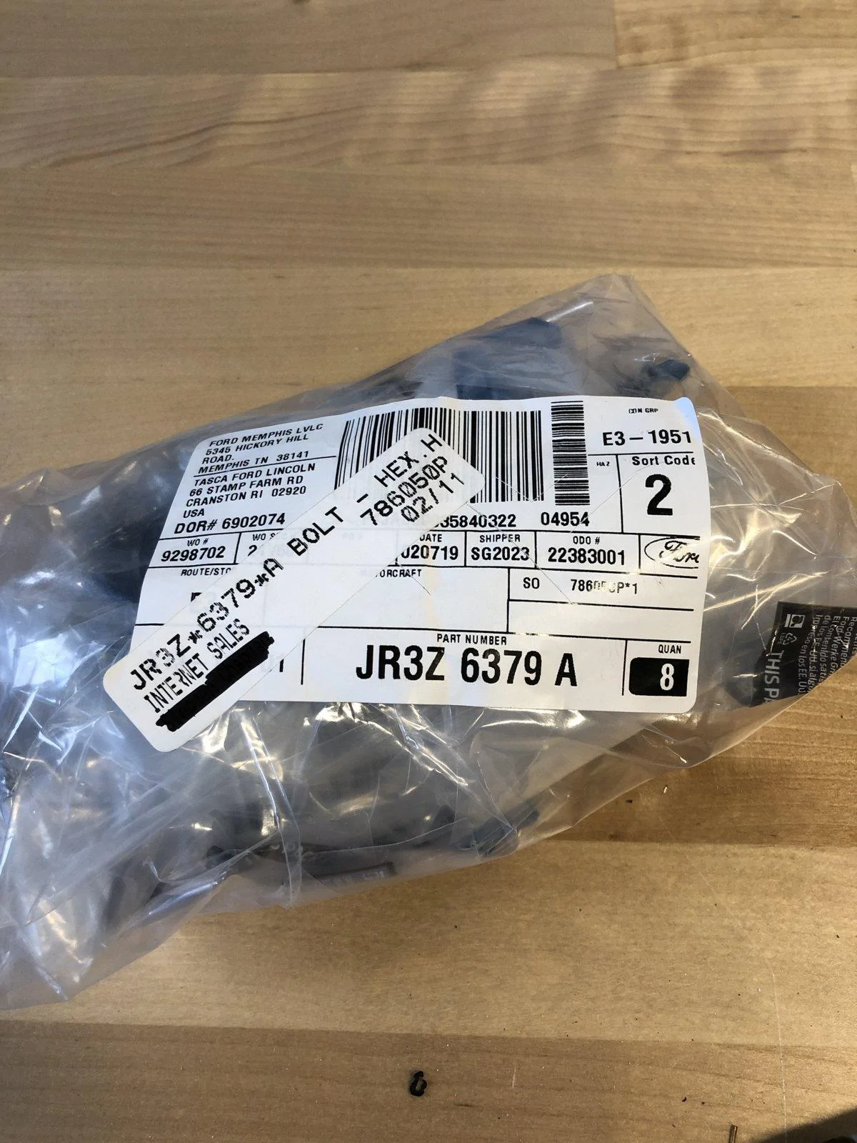

The correct part number, and only option as of this writing, is :
FORD OEM PART JR3Z 6379 A

Based on his recommendation, I called Tasca, gave them my VIN number and found the flywheel bolt part number to be JR3Z-6379-A, Bolt - Hex.Head x 8 for like $9.28. This plus 2-day shipping (since they have to be special ordered from somewhere else to them and then shipped to me) ended up being $35.69. I also checked local dealers within 200 miles and no one has them. So I asked Tasca - is this bolt listed for the 2018 the same as the 11-17 just for comparison purposes. He ran the number and found it to be the same as the 11-17 cars in his search, optimistically indicating that bolts are the same for 11-18.

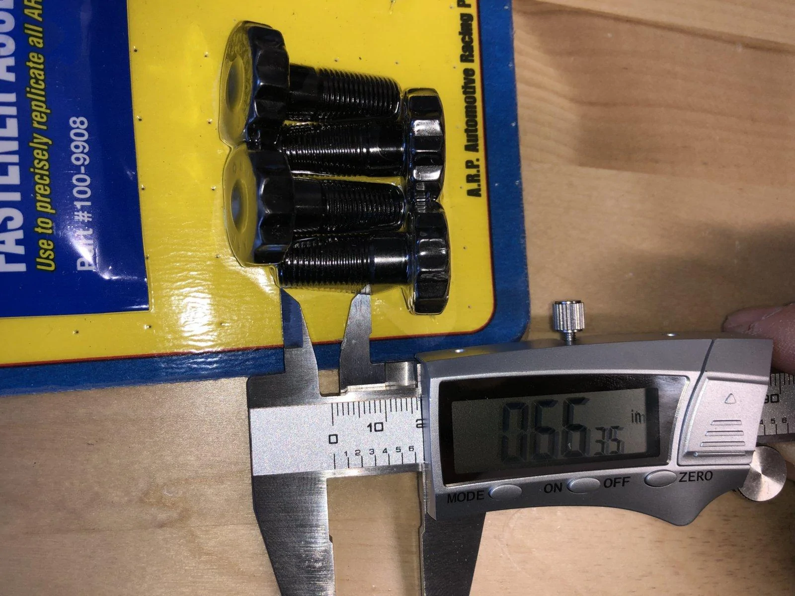

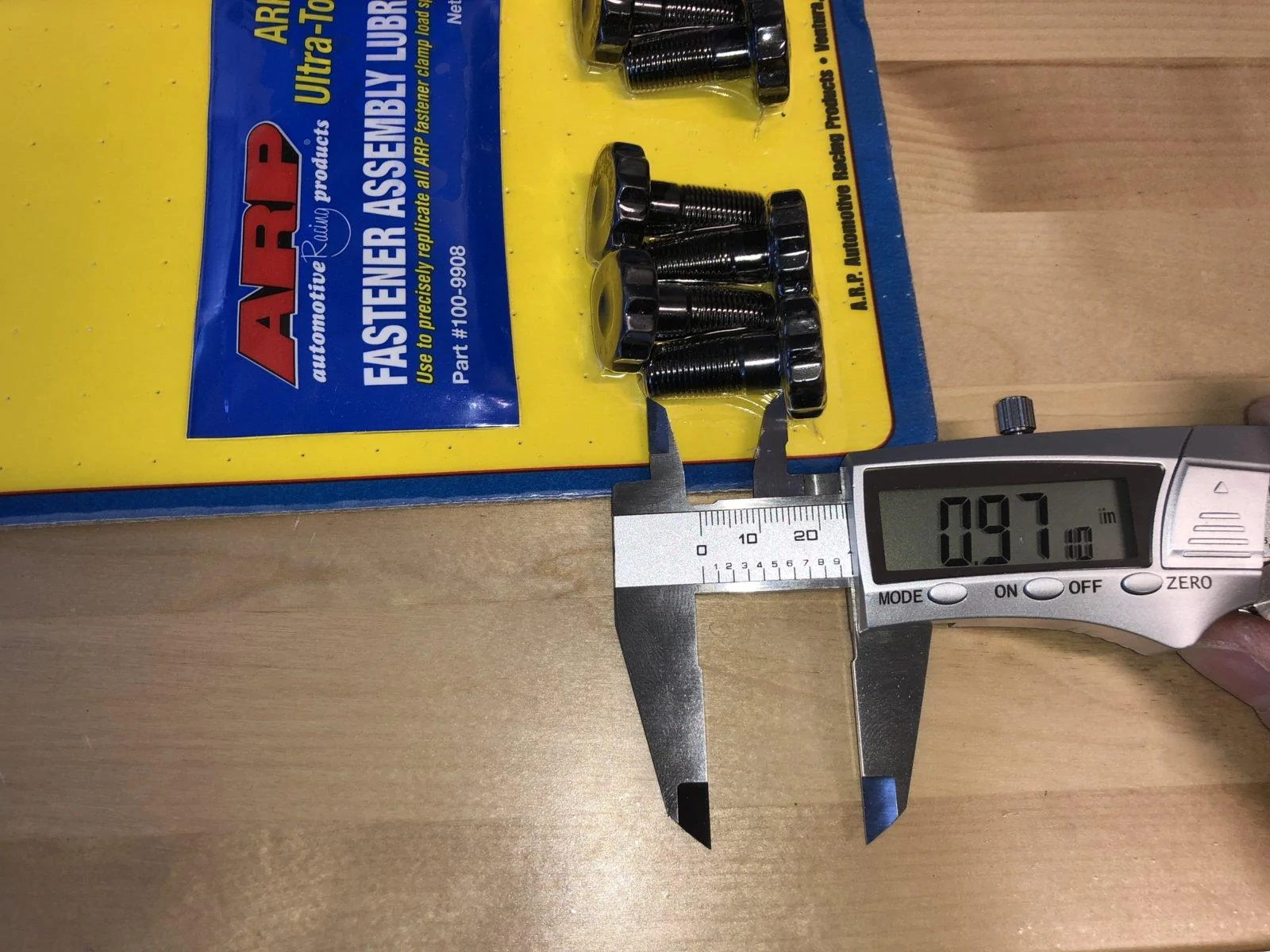

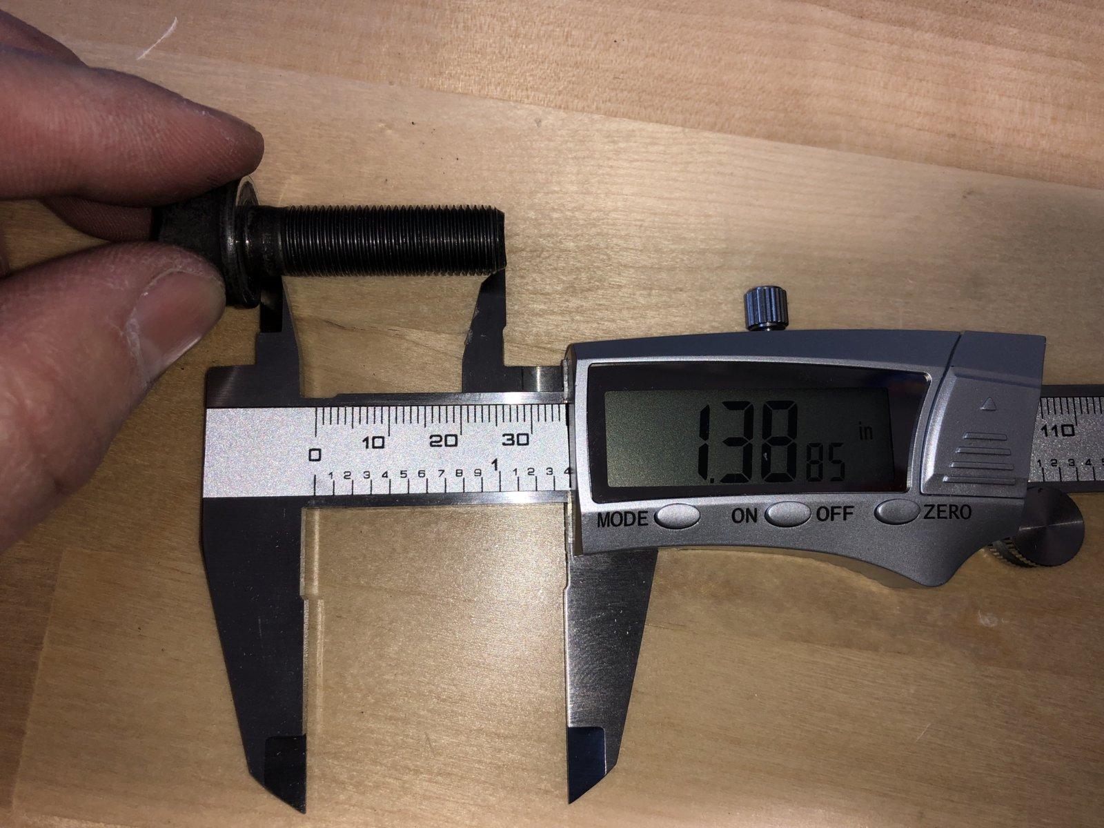

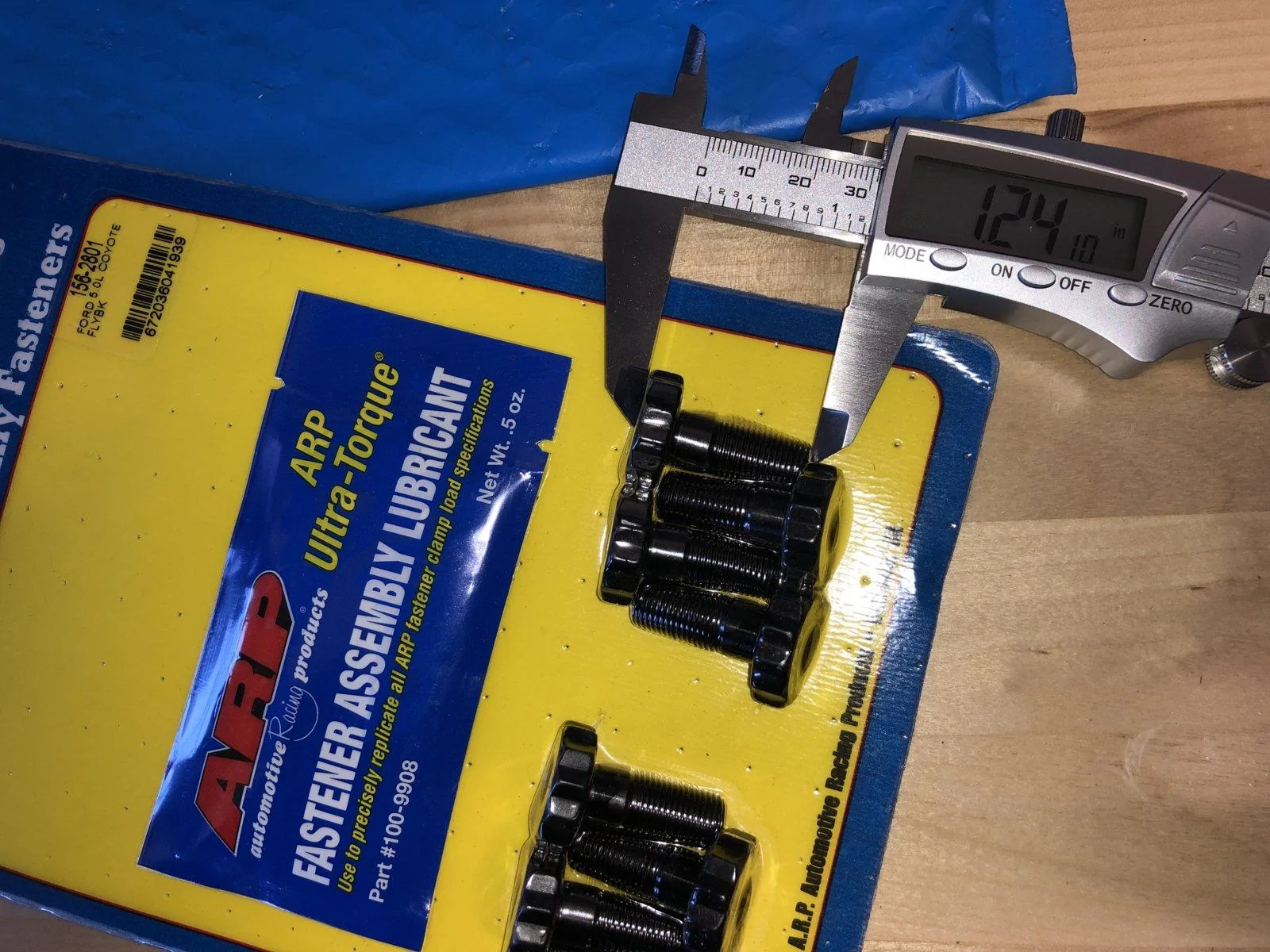

I thought, "maybe this is a good thing." If they're indeed the same, then the ARP fasteners could work after all, right? Since there were no immediate replacements for the bolts that weren't in my kit, Mantic and my vendor worked it out and my vendor sent a set of the ARP fasteners since they're purported to be the same length by Tasca's part reference. I figure if they're wrong length, I can mail them back and just wait on the OEM's to arrive, assuming those will be correct.

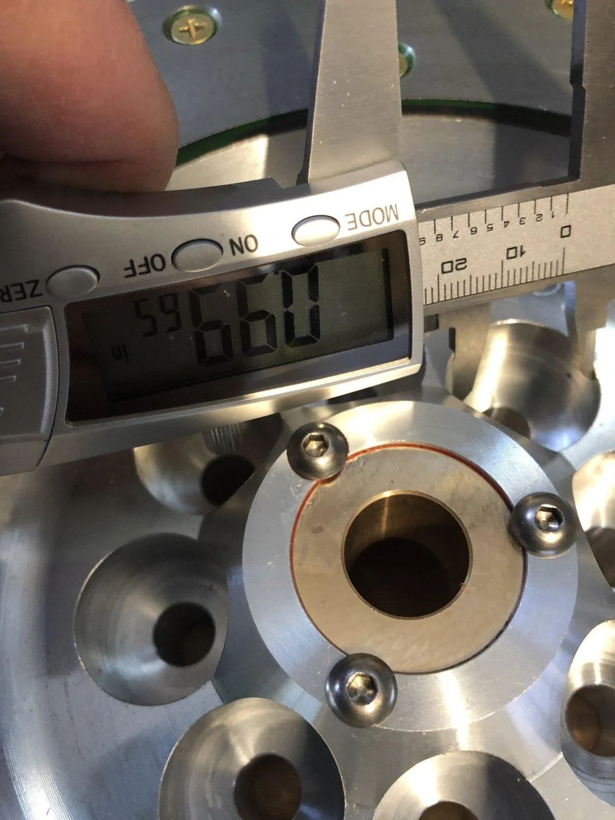

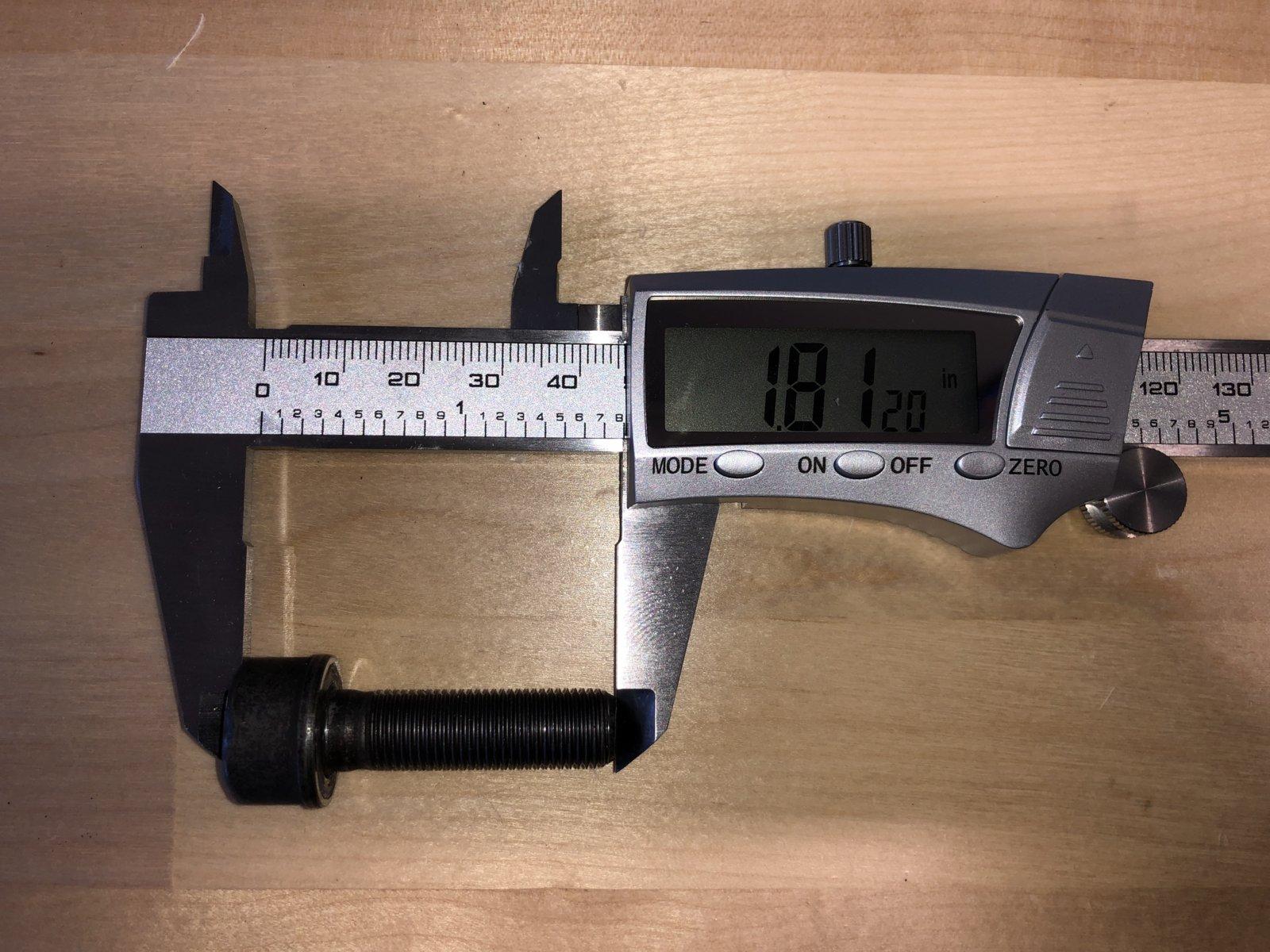

So I pull my stock flywheel bolts and it's obvious they are much longer than the ARP. I mike them both and there's a 0.4" difference in threaded length between them. Not even close. So I mic the flywheel flanges to see if maybe one flywheel is thicker or something- they're 0.72" +/- .01" - nearly identical. I also mike the bore of the Mantic flywheel and find it to be just under 1" diameter (0.9965 at the top of the bore).
Since ARP bolt kit for the 11-17 (part #156-2801) calls for a 12-pt 3/4" socket to drive the bolts, I check my set. My thin-walled Craftsman socket of that type is just a tad too thick to fit the bore of the Mantic flywheel at the top. I think there's a MAC socket that's 15/16" thick I can get for about $29 plus tax/shipping that might work, if the hole doesn't narrow as it deepens (my mike can't check that deep of a recess to be sure.) So it doesn't appear - on the surface - that the ARP fasteners are going to be a viable option; at least not this kit.

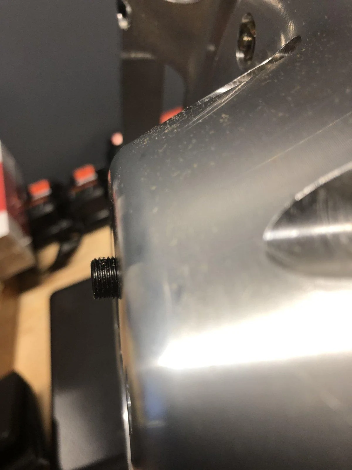

Update: I posted one last picture showing how much thread would protrude through the flywheel to bolt up to the crank. There's also a metal crank sensor trigger wheel plate between the flywheel and the crankshaft on the 2018 that is 0.1" thick, so it would actually be less than what you see (visible thread is about .26", with the trigger plate figured in, thread engagement would only be 0.16" with ARP bolts.
I really hope none of you who have 18's and had a shop install it have this ARP bolt kit installed. There's next to no thread engagement with them! (The depth of the hole into the crank to accept bolts -including the trigger plate - is about 0.9" for comparison.)
