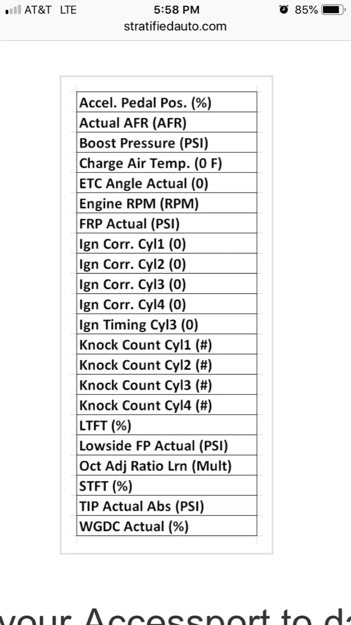

Have you data logged these parameters shown in the attached screen shot taken from Stratified website on what to monitor on data log to see how tune is working?

You can review the datalogs yourself, but you would need to know how to interpret the data.
The Accessport saves the datalog as a .csv file that you can then import into Excel and view all the logged parameters.
Once its in Excel, you can then select the columns you want to view as a line graph. Example: I have my Accessport set to datalog the parameters in that screen shot i posted.
I data logged a full 3rd gear pull from 2500rpm to redline. I took that datalog file and imported it into Excel. So what I wanted to know was, my knock count for all cylinders, where they occurred under load, how intense they were, and if/ how the timing bounced back after correction.
In Excel, I selected the 4 columns pertaining to cylinder ignition correction, Ign corr cyl1,2,3 and 4, and created a line graph to get a visual of the dynamics. I can also look at the datalog chart and see exactly when and where the knock occurred, how intense it was, and if it kept occurring.
This stuff is all free, it's just part of the Accessport features. You can't edit the tune, but you can see everything that's going on and know exactly how your tune is running.
To learn how to interpret the data so you can monitor your tunes, there's a bunch of free information available at Stratified Automotive Controls website.
