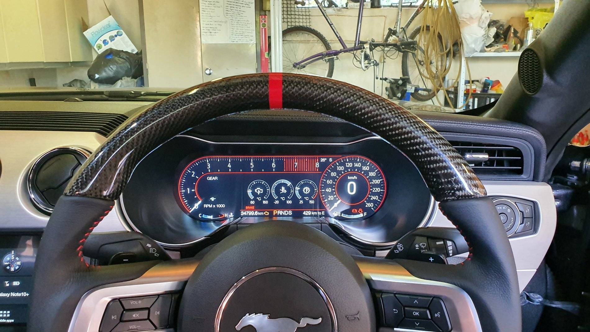

Finally had time to do the cluster install. Really awesome!! HUGE thanks to @breeves002 for orchestrating everything from purchase to delivery (excellent packaging!) and full programming of the cluster to ensure total plug an play install on my RHD!! :like:

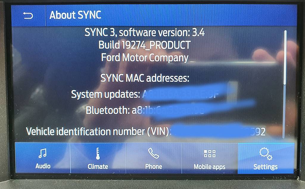

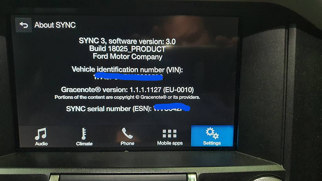

Not sure if this has been mentioned on this forum somewhere else, but I managed to get Google Maps turns showing on my cluster. I have a RHD 2017 Non-Nav APIM. I upgraded to Sync 3.4 following the procedure from https://cyanlabs.net/tutorials/update-ford-sync-3-2-2-3-0-to-version-3-4-all-years-3-4-19200/
I wont be able to advice or give any support if something goes wrong or does not work for you (and sure Ford wont support this...) - but for me it was a straight forward update and everything worked 1st time.
Upgraded From 3.0 to 3.4

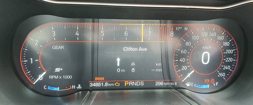

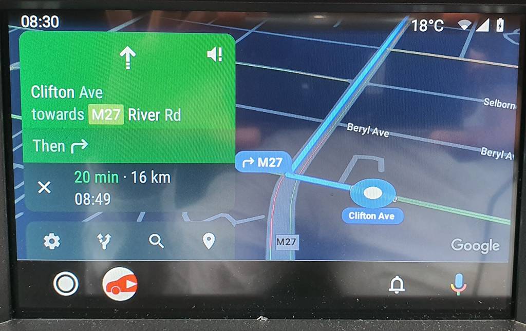

When I set a destination on my Google Maps - it shows turns on the cluster.

I'm a bit iffy to give guidance on this as there are real risks as @breeves002 highlighted in his post, and from what I've read on some forums. And again - I wont be able to help if anything goes wrong as I have no clue as to what is technically happening... But I'm happy to share what I did.
1. First did the 19101 update then when all was up and running, updated to 19274
2. So to get to the 19101 update you have the 2 USB procedure - files are obviously different for each USB
3. To get to 19274 only one USB is required with the files contained in the 2nd optional download. So the 1st USB is really just for the initial upgrade to 19101. Once 19101 was installed, I inserted the USB disk with the 2nd set of files and the system started the updated after a few seconds.
Again - my car is a 2017 RHD and came with the Sync3 APIM - No Nav. So my update did not involve any maps etc - which by reading through some forums I now see may introduce a few complications. Also - some people are saying they are experiencing issues with DAB (station logos not showing etc). DAB is available on my unit - but here in South Africa there is maybe like 2 DAB stations - so was not a show stopper for me.
