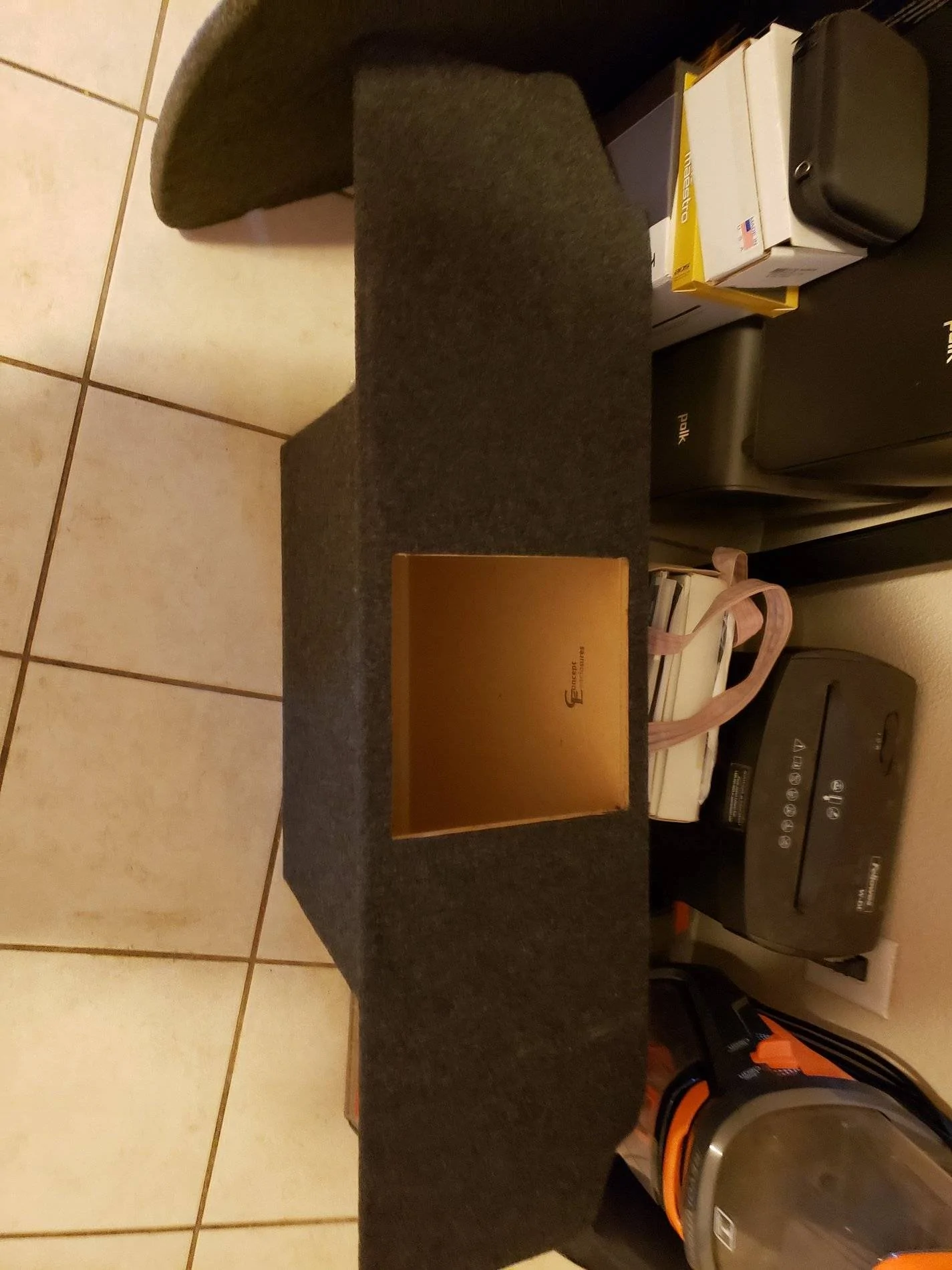

Here is the Ebay box. Built quality. I'm going with a Kicker L7, but he will cut either speaker specs. Also they make a ported box as well

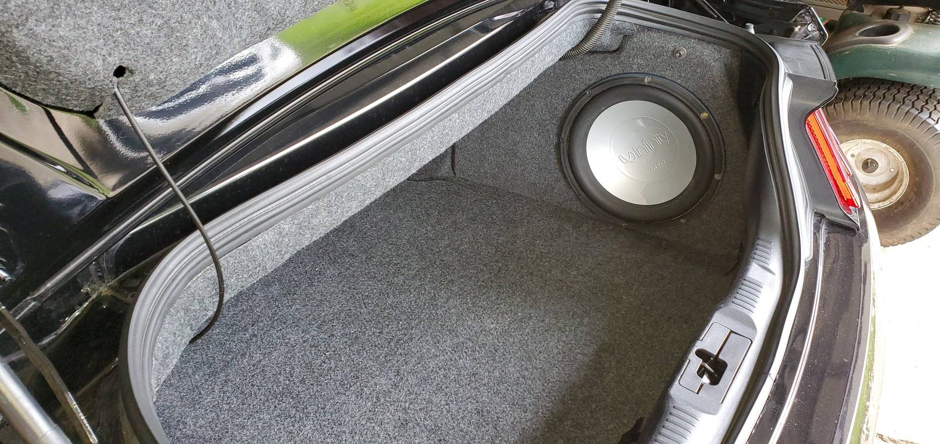

I got tired of trying to find one, so I designed and built my own. I designed it in CAD to be cheap and easy (insert "your mama" joke here) to build with simple tools and no fiberglass. I was thinking about doing a build thread if there is enough interest for me to take the time.

Unfortunately I lost the CAD model, but I still have a full size print, so I could recreate it. Unfortunately there are no dimensions on it. That said, I really haven't had the time. It sounds great and it is very solid with no parallel sides so there are no standing waves. I wouldn't build them, but if it was worth my time to recreate them, I'd sell the plans.
