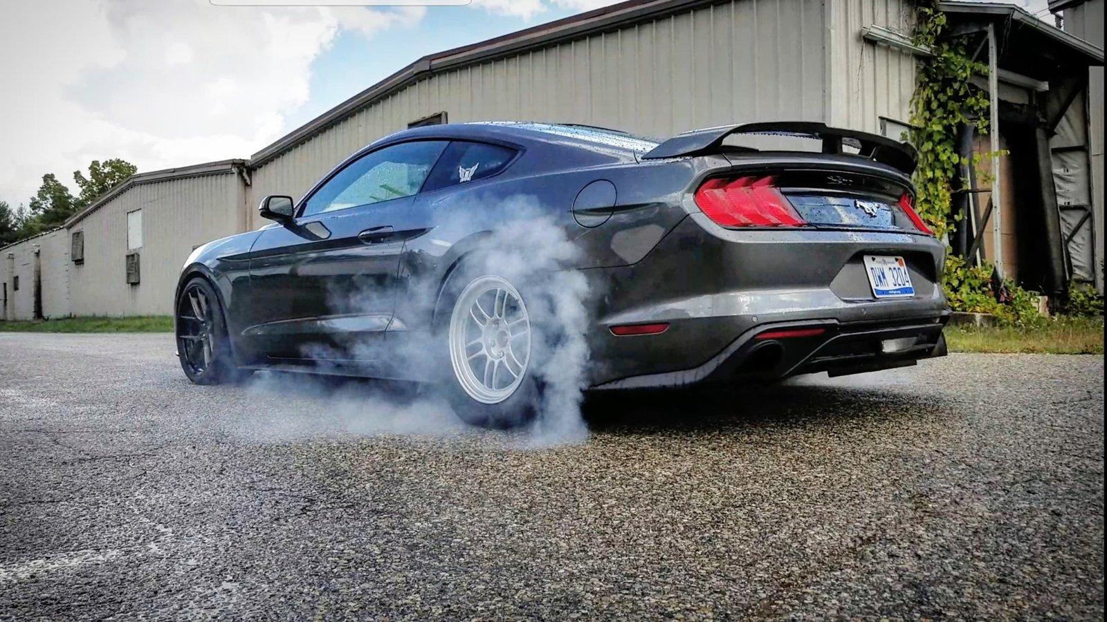

Really excited to get this thing on the dyno and start playing with the bigger turbo setup. Ran out of wastegate duty with the Borg Warner cranked all the way tight. 24psi and falls to 23 by 5k. Ignite e85 is in the tank currently. Converting everything over to COBB tomorrow. Turbosmart gate is on the way and going to get the boost to ramp in and keep torque nice and flat around 400.
Mods: EFR 7670 W/ full-race inconel adapter
Custom catchcan mount using vibrant dual port vented can, full-race block vent
Radium aux rail
WSRD adapters to use modded Evo x injectors
WSRD 3in intake
Relocated expansiom tank
Link g4+ monsoon to control aux injectors, and soon to control the 4 port boost control.
WSRD 3in downpipe with tomei titanium catback retrofitted(orginally for a wrx)
