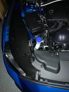

A friend in my local club took this pic he traded in his 16 for a 21. This is what the 15-17 covers look like on the 18 and up's radiator cover. The supports sit more inboard on the 18-21

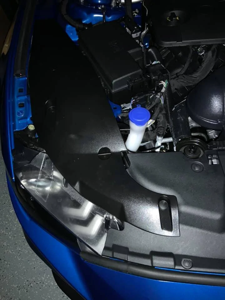

Here it is in place where it should sit on an 18 and up. does require some drilling for the hood stops.

So these are the 2017 ones on the 2019?
yes a new hole needs to be drilled for the hood stops. all american muscle/mmd need to do is alter a pre existing part not recreate it. I have no idea why they dont have these out for the 18-21's
