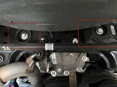

Check the rearward differential bushing mounts.

Thanks, I'll take a look. It really sounds like it's coming from inside. Did you have this problem?
I don't, but many have. When the bushing breaks, the bolt/sleeve now contacts the subframe and can make rattling or vibrational noises. Just something to check.
I'll check it out, but I looked at this online and that sounds like a deeper "clunk" tone. Mine is a higher pitched rattle.

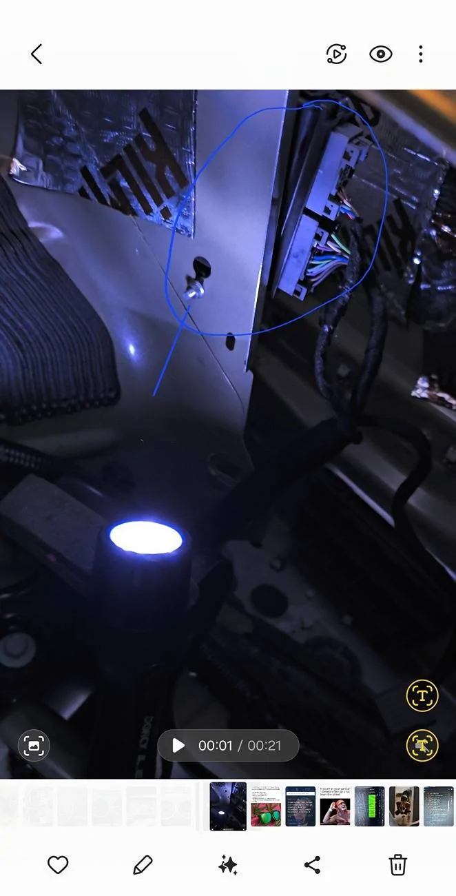

I know that exact sound and recently added an entire box of Kilmat to help eliminate it.
The two of the most common culprits are the rear passenger airbag mount as well as the black box in the passenger rear side trunk. I unscrewed the box in trunk, taped piece of foam padding on it, and retightened it. Sound 90% gone after doing that.
My sound was repeatable at around 2,250 to 2,600 rpm in any gear. It sounded like a mechanical buzzing/tapping sound.
stang17
Jun 5, 2016
669
307
Wilkes Barre, PA
2017 GT Premium PP
This is the black box I'm referring to. It was loose and resonating against the metal that is is bolted to. I wedged a piece of foam in between the box and metal before retightening it.
Helped get rid of most of the sound where I can only hear it if radio is off and I'm trying to hear it.
Yes, I added a piece of steel to strengthen that floppy box. Did not change anything. I've been thinking about adding sound deadening material, but I know that won't fix it, just cover it up some, like you're reporting. The sound is loud and crisp, sometimes metal on metal, sometimes like metal on glass. As for the airbag mount, I really thought that was the culprit, but I removed it entirely and no change. Maddening.
