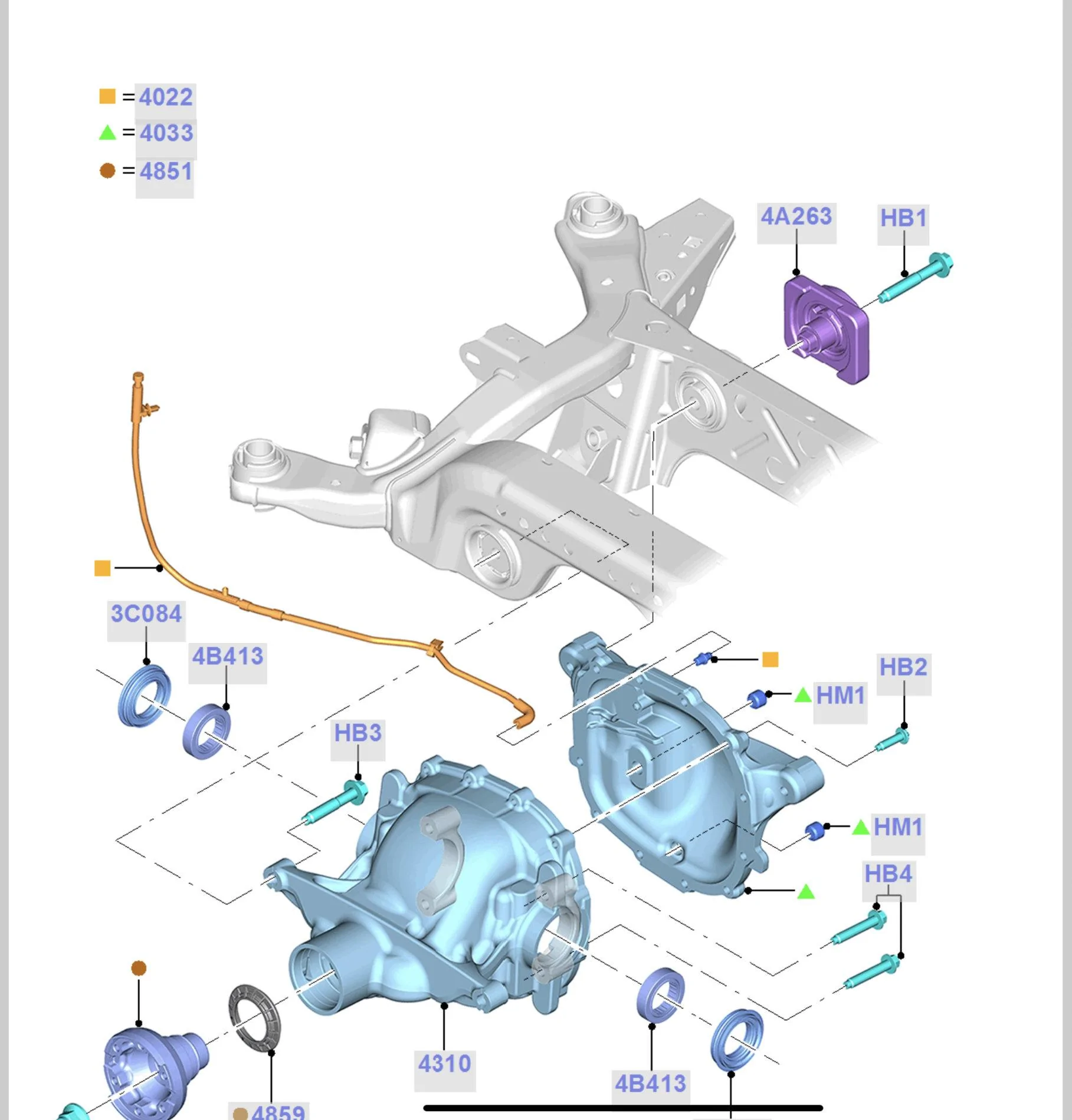

That is the vent line connection that runs to the passenger rear wheel well.

Open is totally fine for your application if your just making a daily driver. Route it in a fashion that is higher than the port location with the ability to run back. It’s just allowing pressure from building within the diff from fluid expansion.

Thanks db252!
This won’t be a daily driver. I’m building a pro-touring setup and will see the occasional track day and strip run. NA Coyote/6r80 at first will a TVS blower following.
Any recommendations for a breather/catch can?
