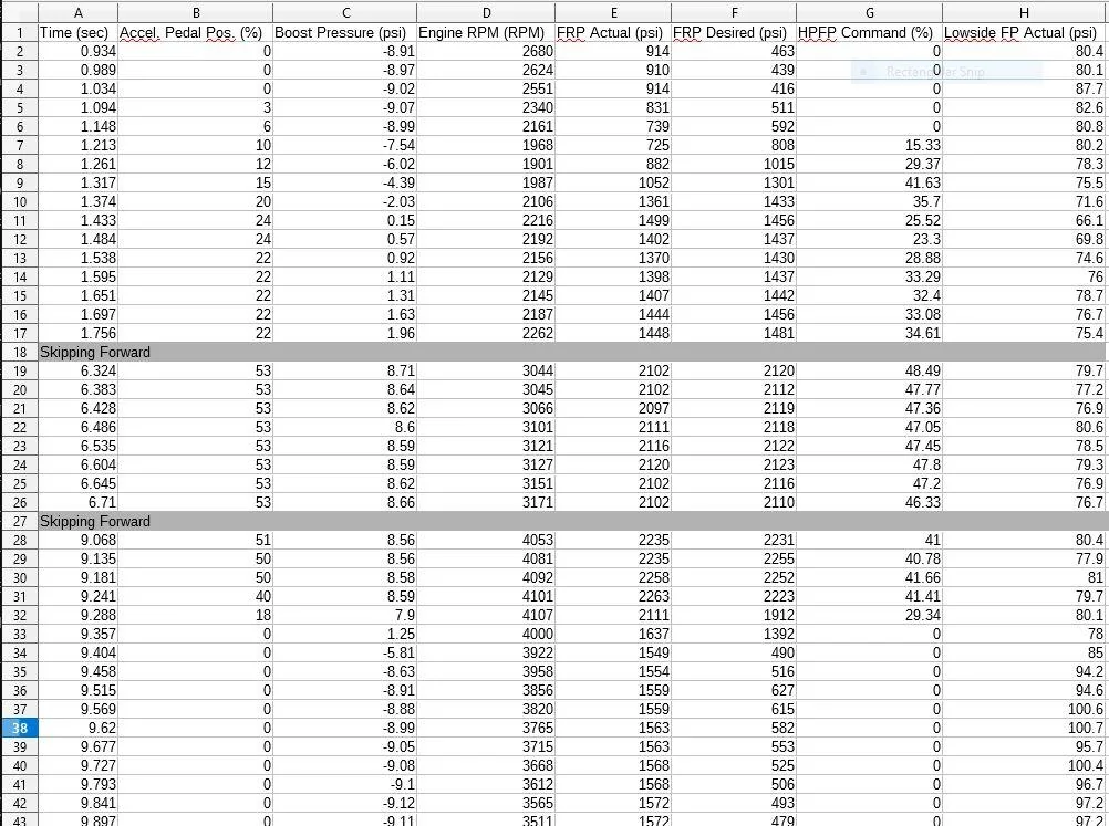

Run the low fuel pressure sensor test with the access port to determine if you have the correct pressures present .

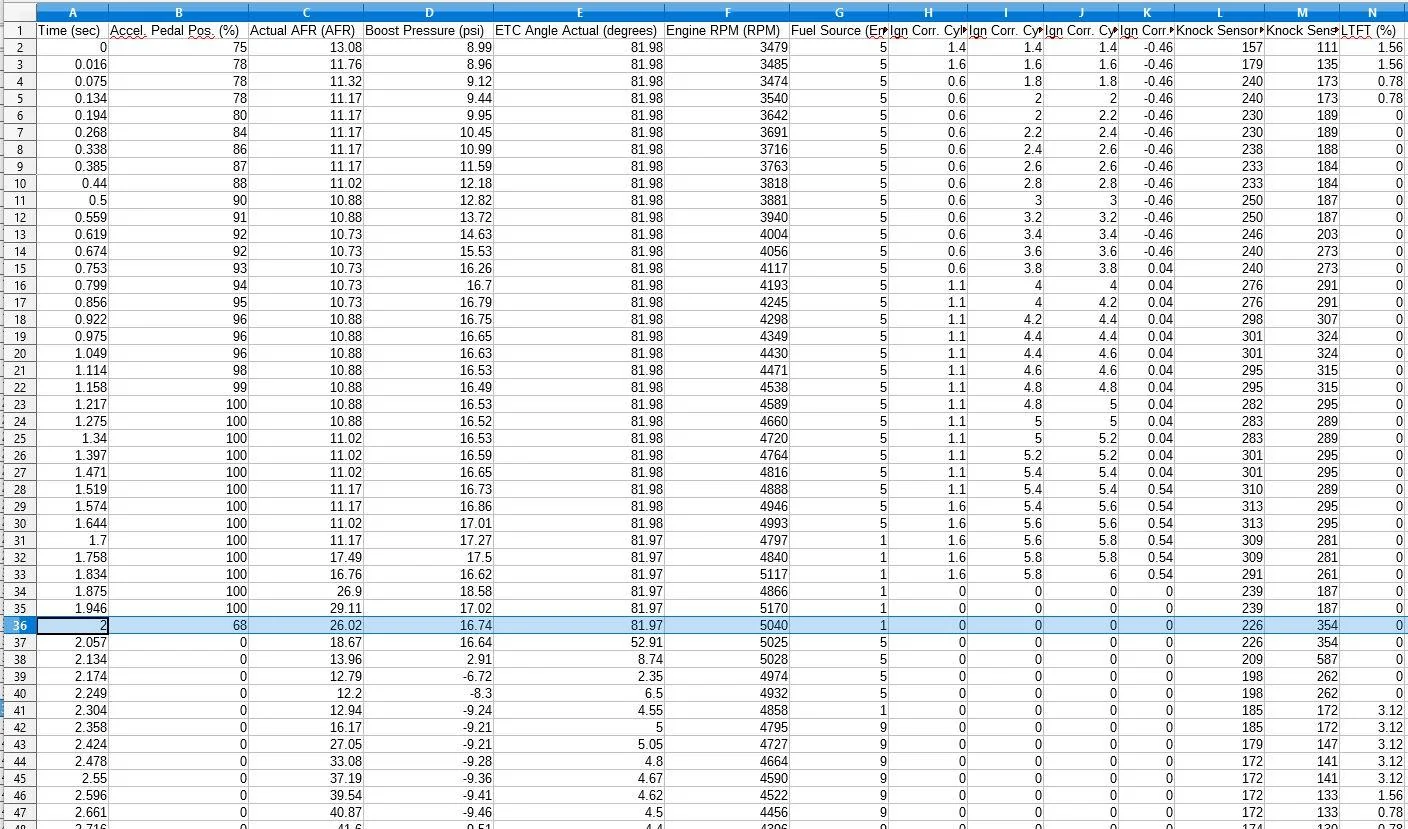

I *think* my low fuel pressure sensor test passes fine. Here's a snip of the datalog
I've uploaded an image of the datalog from the fuel pressure sensor test as well as a super-clean (although maybe not monitoring the right fields) example of when i get this mysterious throttle cut.
You can see I've got the throttle pegged at row 35 (Two Seconds), and then it looks like i just ripped my foot off the pedal, but i can assure you I did not.

Its going lean at row 32
Hi GuardEcoBeast,
Hi GuardEcoBeast, Thanks for the reply!
Is the jump in Actual AFR what you're looking at in 32? I know basically nothing about reading these logs. According to the PDF i found Actual AFR - Wideband front oxygen sensor reading converted from Lambda to AFR... Whatever the heck that means..
What could be causing this? I initially felt like this was a fuel supply issue (or I'm still holding out hope it's a bad gas issue), but the Fuel Pump Monitor % holds steady at 40.4 from row 5 through 37. (if that's what i should be looking at?)
I've attached the log, incase maybe other deleted columns show you something.
I'm very thankful for any help getting my car back to healthy.

Its hard to say what the actual problem is. I am by no means an expert at tuning. If you are having someone tune your vehicle, you need to contact them. There seems to be a fuel supply problem.

I think GuardEcoBoosts's observaction that my AFR jumps from mid 11(supposedly normal under WOT) to 19-22 in my logs is a great thread to pull at. (All my other logs show exactly this trend)

Also you have really high positive ign corrections on cyl 2 and 3, which seems very odd to me, now I am no expert at reading logs and just send them back to my tuner for revisions, but I always look at them to try and learn, and never seen anything over +4 degrees, and usually they all stay fairly in the same range across all 4 cyl. Ive never datalogged a Cobb OTS tune, so not sure what they look like.
I agree that the lean out condition while WOT, is not a good place to be, and would worry me, usually it will lean out like that a second after you let off the pedal.

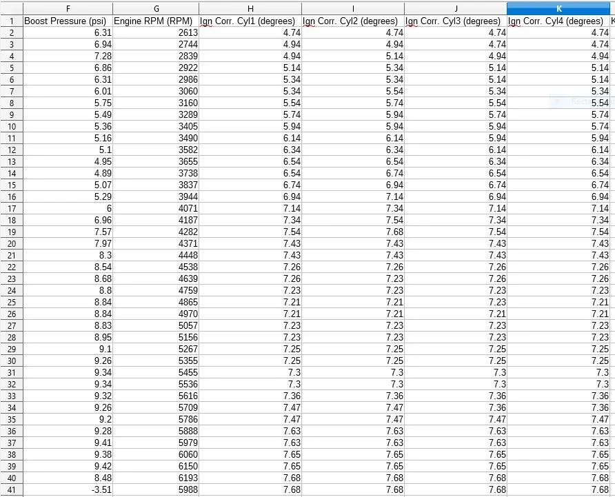

I agree that specifc log shows uneven correction on cylinger 1/4 because they both had a knock count of 1 (not shown in image). but typically all four cylinders look very similar. I consistently see positive corrections up into the 8's. I always thought positive-corrections = happy.
Up until this recent thing, i don't think i've ever seen negative corrections above 2, but in at least one log i can find in an a more aggressive map-slot and WOT i see -3.4(Yeesh!) I'm really hoping between a fresh tank of gas and the new plugs (and the new gap of 0.26, i'll see the end of these troubles). I've got 80 miles 'til fill up, so should be able to report back by this weekend.
Thanks for the suggestion on updated maps/firmware, but both my AccessPoint and maps are fully up-to-date according to Cobb.
Typically when not having this problem, (and not logging even close to the right stuff), my maps look like the attached file.
