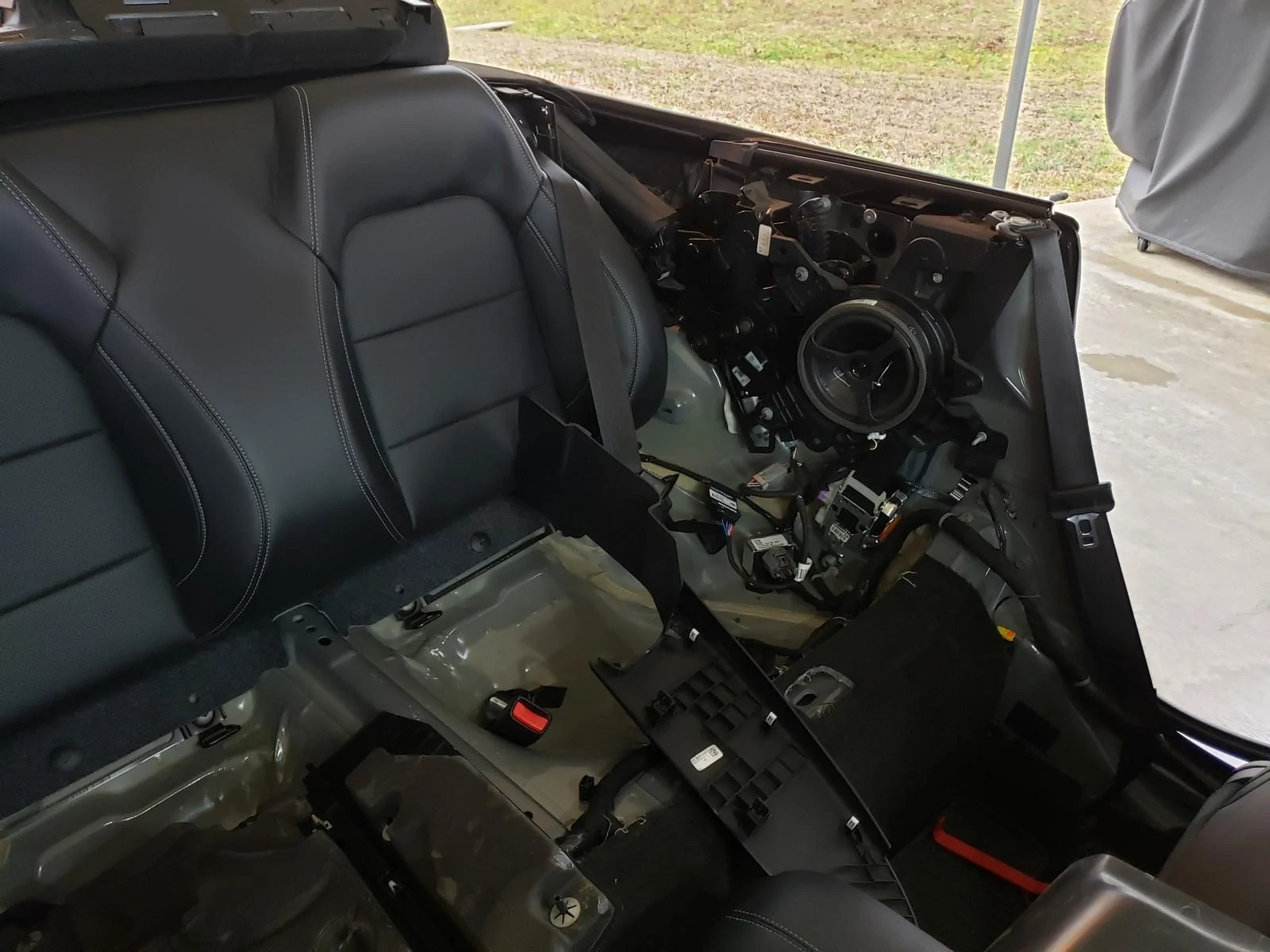

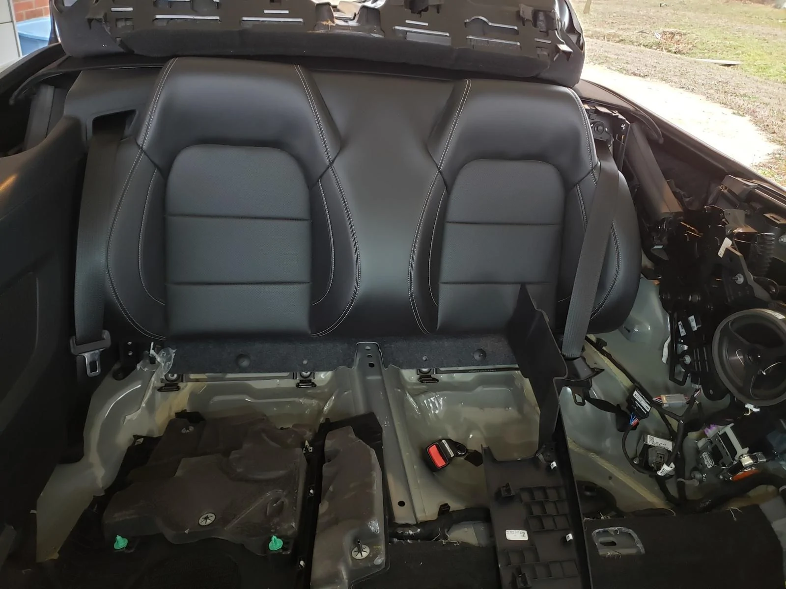

Just installed the smartTop. It was pretty easy to install. I love the one touch operation and the auto set to sport+ mode. I noticed that when I did a remote start that it did not set to sport mode though. It does when starting with the push button.

Thanks for the pics, but where exactly does it mount? and do you have to remove all of the side panel trim to install?
