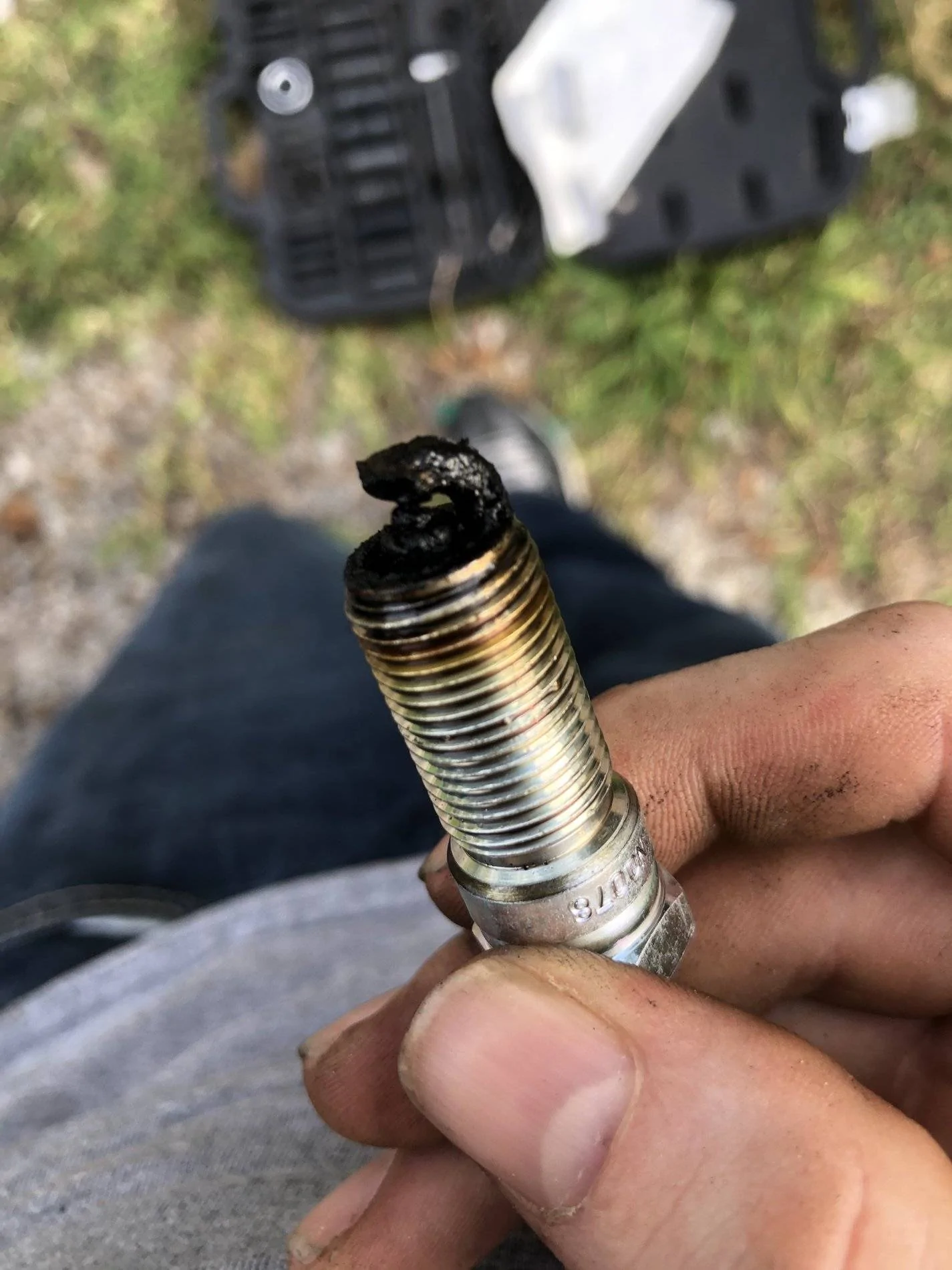

So I bought my 2016 mustang gt from a ford dealership last year after my prior car got flooded, and I’ve been having this issue for a while now. Each time I do a cold start white smoke comes out of the exhaust like in the video. I know it’s not coolant and the car did come with an aftermarket roush cat back on it. I’m debating about taking it to the ford dealership since I have warranty on it.
Car is pretty much factory other than catback and it’s has 54k miles.

If you know it's not coolant based on color or smell, then smoke on startup only is from worn valve guide seals in my experience.

Yeah, looks like oil pooling in one of the cylinders. Next step is to pull all the spark plugs and see if any of them look different/oily.

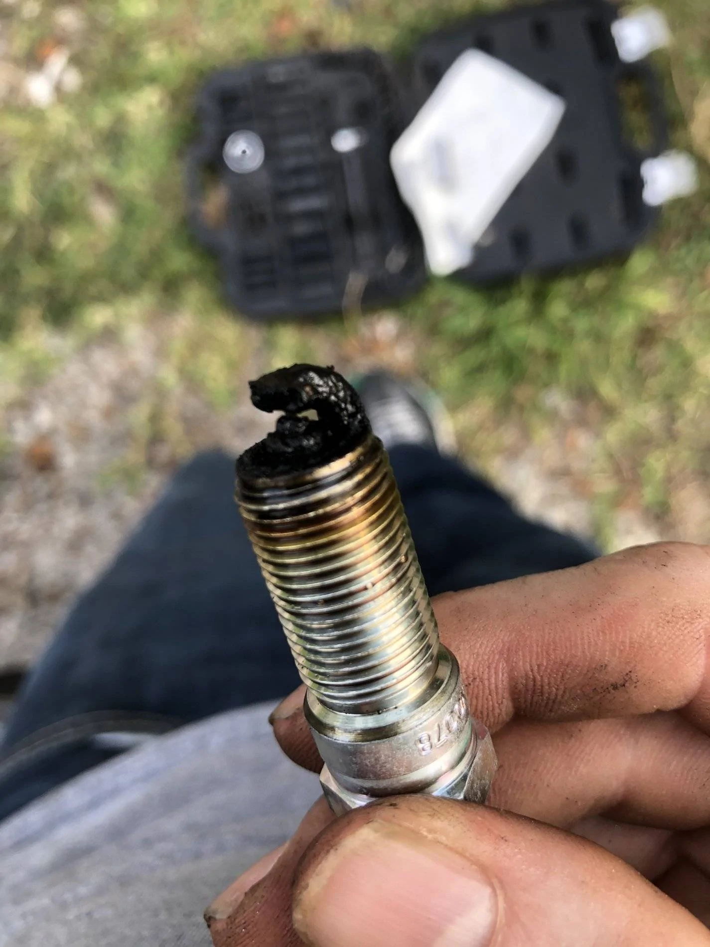

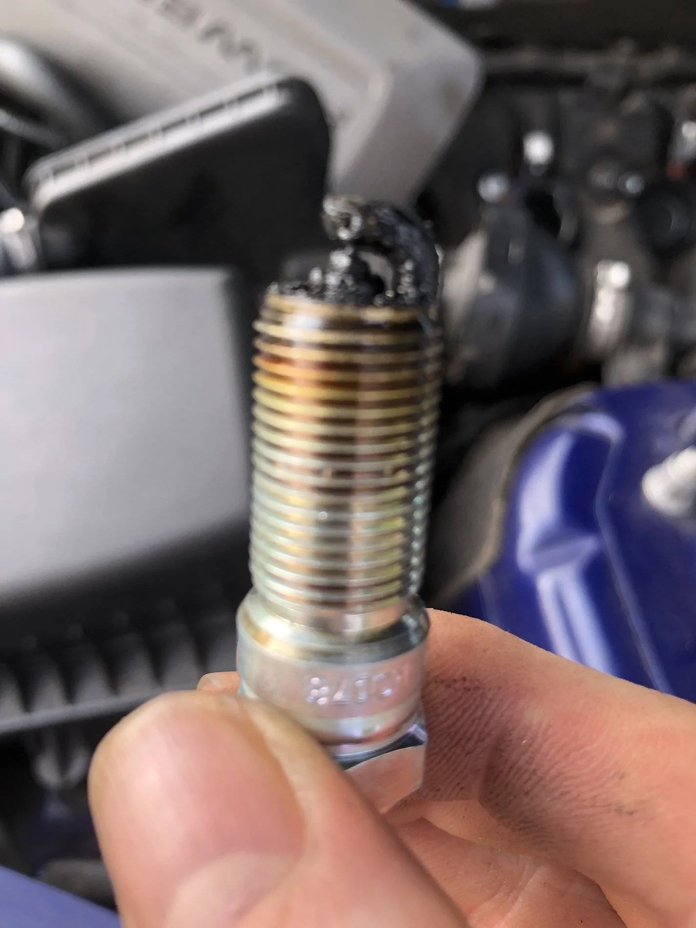

Yea just pulled the second spark plug from the back on the driver side, not good news.

Unfortunate for sure. You'll most likely have to pull that head and have it reconditioned by a trustworthy shop.

Oh yeah, for sure it will be. I'd just put that plug back in as is and give it to them. Show them the video and the picture of what you found.
