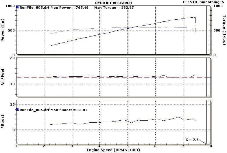

Jason and I are making
And now we are stepping into the "flight control" features and maybe a few more ponies within the cal itself.
This is definitely the way to go without a doubt. Best tune on the market.
