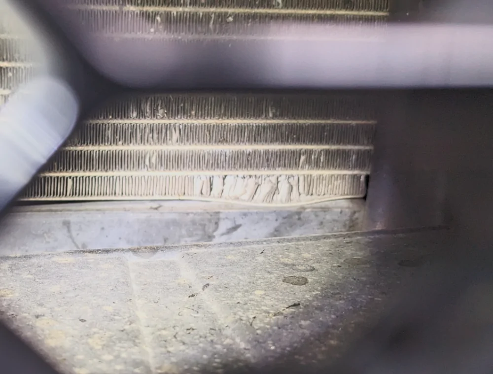

I have no experience in replacing condensers or with these brands. The issue with my condenser is the plastic flap along the bottom is tearing away and I read somewhere that it was important to stop the heat from flowing back. So are the after market condensers better quality and also some of these after market condensers don't have the plastic flap.
This was taken a year ago

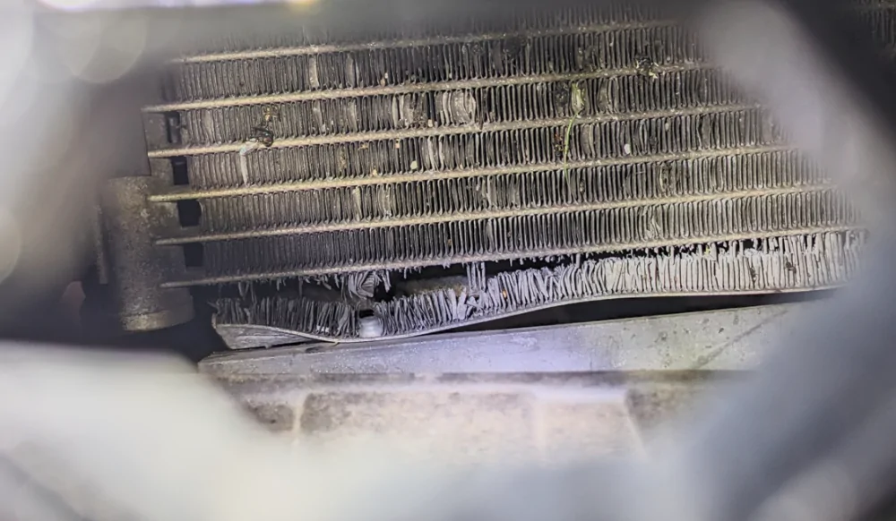

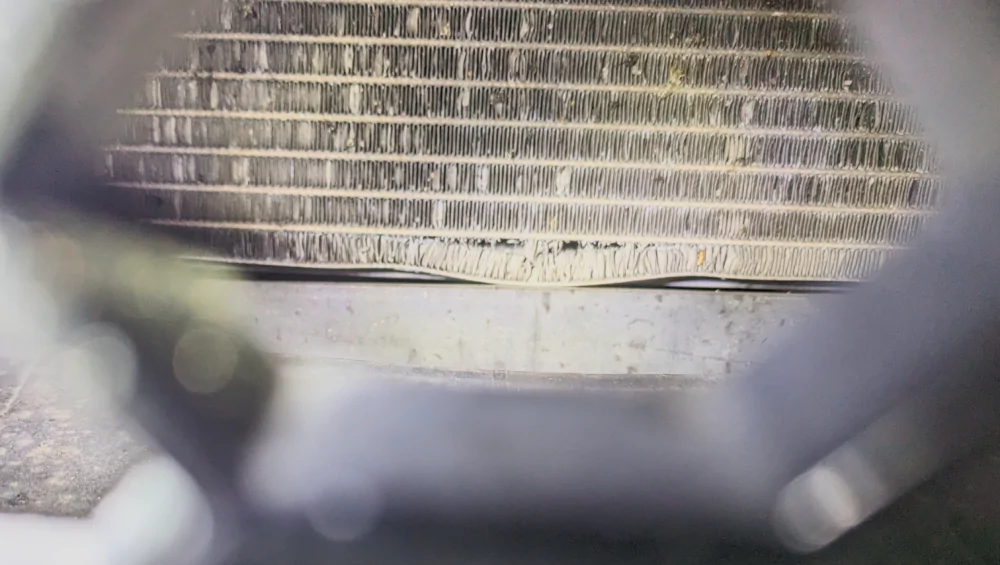

Same issue here, is this a to expect failure?

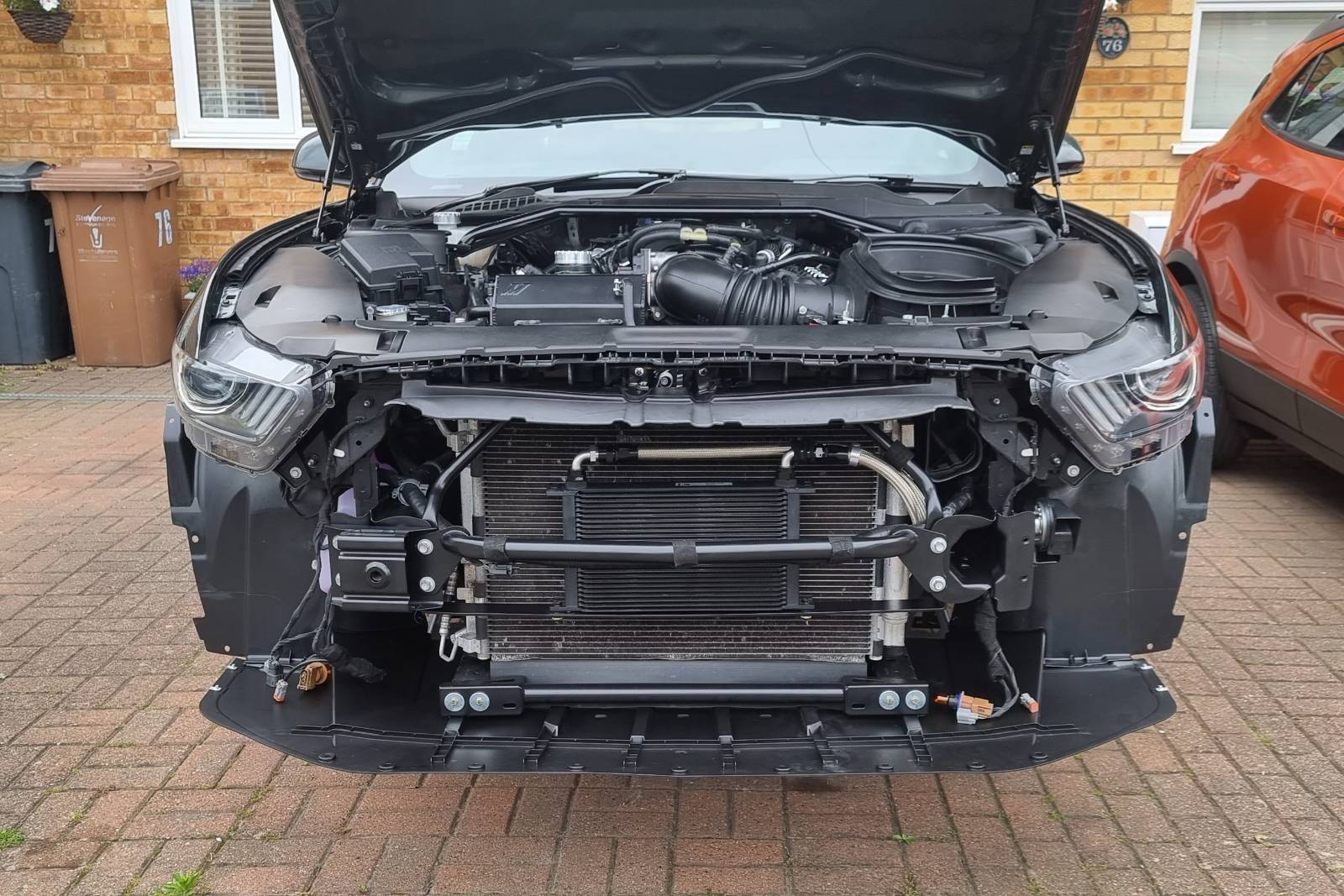

Hi, any further progress on the condenser? The lower flap has fallen off with some crumbling. AC is blowing cold ok so don't know whether to get it replaced and brace myself for cost or leave it till it fails to blow cold air. Not that fussed on cold air but not sure if it will cause more damage down the line. Any help would be appreciated.
