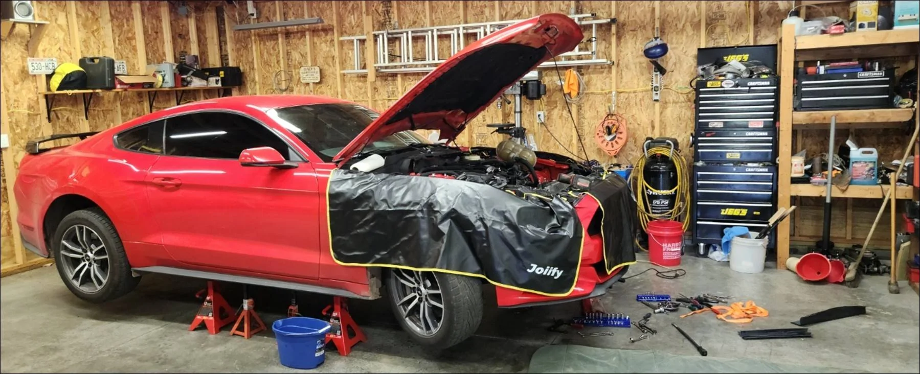

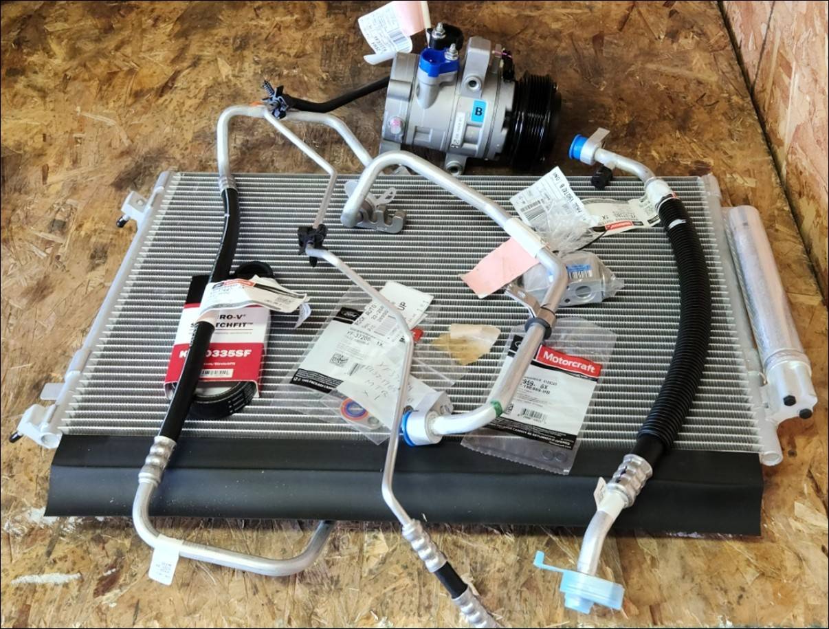

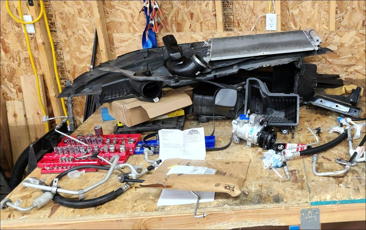

I ended up replacing the compressor, condenser/drier, expansion valve and all four AC lines with OEM parts. Flushing the evaporator was no big deal using my air compressor and the spray can of flush I picked up at Napa.
The hardest step, for me at least, was installing the new line that goes from the condenser to the expansion valve. I swore in at least three different languages getting this back in place. It would have been immeasurably easier if the pictures I took of the engine bay before I started captured the path this lower line takes before I removed it.
The second toughest part was getting the compressor back in place when two of the bolts have to be in the compressor holes before putting it up in place. At least that's what got me. A bit of the handyman's secret weapon (duct tape) to hold the bolts in the holes while I jostled the compressor did the trick. I'm certain not trashing my shoulders playing hockey for the first half of my life may have helped too. Or less gravity.
Regardless, everything was finally back in place and successfully pressure tested and recharged by the same shop that removed the R134 before I started.
And true to form with the rest of my experiences with this GT, during this project I discovered that the passenger side motor mount was loose and the battery heat shield was only being held in place by two instead of the original eight bolts. Both of these issues have been corrected. Now I'm worried about the driver side motor mount and may dig into that soon to verify.
