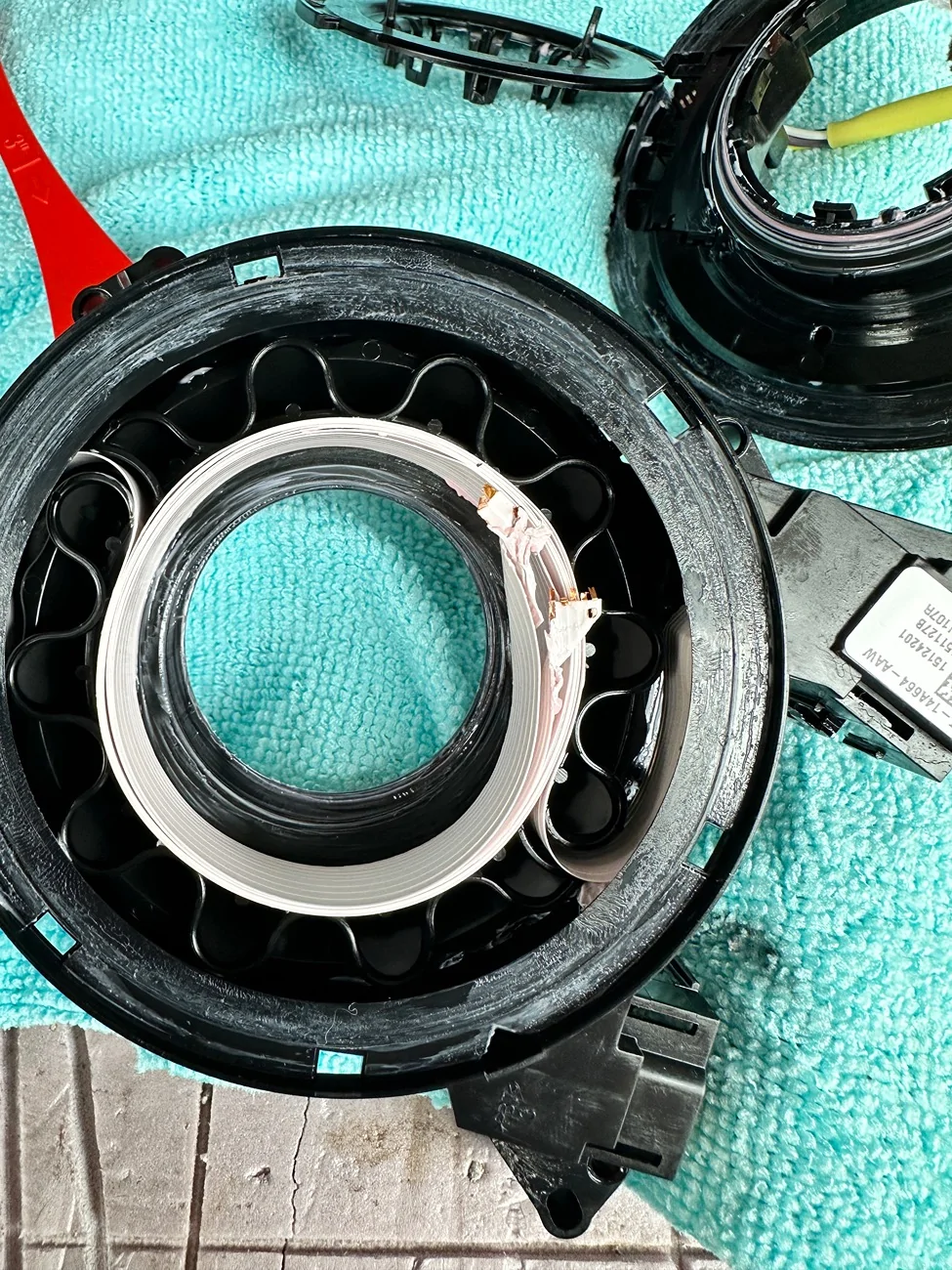

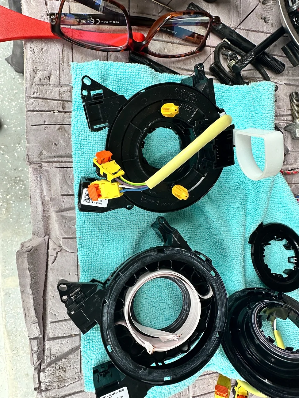

There are the wheel contacts themselves, the bits which make up the button assembly. That could be one point of failure. Another, I'm attaching photos of: the clock spring assembly.
The clock spring assembly is what allows the wiring of the steering wheel to pass through the steering column to the rest of the car, without it getting knotted up when turning the wheel.
The button? It could be that. But it's a simple on/off contact, used once in a while. The assembly, it's in constant use while the vehicle is being driven. It can wear out, the fine wires breaking.
