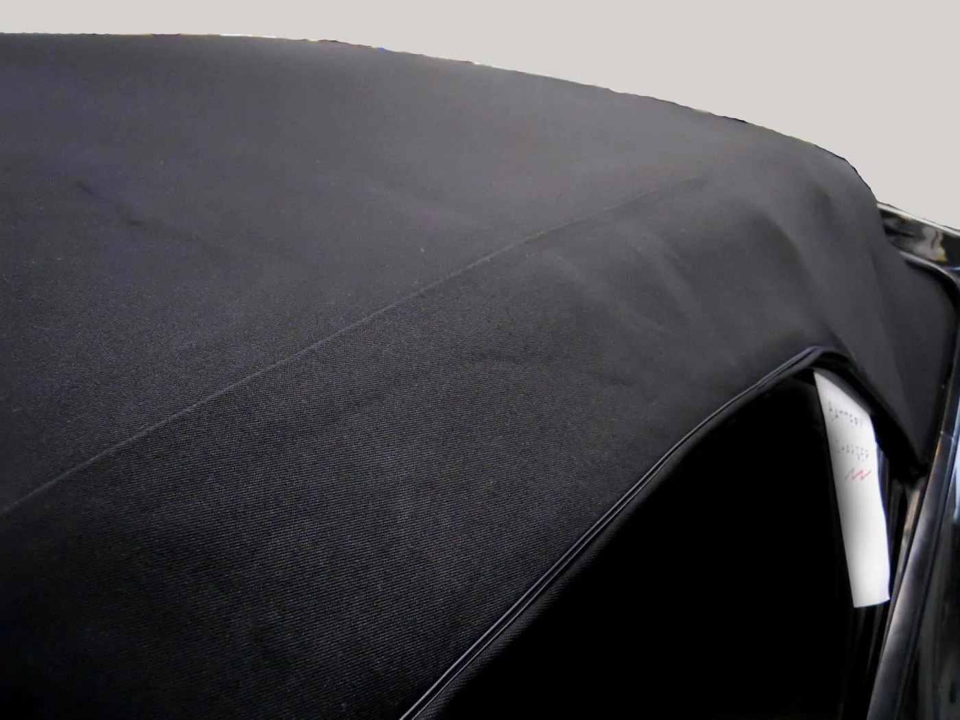

Had to have the top on my 2015 GT replaced due to a small seam tear and the new one from Ford just looks like crap. OE top put on by the dealer but it quickly developed hard wrinkles and stretchmarks above the front seats where the guide tethers are attached. The original top displayed none of this.
Anyone else's original top look like a dirty tee shirt wadded up at the bottom of the laundry basket?

I had my top replaced also and have noticed the stretchmarks above the front seats where the guide tethers are attached. I don't think they are from the install but from the factory.
I added some padding to the second or rear cross brace the one that is in the rear in the down position. I noticed the steel was not rounded enough and biting into the material in the down position. This was causing the top material to deform.

OP - I don't think it looks that bad, but I would be upset as well. Not sure the dealer will redo it but you can try. Good luck!

My experience is similar to WindveilNJ. When the top has been down for a while, it creates some wrinkles around the side rear windows. Not as bad as your picture, and they do go away fairly quickly.
I would complain if it looked like the picture.

Thanks for all your responses.
Just FYI, the top is up all the time when the car is not being used as yet the creases and wrinkles fail to fall out.
The dealership and Ford Customer Service are now in conversation regarding this problem so hopefully it will be resolved soon.
