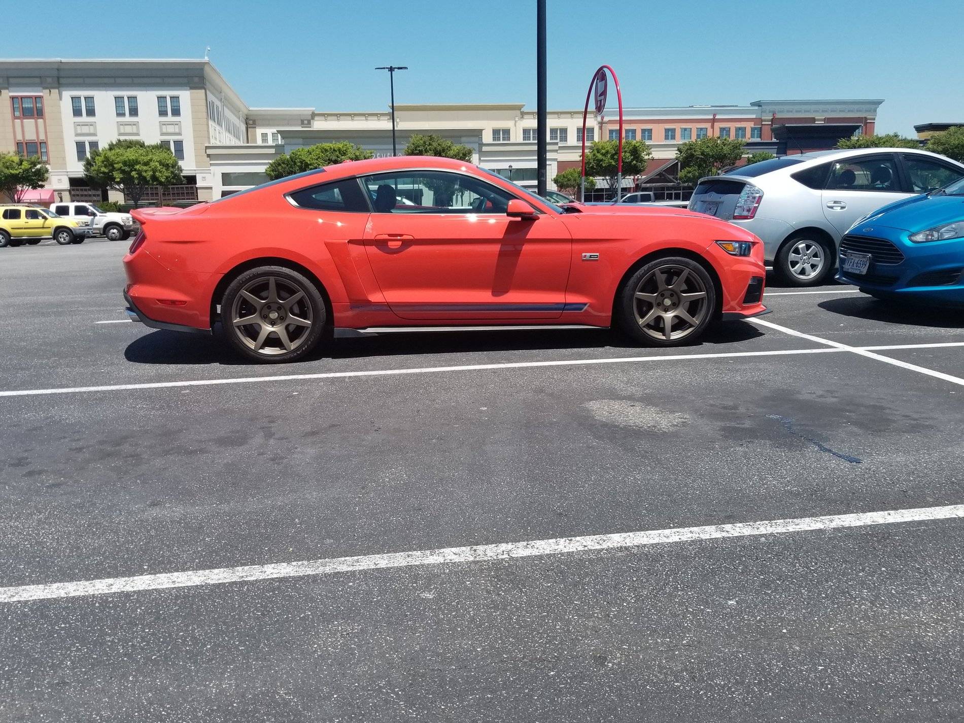

What's the current tire size/sizes? As Stage3 mentioned, there's more to this gap thing than suspension ride height.
Actually, the wheels/tires are rather nicely centered in the wheel wells, and lowering too far would destroy that. 3/4" might be a good maximum amount of lowering. Look for screw threads on the bodies of the struts and shocks.
