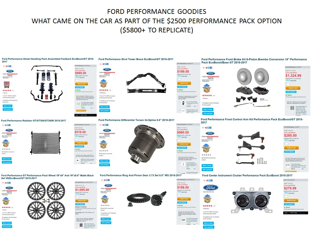

I only see one OEM clutch listed for my Mustang, never heard that the performance packs had a different clutch and it sure wasn't listed on the window sticker.

This is what’s included in my 15 GT PP1, no mention of a different clutch
Not entirely accurate. The FP Street Handling Pack uses different springs than what came on the Performance Package-equipped cars.
But yeah, all the GTs used the same clutch assembly.
