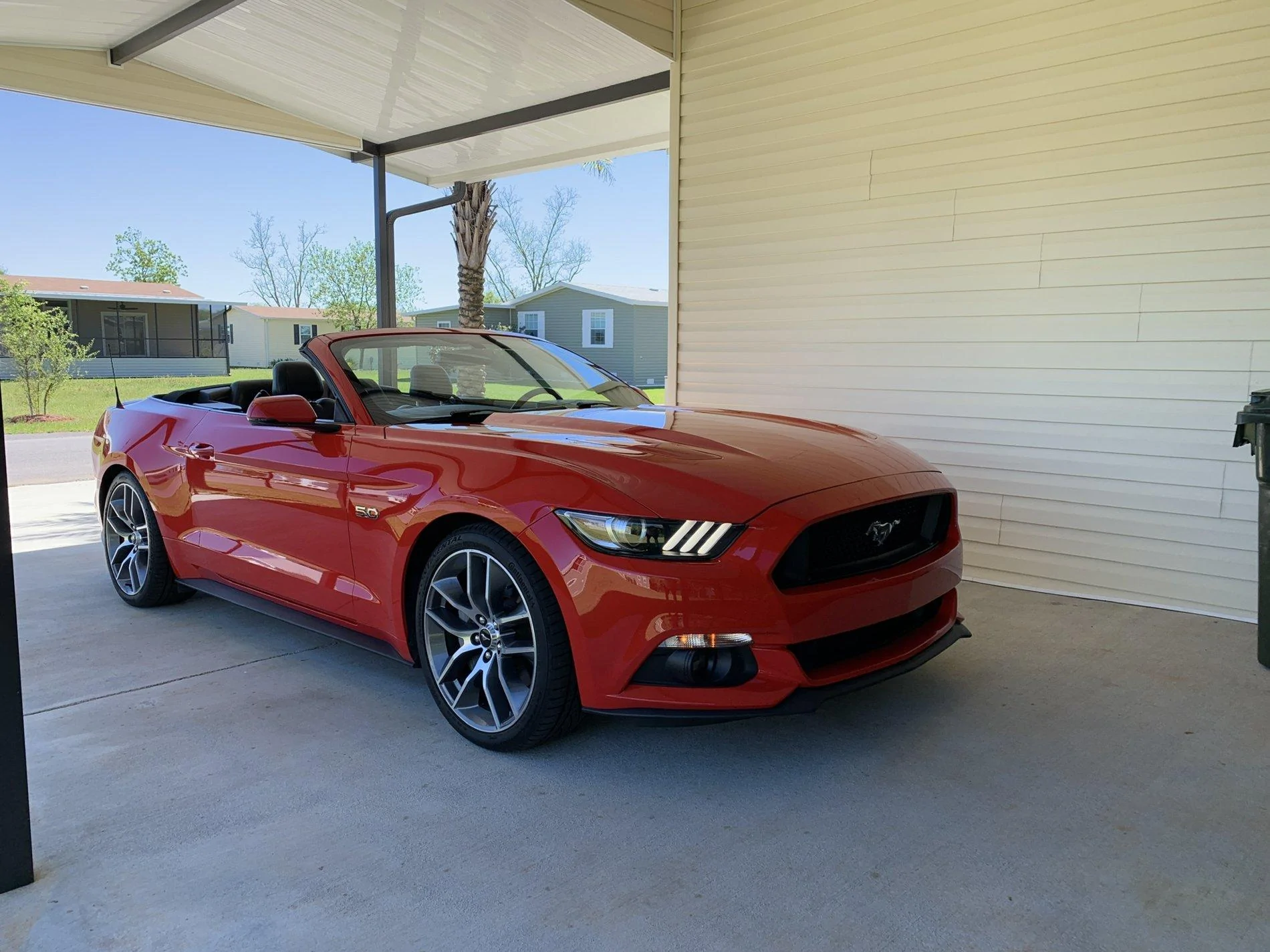

2015 Mustang GT Premium Convertible Race Red
Like most things, “stiff” is a matter of perspective. To us that began driving 50+ years ago, most everything on the road today rides harsh. My ‘15 GT Premium with factory 20” wheels is stiffer than I like but then again, I no longer drive like I did when I was 20 something. I even looked into maybe going with standard 18” wheels but I like the look of the 20” too much to give them up. :)
