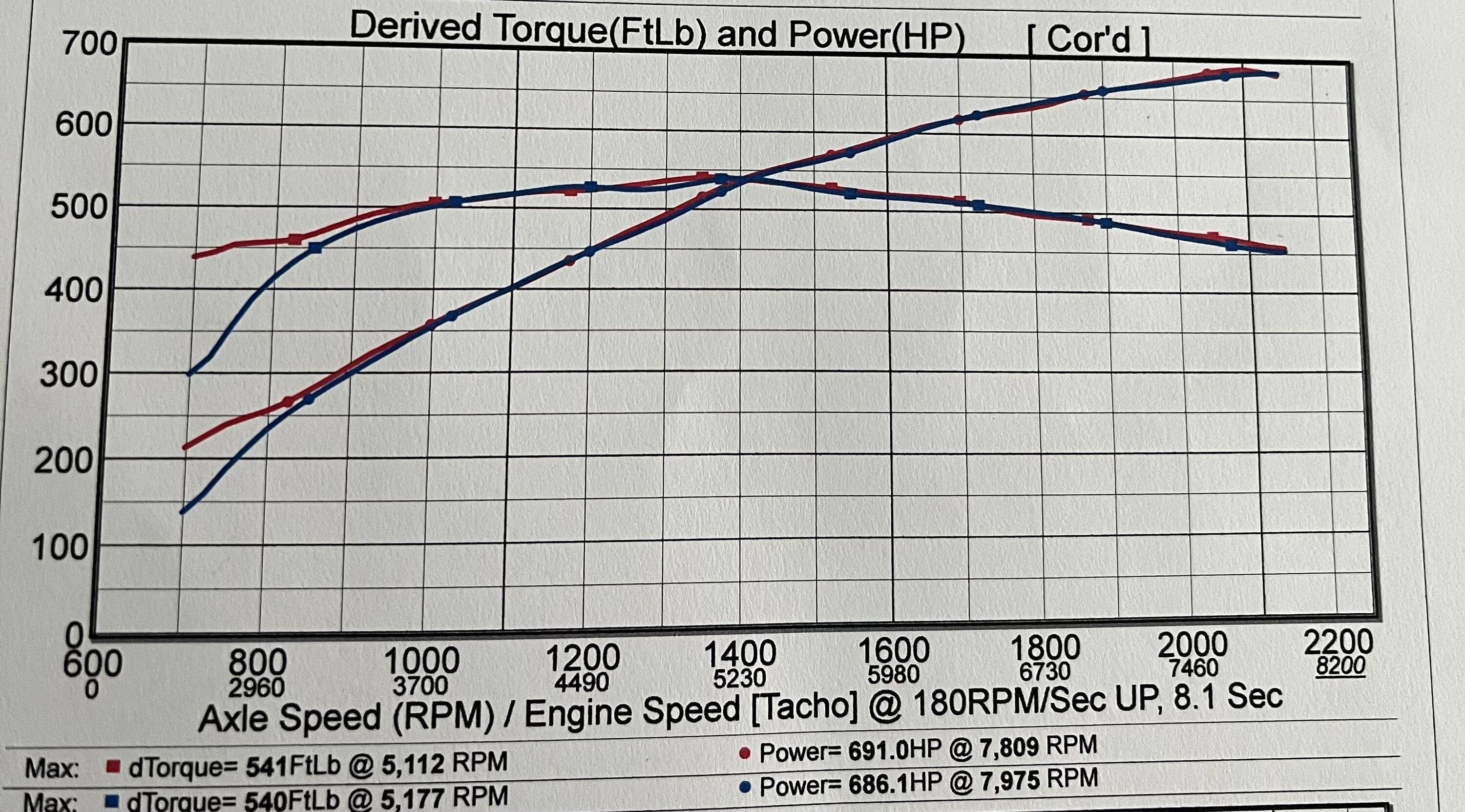

2015 GT Whipple
Car made 691 WHP on a dinosaur gen 2 whipple. 93 octane, kooks long tube headers with green cats. 3.375 pulley. 17.5 degrees of timing. torque seems kinda high though?

Torque looks about average if you ask me. Mt82 or 6r80?

That dinosaur Whipple hasn't even begun trying yet. It will do far more than you'll ever need if you ask it to...

Looks solid. Numbers are always a bit higher on a MT82 car.
