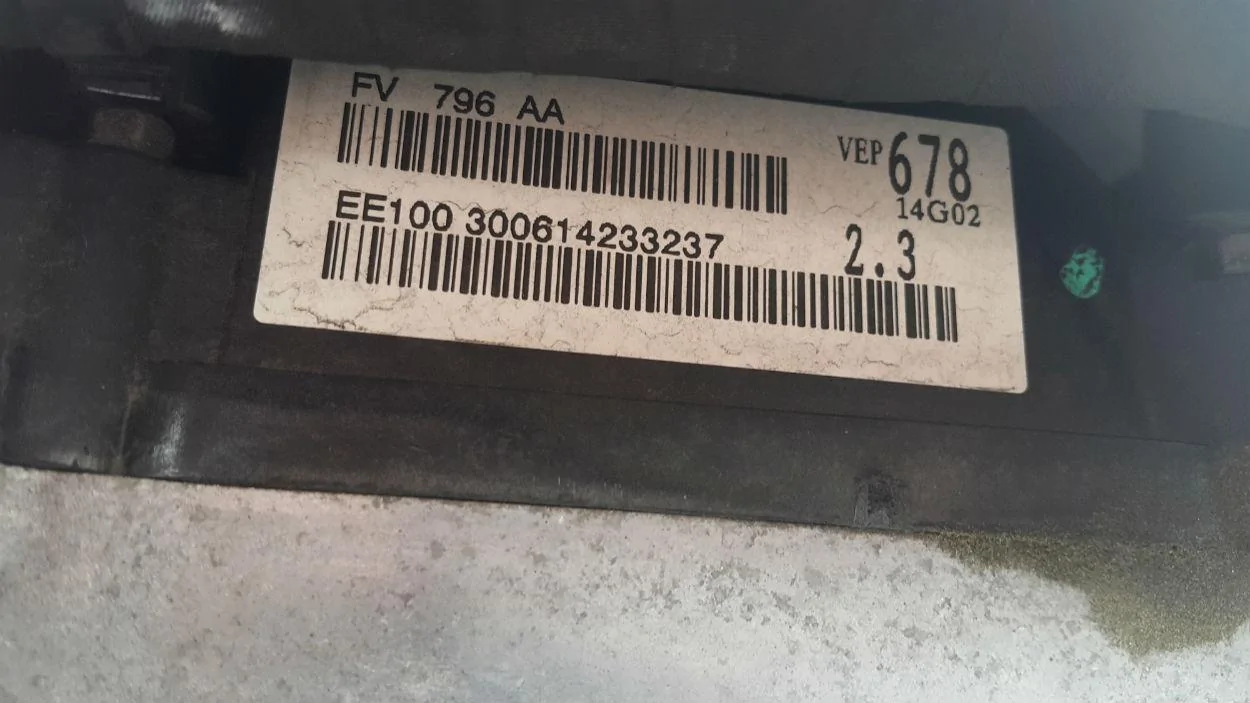

Decal from the front of the UPR Ecoboost engine that has been pushed pretty hard.
See, total BS. You guys do push your car harder than I do, so im corrected. Will be watching you guys at Bowling Green !!!

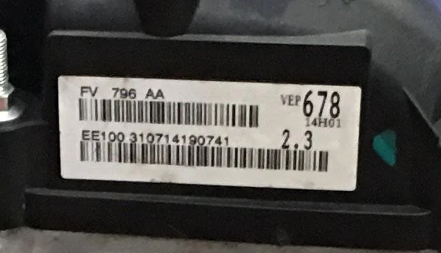

Regarding date code. Look under the large 678 and you will see 14H01
Could 14 be 2014, H equal August, and 01 August 1st?
14K21. = 2014, NOV 21st
14L10 = 2014, Dec 10th.
15A08 = 2015, Jan 08.

just checked - mine says "Cleveland Engine Plant" 15-Mar-2016 EF01A16074121246 GC 794 BA .. is this an "E-Code"?

I've seen that in other countries instead of MMDDYY they use DDMMYY. So right after the EE100 if you go by then the dates make sense on most of the EE100 labels posted on here. Our car was one of the first few Ecoboosts delivered to our local dealership.

My numbers after the EE00 are 014351so I don't think they are the date code numbers

Here's another FV 796 AA, VEP 678 car.
It would appear that those numbers match on PewterCams, UPRs, and mine.
