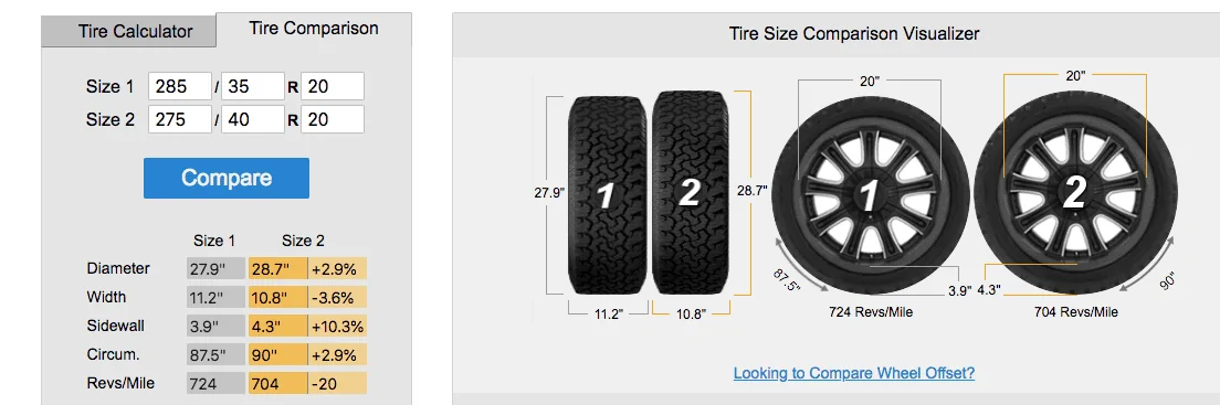

I guess you mean the sidewalls were a little too thick, yeah, the 315/35 is a little taller sidewall, too much sidewall and it starts looking like a truck tire.
The series, the 30/35/40 is a percentage of the width (the 275/285/305) that the widewall is tall, so if you maintain the same sidewall series, like a 35, and go wider, the tire sidewall (and overall height) will also increase.
The 275/40 is a good bit taller than my 285/35:
Above is from a good tool to knock around with - has a neat visualization too:
https://tiresize.com/calculator/

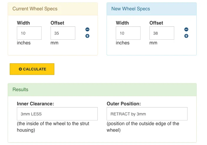

FWIW, me and @1bad66 are both pretty lowered (I'm on BMR SP080s), and we're both on 35 series, I know I haven't had any issues (well, other than very occasionally running out of rear travel, but BMR has a new product to solve that).
I see that you are running 285/35 on 20X10 ET35 and lowered, so I'm thinking with my offset of 38 I should be ok as well? I have everything in my cart and I just want to click purchase now. Lol.
The 285/35 tires will fit fine on both wheels. All other things equal, +38 is less likely to have clearance issues than +42, but I don't know for certain. Both might fit fine without spacers but I just wanted to give you a head up about the possibility.
Thanks for the info. With MaskedRacerX having pretty much the same setup, but with a 35 offset I should be ok with 285/35 on a 20X10 ET38.
Well, it's 3mm less inner clearance, that's just a little but the front is pretty tight in there (I also have Brembos). They should sit really nice, it's just 3mm more inset on the front, and 1mm on the rear (vs. my setup), so it will really tuck in nicely. Are those sold as a "Mustang fitment"?
Yeah, if there was concern over inner suspension contact, a pair of 2-3mm spacers would be cheap, very safe, and basically change it to a 35-36mm offset :)
