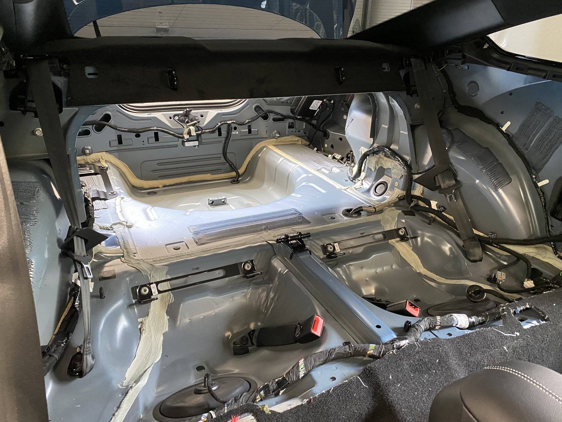

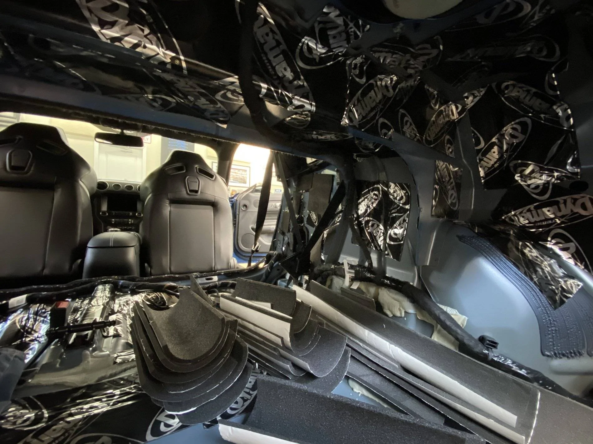

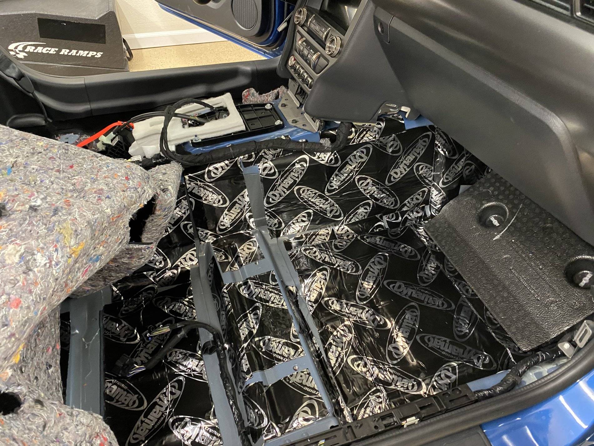

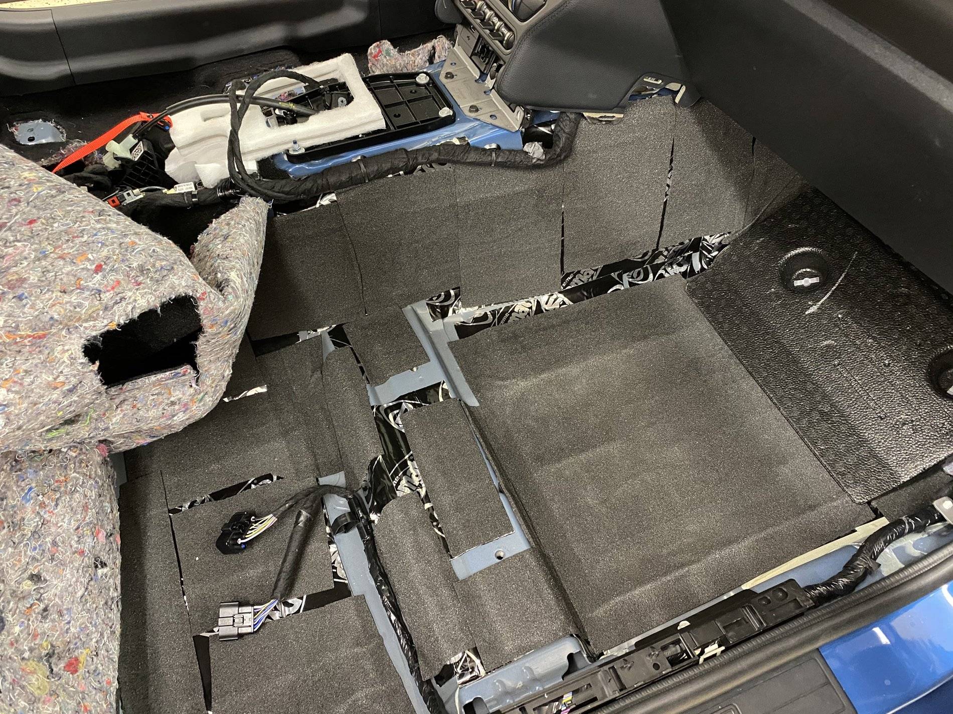

You're your own worst critic--those pictures get the point across perfectly. Wasn't familiar with Dynapad. Got some coin flipping to do now. Thanks!The very first thing I do when I buy any car or truck is soundproof it (roof, doors, floor, firewall, rear quarter panels and trunk area. Applied Dynamat first then Dynapad on top if it. I do it more for the improved audio you get rather than making the car quieter but they kind of go hand and hand. The car also feels more solid when closing the doors, trunk, going over rough roads, etc. It is also a good heat and cold insulator. I did not take many photos while doing it like I normally do. Here are a few. I added about 60# of weight but for me it is well worth it.
