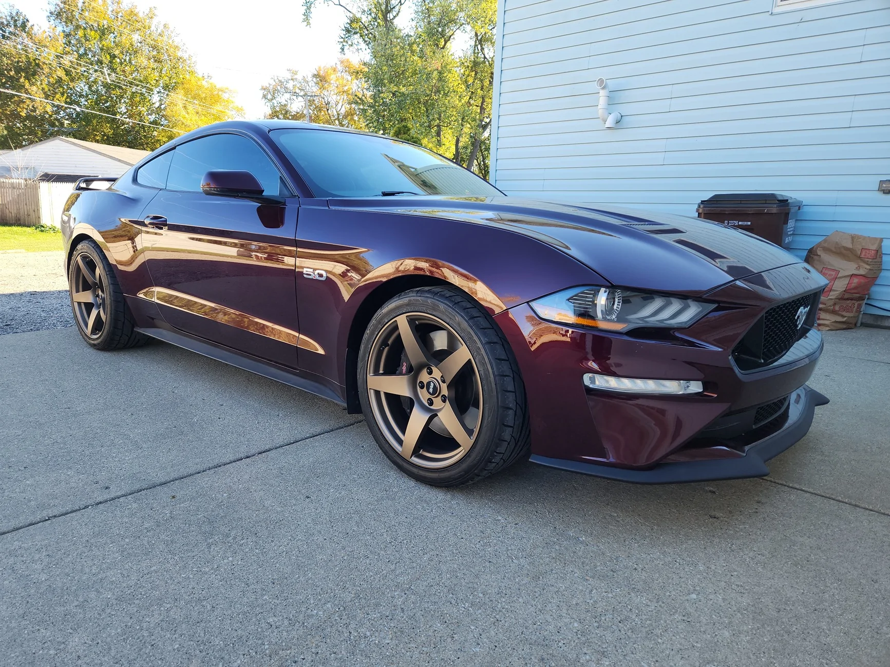

285/35 Front and 305/35 rear. I bought them used from a local guy who bought them from LMR. These are the SVE 355 wheels, but sizing and offset are the same. Nitto 555 G2's.
sweet, this guys selling them for 600 and those sve 350s are like 330$ a piece
