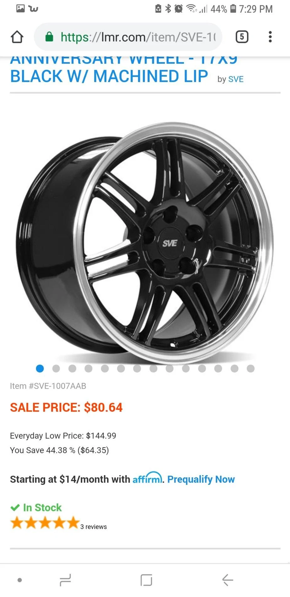

I ordered these, I couldn't pass it up. Most likely gonna pair them with ET street R bias ply.
