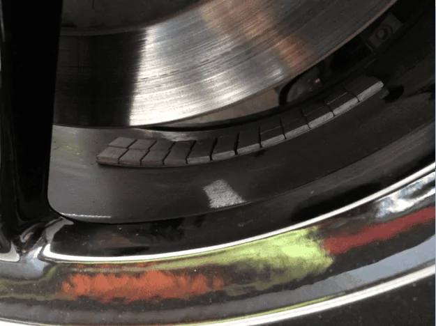

Is it necessary to balance drag radials for track use? The reason I ask is that when I had my radials mounted on my Dark Stars, the tire shop put an assload of stick-on weights on the inside of the rim. About 500 grams on each rim. But with the tires aired-down, do you really need wheel weights to cancel out vibration as the sidewall should absorb it?

Do you really have over a pound in wheel weights? That's a lot, check the rim and see if it's bent or warped...or if the tire is out of round. I can tell you I had a set of race stars that had balancing issues and it wasn't fun to drive on them.

The weights say "25" so I assume that's in grams. There is more of them that you cant see. I actually have some missing as I can see a silhouette of where they once were. The rims and tires were purchased new late last year and have only about 200 miles total so far on them.
I'm going to remove all of them and see how it drives. The tire shop employee that balanced them wasn't exactly a person I would go back to :tsk:.

Thats 0.25 so I see 6 grams total. That's alot
