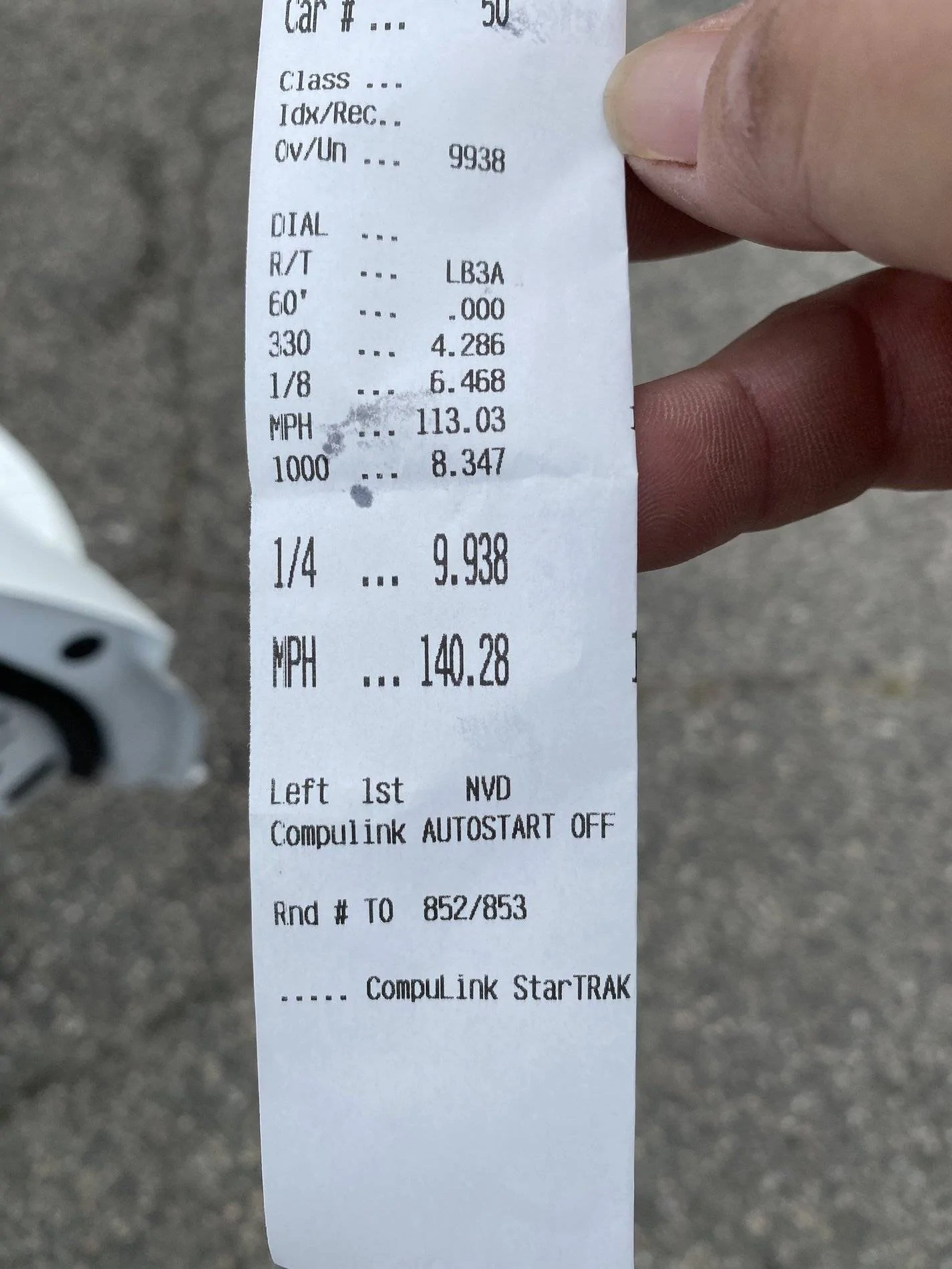

Finally cooled down a little so I carried the car to the track. I ran 3 10.00 passes before finally pulling the passenger seat and rear bottom and knocking off a 9.93@140! Can’t be more happy on how it runs.

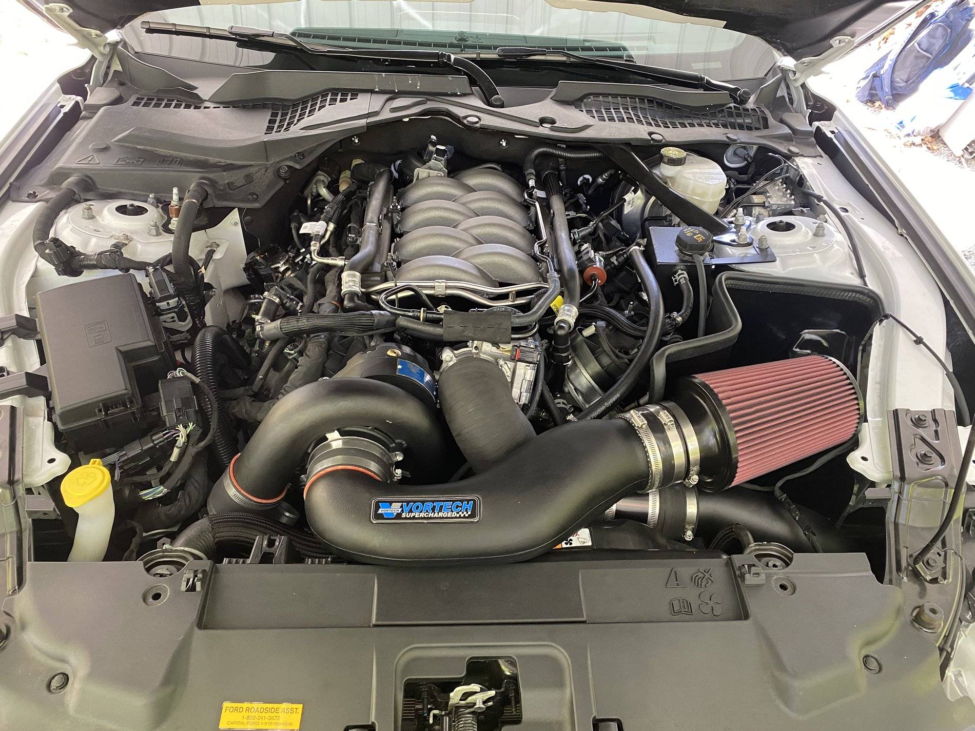

18 GT a10
Vortech V3 3.6 pulley
Lund 93 tune with some additive
Kooks LT catless headers
Brett Barber ported intake
DSS 2000hp axles
DSS aluminum d/s
Next up is putting my Jn2ning dual pump fuel system on the car. I will add clutches and a Circle d converter after that and hope for some mid 9’s

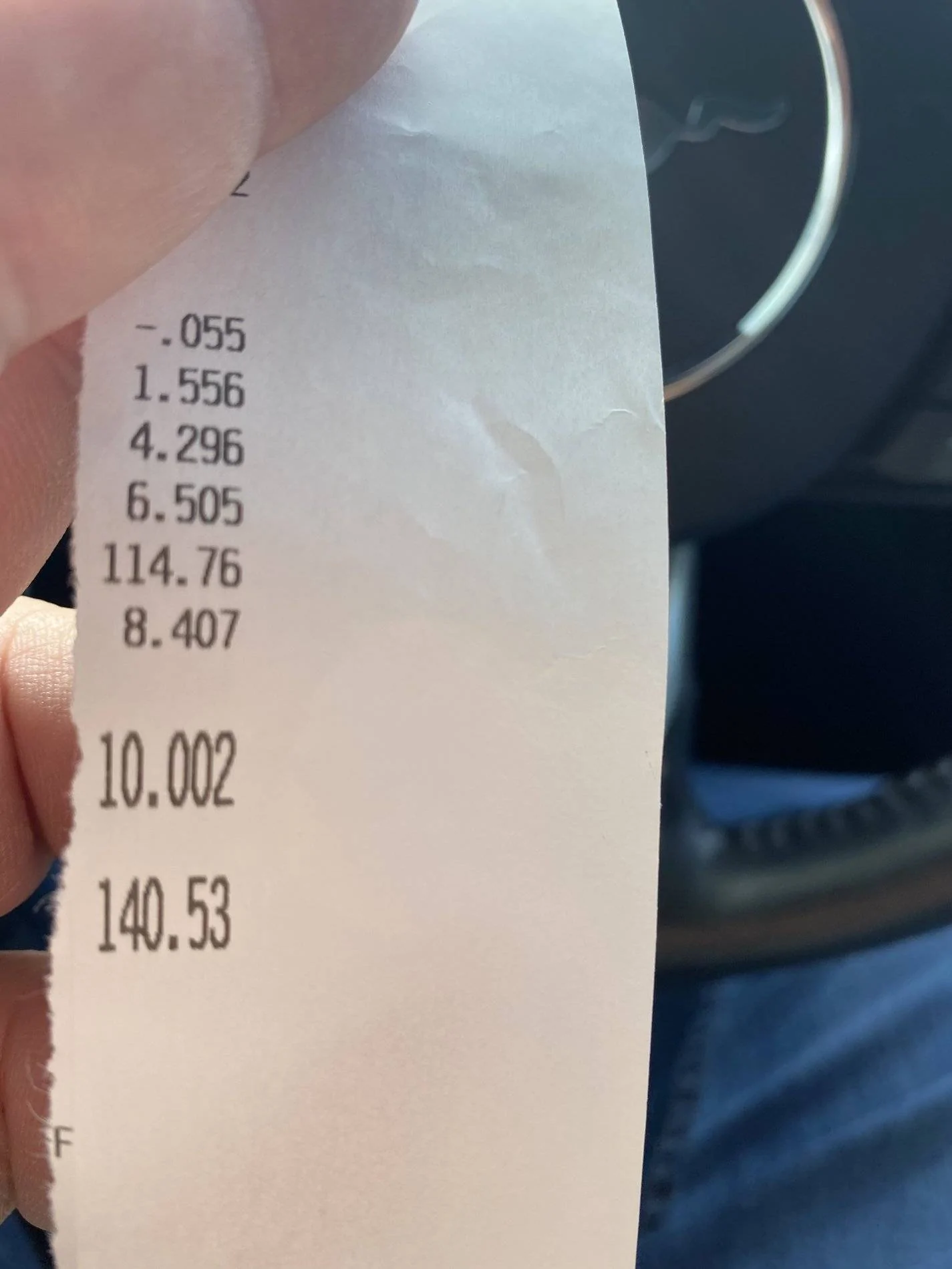

Nice runs.... any 60’ numbers from other time slips?

Best 60’ of the day that showed on a slip was a 1.556 and that was a 10.002@140 pass. I am guessing around the same on the 9.93 pass

Great 60’ time for stock converter..... how are you launching the car?
