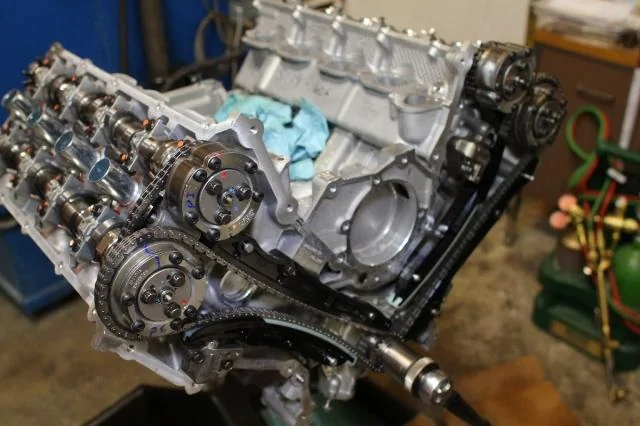

Was updated today. I was told the Bank 2 Timing Chain Tensioner has failed causing the chain to jump two teeth. The advisor stated he really didnt know much and if I wanted the details I would have to talk to the technician. Parts need to be special ordered, dealership will not provide a no charge rental.
I am concerned the chain jumped two teeth, I bought this car as a daily driver with little to no plans for modifications so I have not done much research on the internals. Are these engines interference?

Check the top of the pistons for valve kissing. Request borescope image. If no damage, continue with replacing tensioner/adjuster. Have them check for broken chain guides as chain slap may have occurred.
Check for chain noise on startup once job is completed.
