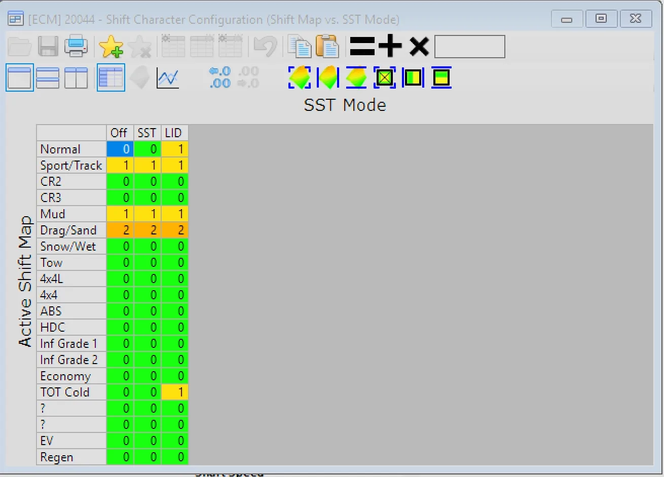

This is the table in HPT that Mike's referring to. Shift character table. There is 0, 1 and 2 for the gen3. They corespond to base, ALT1 and ALT2 shift scenarios. I say scenarios because those three are referenced in many parts of the trans shift configuration. Simply change the shift characters for the different modes does help, but you need to carry all the shift schedules with it include all the tq converter tables for lock, unlock and slip. Plus all the clutch inertial and incoming and offgoing tq values. Everything is tied togther. Its easier said than done and remember we are tip of the ice burg here with what we can actually change. There are 10x as many parameters that arent defined and we wont be able to see or change. This is territory that most tuners stay away from since it can open a sink hole to god knows what. This is from an OEM cal from a 22GT 10R80. OFF is like any other scenario other than SST (select shift manual mode) and LID (leave in drive mode). Mud is track mode and sand is drag. Sport/track is actually just sport/sportS.

@ZXMustang to be clear, the table auF66752 that the thread is about isn't defined in hptuners. It assigns the shift schedules to the drive modes. It does not assign shift characters to drive modes.
