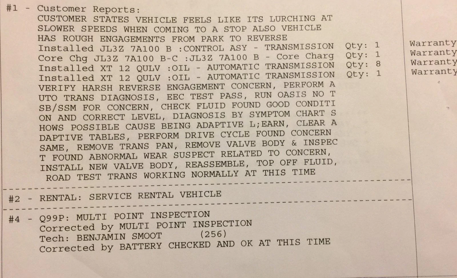

What was the diagnosis or repairs documented on your work order from the initial visit to the Dealer?
Here is an image of the work they did. Don’t know what most of it means though...
Just got an update today and they need the car longer so they can actually remove the entire transmission
So they fixed it, per your work order (working normally), but there are still issues?
well they fixed my initial issues....but a few days after getting it back I started experiencing other issues. I could actually feel, as in "a small jerk" it down shifting as well as the same issue up shifting as well. Car has been in the shop for a week and a half, I was told today they need it until at least next week and that are completely overhauling the transmission and are working with Ford Engineers to make sure they are on the right track....

Ohhhh... hmmm, wonder why they need to overhaul (and exactly what they are overhauling) the 10R80?
The trans is an adaptive learning trans, so even after resetting it from the repair, it may act a little strange until some miles are accrued on it and it relearns the driving strategy.
Definitely keep us updated.
