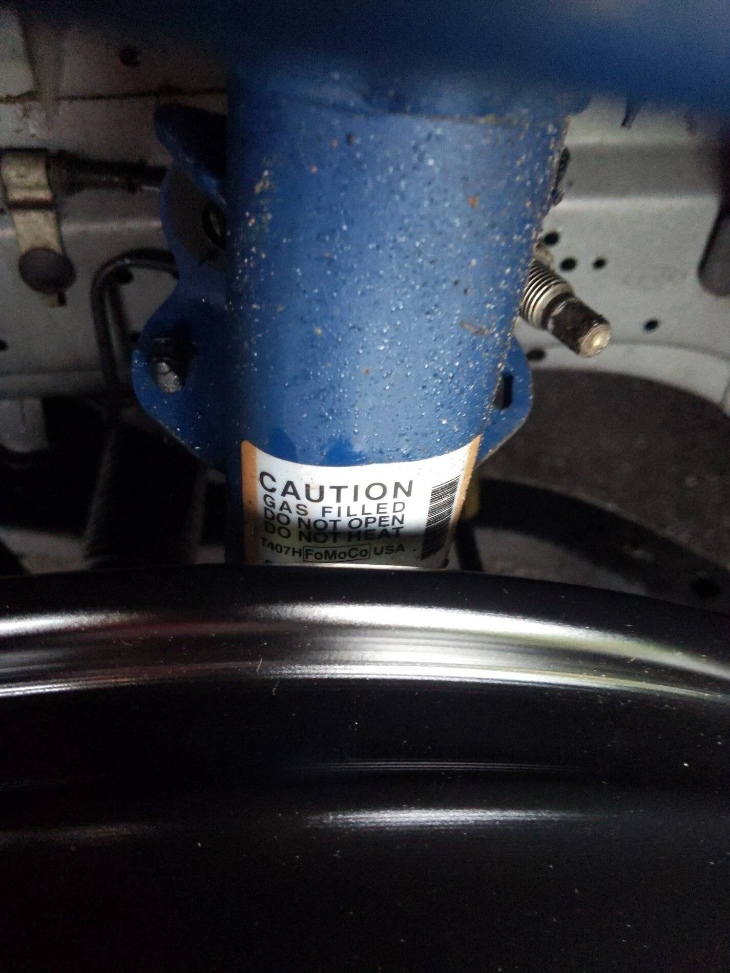

I'm just test fitting a 19*10 et35 now. It's about 10 mm tops, maybe less. I don't think I'd want to get closer.
Edit; I should add that camber plates are on my to-do list, the 350R springs and Steeda control arms with extended ball joints added up to less camber than stock.

10mm at the wheel is a ton of room (wheels don't bend anywhere near that much, and a wheel bearing that would permit that much movement would be causing even worse issues).
Though you are getting a bit more room for tires out toward the maximum recommended size for 10" wide wheels (their sidewalls tend to bulge out past the wheel flanges)..

Check my edit. I updated my comment right as you posted. I have less than a degree of camber.
Got it.
Adjusting camber at the plates won't affect wheel to strut clearance at all. Adjusting camber at the strut to knuckle fasteners does (guessing by about 4 mm per degree for an 18" wheel).

Doh! You are absolutely correct, of course.
