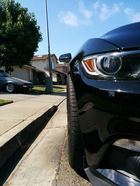

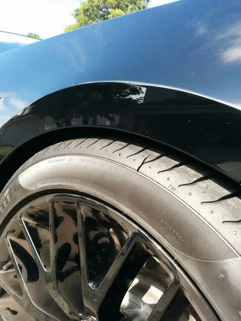

1.5" Spacer Reference
Short story—a month back, I was sent a set of four AM 1" spacers. One pair was correct, the other pair had the same box but different spacers inside. RMA’d and got put on the waiting list for the correct spacers. Still on the waiting list and decided to bite the bullet and try the AM 1.5" or 38mm spacers.
Here’s my setup:
15 GT with Performance pack
Stock PP wheels and tires
CJ pony parts lowering springs. Drop (R)1", (F)1.5".
No camber kit but had an alignment done after spring install.
Rear AM 1" spacer and front AM 1.5" spacer
No problems with rub on full turn. Will rub slightly on big dips going at speed. Only tested on city roads, they are a bit harsh. Going to leave it on and test for a few weeks both highway and city driving. I can probably switch the rear spacers to the front and the fronts to the back if rubbing becomes a problem. The wheel is turned a little bit in the last picture which makes it look wider than it really is. Never was into the stance thing; just wanted to see how much of a physical difference it was and of course for reference. Quite happy with the outcome, either way. Hope this helps.
Before:
After:
rozay
May 20, 2015
42
920
151
South Florida, Broward
2015 PQ 5.0 MT
Those 1.5 inch looks killer in the front. Nice pics
