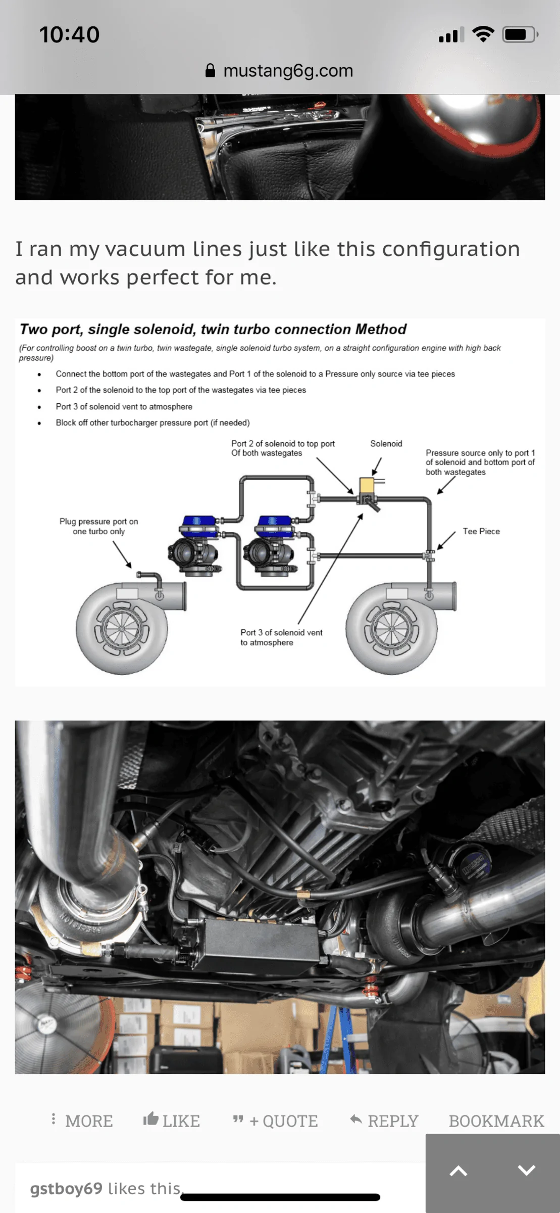

I am new to turbo builds and want to know if one solenoid will work just fine for twin turbo kit?

1 solenoid works just fine. This is the diagram I used.
