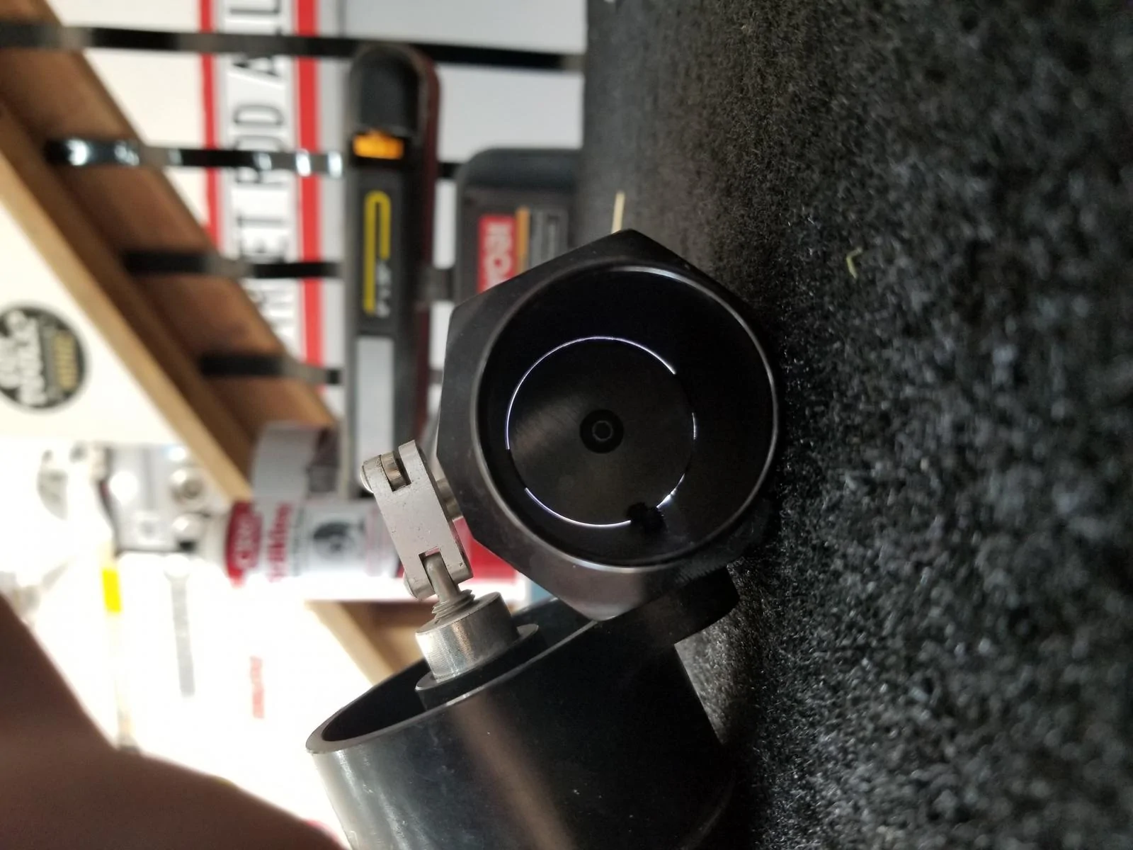

Saw this on another forum and wanted to see what you guys thought. I spoke to someone I know that has worked with prochargers and said they were originally recircs, were never designed to seal fully and it shouldn't leak too much air. Not trying to bash just wondering if you have ever looked into the bov and saw a lot of gap or swapped to an aftermarket and saw slightly higher pressure on logs.

Yea I understand that, I guess what I'm trying to ask is, cam you just bolt on another bov in place of the procharger bpv?
You will have to buy a pre fab pipe with the flange welded ready for install or take the pipe to a fab shop & have them weld up the flange unless you can at home which is what I did to save some coin. Make sure you get the supercharger spring I think it's the 2lb spring.

So all you need is to buy a pipe with flange and connect it exactly the way it is now? Just remove the rubber hose and replace it with the new pipe and bov?

[MENTION=24782]15dib[/MENTION] You will have to get the hot pipe (pipe from the blower into the intercooler) modified,or a new one made up, with a flange for the BOV. There is no pre-made kit. [MENTION=28216]PSI Proformance[/MENTION] fabbed me up a new pipe with the BOV flange and it looked/fit great.
I am running a 50mm Race Port Turbosmart BOV and the sound is awesome, very loud. I have not looked into differences in boost and since I did a WG at the same time it cant really be compared. I can hear the BOV windows up at triple digit speeds if enough air is coming out of it. Revving you can stand 6ft in front of it and still feel the air blowing, Lol.
One thing i do notice is when doing a pull and letting off the gas at high RPMs, the vaccuum is higher now. Not sure if thats only the BOV causing that or the whole setup, but now letting off i see as much as 25-26inHg where before the highest I remember seeing is 24inHg.

That sounds doable, but just to reiterate, you don't need to run a wastegate in combination to the bov? You can run just an aftermarket bob. We're talking about a pc unit.
