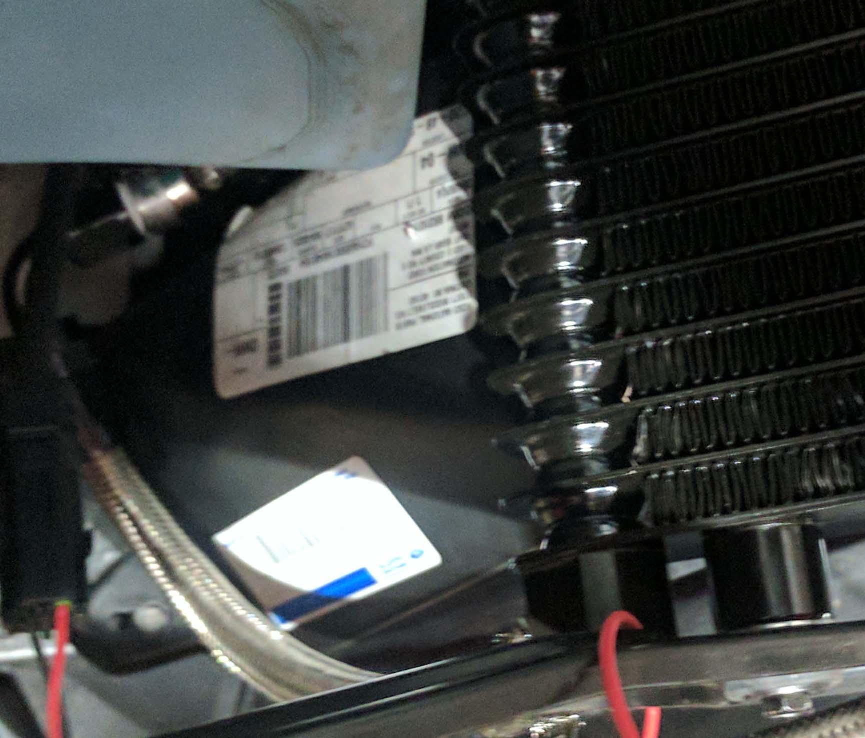

I used the Ford radiator, air duct, and associated bracket because I did not want to have to create custom brackets. Mike R at Autonation Ford White Bear Lake knows the right parts. Do not order the entire Ford cooler kit as you won't use a lot of the parts in it.
I went with the RB Racing pump based on various comments in the "2015-2016 Tech Pack and Base GT350 Cooler Solution Discussion", around pages 159-160. Some of the other pumps I considered seemed to spec a max oil temperature around 150F which the GT350 will exceed on the track. I have a switch inside the fuse box for now, though I plan to put it inside the car in the future. I plan to only turn it on during the hottest days and on the track. It is kind of noisy so I will never forget to turn it off, but I can only slightly hear it inside the car when I am idling. I just tell people I have a hybrid mustang.

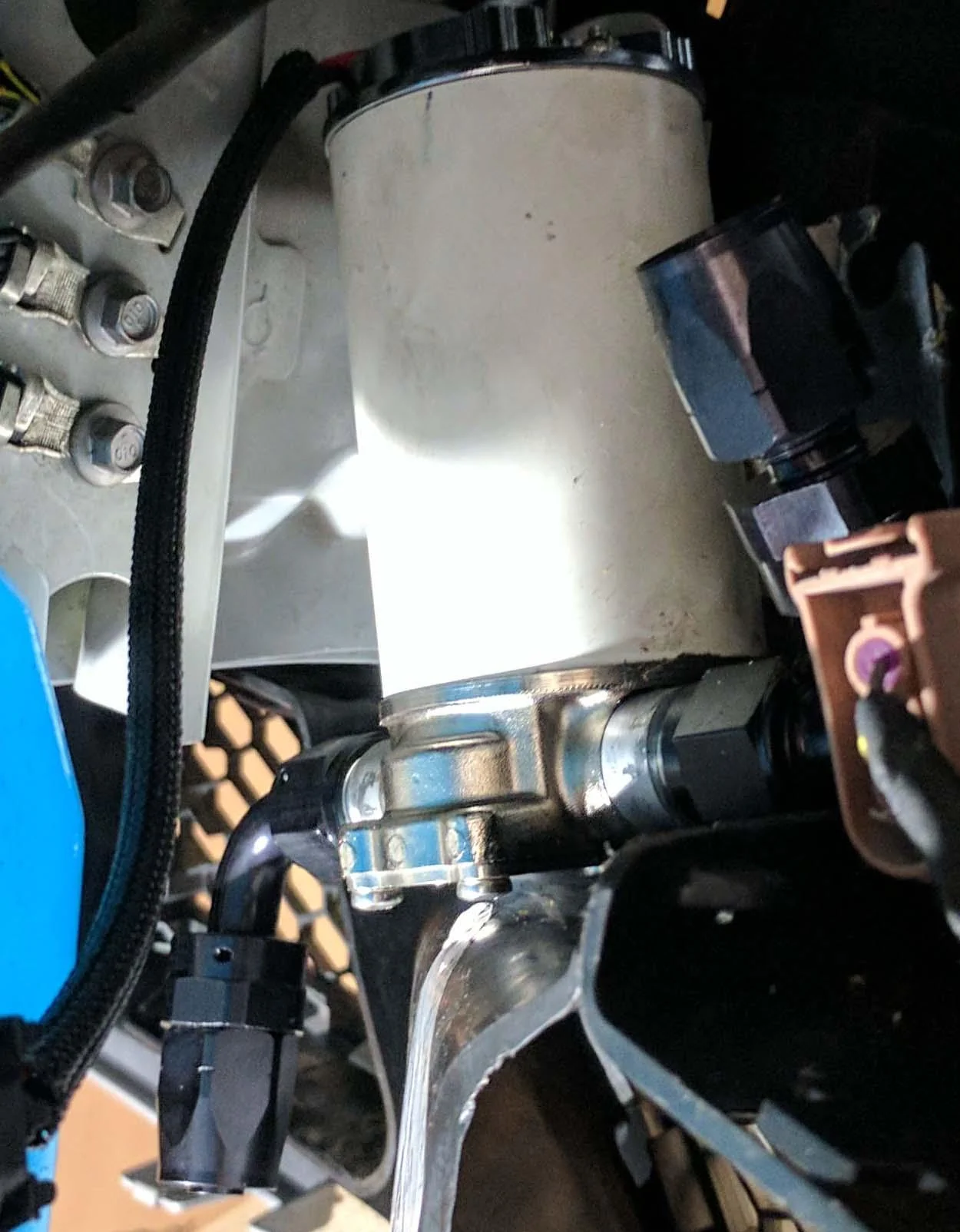

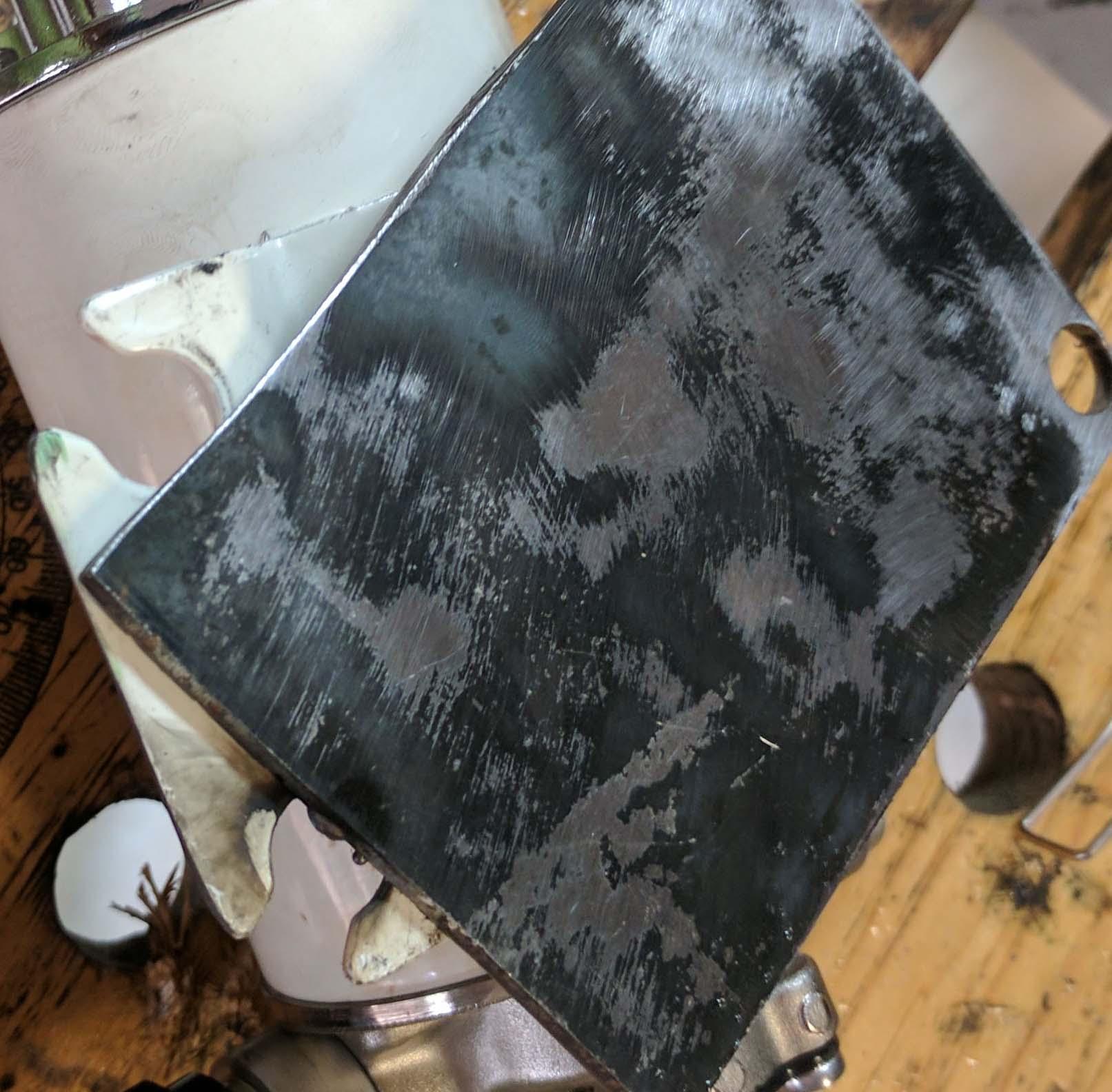

The most challenging part is finding a place to install the pump. We used the same pump location as earlSpilner - there are a couple of bolts that stick out pretty far and I happened to have lock nuts that fit, plus I put on some Loctite We cut a metal plate and punched 2 holes to fit. We originally planned to bolt the pump to the metal plate but then realized the pump had to be angled to clear the radiator air duct. My son knows how to do basic welding, so he just welded it on.
The pump input on the left is pointing down to connect to the output of the radiator. The pump output on the right is pointing up to escape out of the wheel well and connect to the transmission fill. The pump is tilted to the left to fit the 90 degree hose ends. Note that the pump should be vertically oriented, which I mostly achieved. I connected the pump ground to one of the ground connections just to the left of it. The positive wire goes up and over to the fuse box switch. I tapped into the fuse box supply so I can run the pump even when the car is off.
The pump connection to the radiator is very short. The radiator connection to the transmission drain routes directly out. I used Gates 32915 PowerGrip Hose Clamp and a metal clamp to directly attach the AN8 to the Ford radiator. The Gates clamp was too small to get around the lip of the radiator connector so I did the best I could with it. I plan to revisit those connections. I used metal wire to strap down and support the hoses in order to deal with the G forces on the track.

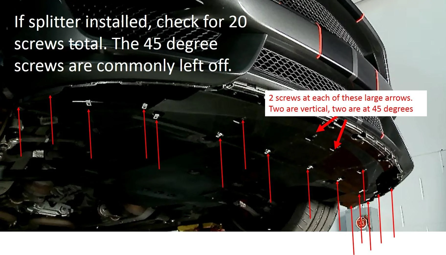

Are you asking about the rivets in the splitter (which do not need to be removed)? There has been some confusion from dealer service as to what needs to be removed to pull the splitter. I believe there are 20 screws total plus the moon clips in the side pieces. There could be more, but that is what I recall.
See attached image for a little detail - I created it for a friend who was picking up a GT350 and wanted to know if the splitter had been put on correctly. I also sent him to the "is your splitter on correct" thread. Sorry for the large image size, I don't know how to reduce it.
If you have actually ground down the screw heads, you may have to drill those out if you can't get a vise grip to grab the head and rotate.

I only had to remove 4 screws and a couple of plastic push pins. The dealer apparently left out the other screws, but I have scraped plenty of times without any issues. I just searched for a youtube of splitter install to figure out the screw locations. You don't need to mess with all the metal rivets that are ground down from scraping.
Correct. I was referring to the metal rivets in the splitter so it looks like those don't need to be removed, thankfully. Thank you for the pic, it is helpful. Anything that makes this endeavor easier is helpful. Called Mike R and ordered the parts today. Much appreciated.
