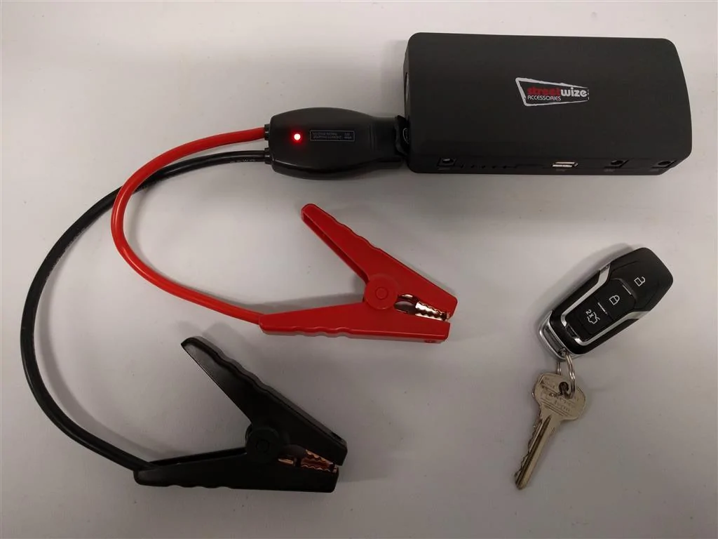

Being about to depart for our Euro trip I was a little nervous of a repeat episode so I decided to invest in a jump starter. I do leave the Mustang standing for extended periods and often much longer than 4 days so I had looked at these devices previously and there is a choice of big bulky lead acid and newer small and sleek Li-ion but none are recommended for engine up to 5000cc.
I decided on the Streetwize 14000 MAH Power Bank and Jump Starter from Argos £89.99 as this device specification is rated significantly higher than alternative devices and at least it should be easy to return.
It is stated that this unit is suitable for petrol engine up to 3000cc and diesel engine up to 2500cc
The significant specs are
Capacity 14,000 mAh
Start Current: 300 Amps
Peak Current: 400 Amps
Unfortunately it is not possible to simulate the conditions to fully test a jump start so I had to wait for a real emergency which occurred today…
I had left the Mustang standing for 6 days and went to open the trunk using the fob but these was no response. I tried to open the driver’s door and again no response. It was a totally flat battery this time. After a few minutes experimentation I managed to slide the little cover off the door handle and used the emergency key to open the door. The start button triggered some odd indicator lights behaviour and nothing else. Unfortunately the jump starter was stored in the trunk and inside the spare wheel well so I got the back seats down and managed to retrieve the storage box containing the jump starter. Next the hood was popped open and the battery cover removed. The jump leads were attached (red to red, black to black). As soon as the jump leads were connected to the jump starter the alarm triggered so I got inside and pressed the start button. The first start attempt produced some starter activity but the cranking stopped. The second start attempt worked straight away and the engine roared into life.
Before use 4 out of 5 battery charge indicator lights were lit and after use 4 out of 5 lights were still lit so I expect the jump starter would have worked for another attempt.
So there is proof. The Streetwize 14000 MAH Power Bank and Jump Starter from Argos £89.99 does start a Mustang 5.0 V8 from a totally flat battery. I never leave home without one.
It also charges iPhones :)
