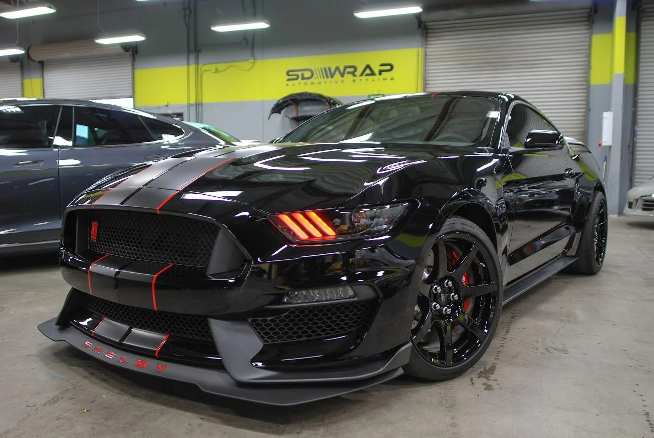

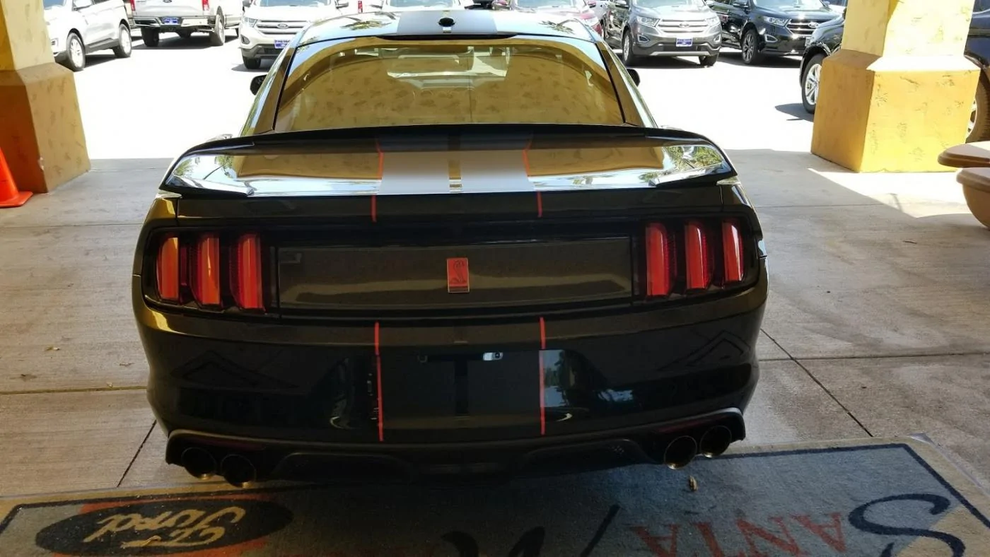

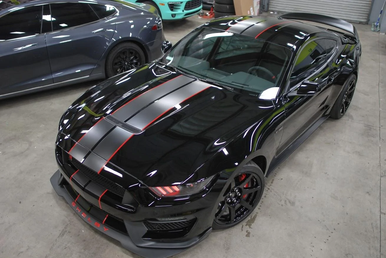

Here are some pictures of me and my little helper picking her up at Santa Margarita Ford.

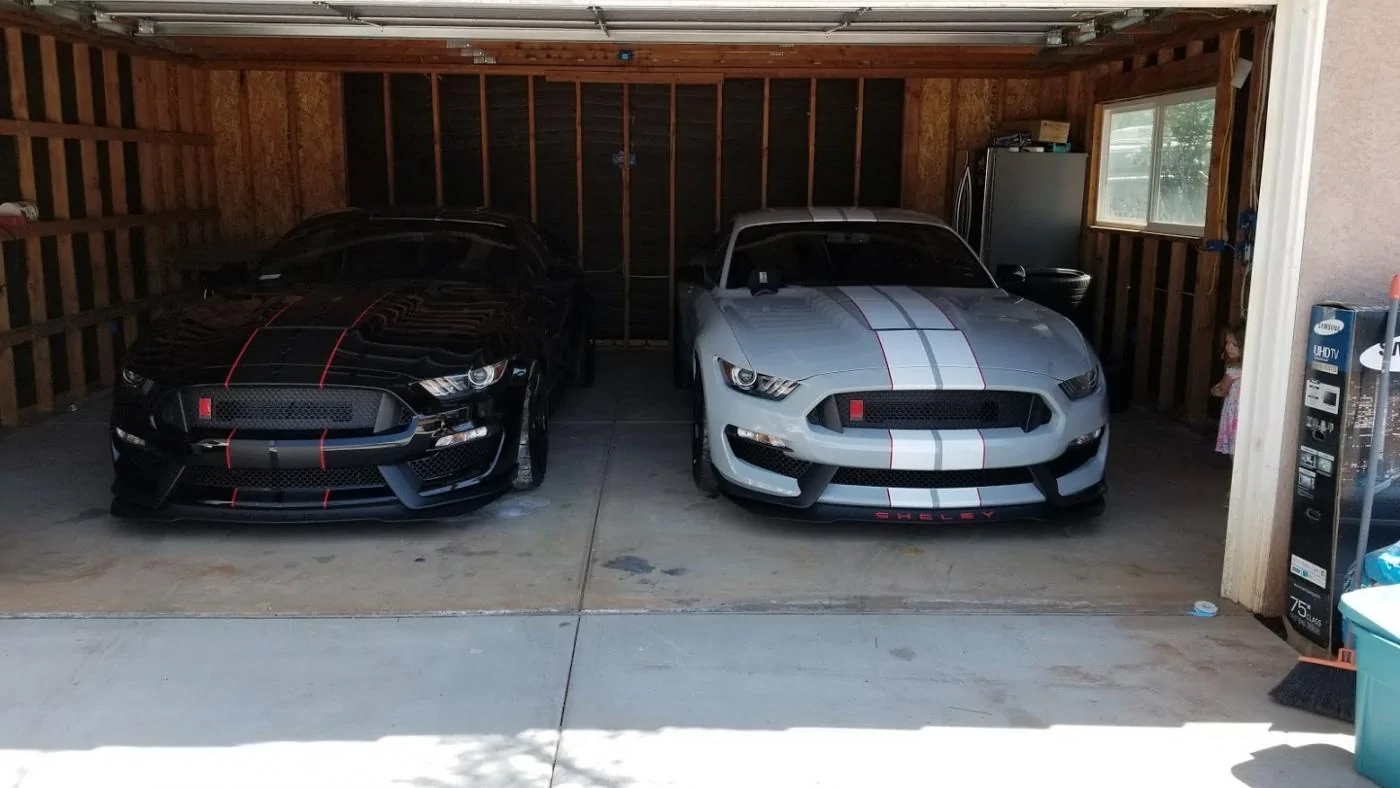

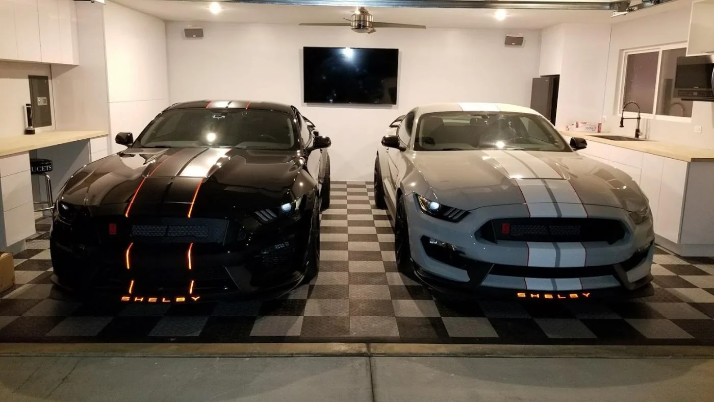

Working on my detached garage for the R's
Before and After... Also need suggestions for a build/car name.

Is your bed somewhere out of the picture or do you just sleep in one of the R's? ;);) Great looking garage Jorge and it goes without saying, great looking cars! Looking forward to following your build. :thumbsup:

Beautiful combination of cars! Looking forward to this build. Can't say that I'm not jealous.

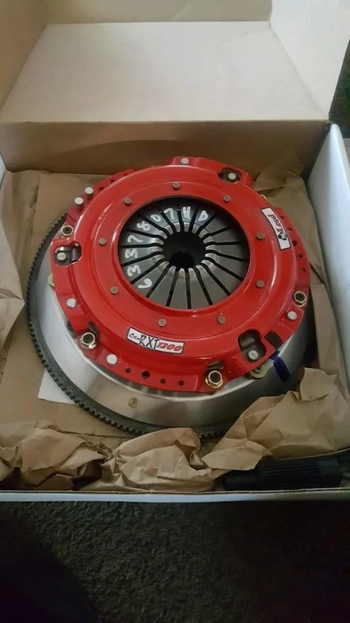

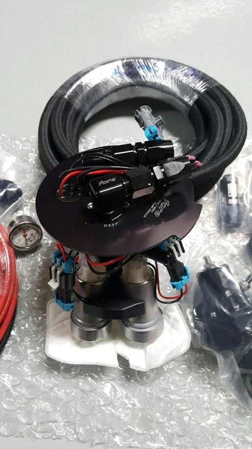

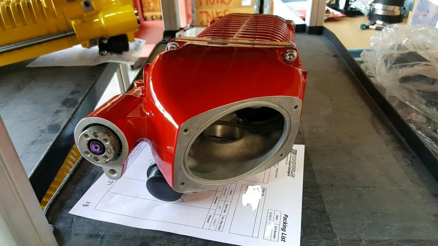

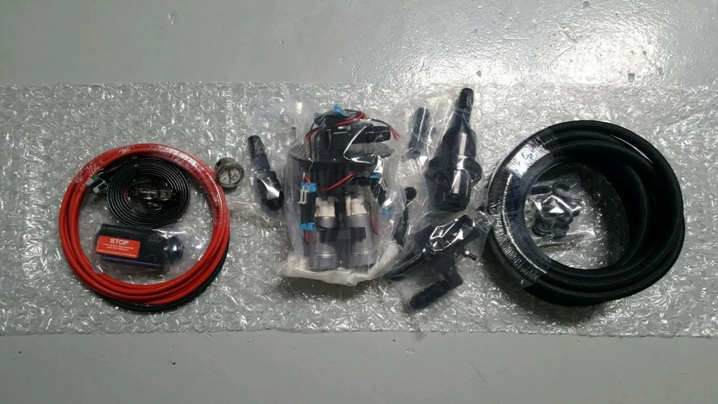

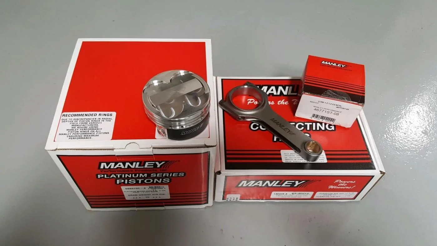

More parts coming in.:headbang:
