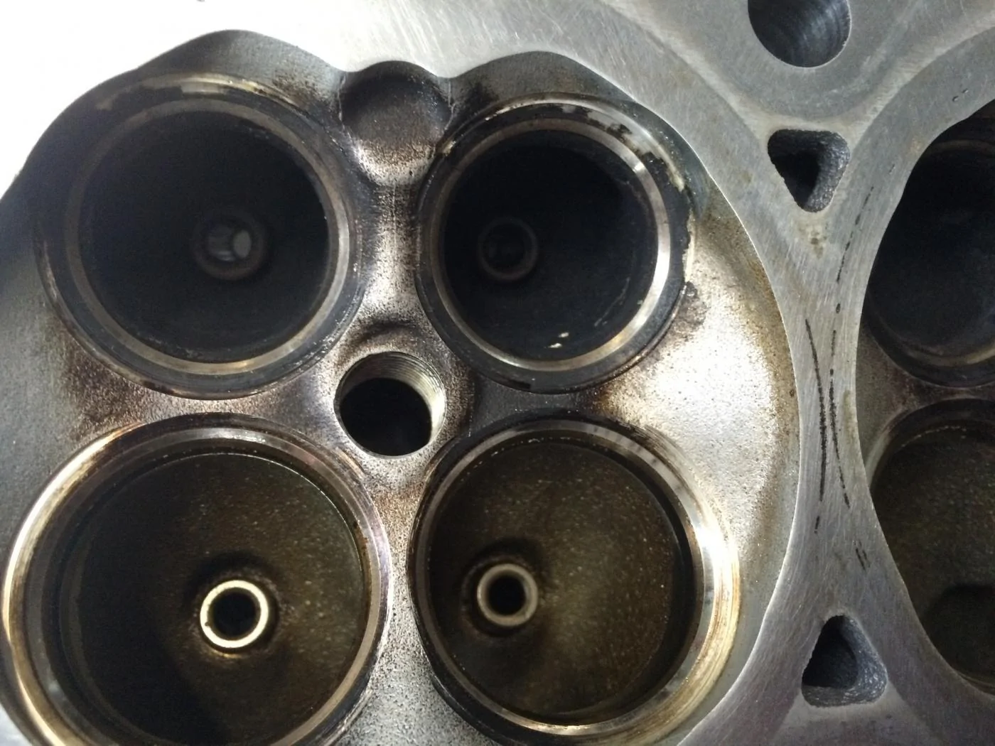

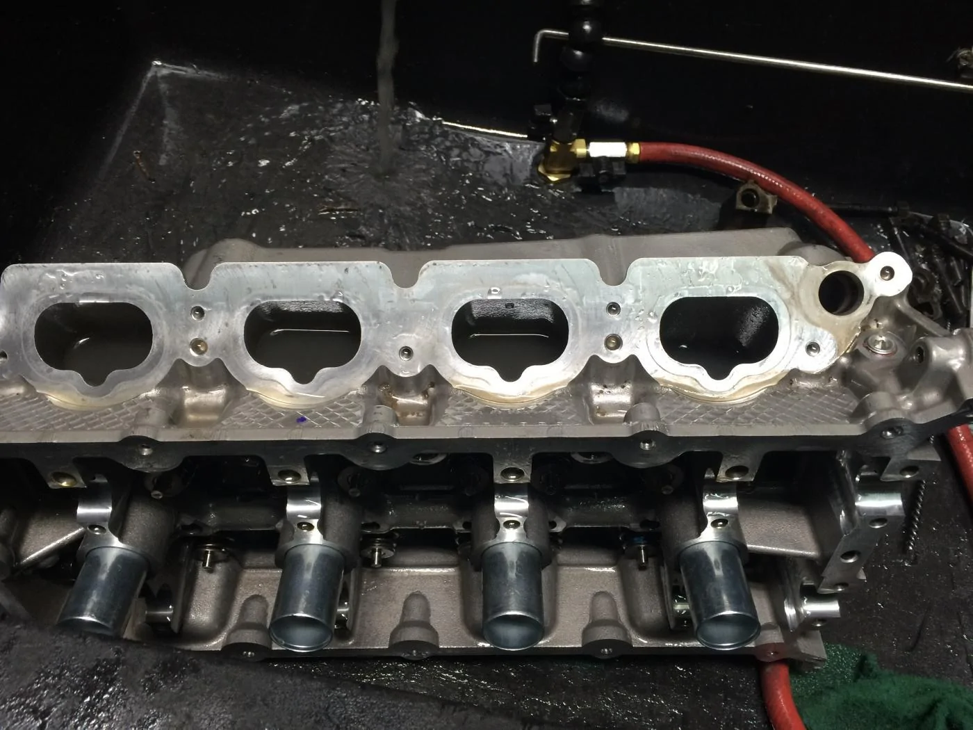

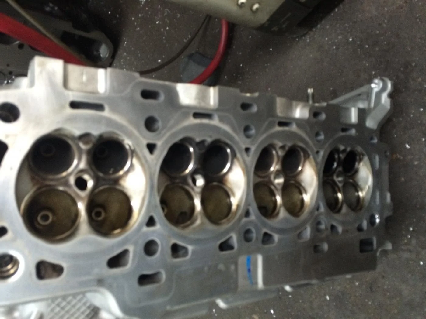

Recently started on some head work for a member
We have been busy so I'm late with updates but I'm starting to download some pictures
These heads where off a blow up. Most look great (lucked out) and will not appear to need and welding
These heads will be maximized for port velocities and flow numbers to match
The parameters given to us by the owner. I'll let him chime in with more information regarding that if he likes
For now here are some recent (dirty) pics and I'll feed more pics and information
