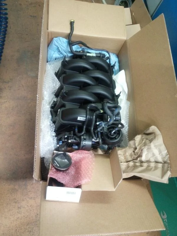

Part 3: more juice.
GT350 mani, GT350 TB, INJEN intake, nGauge with tune:

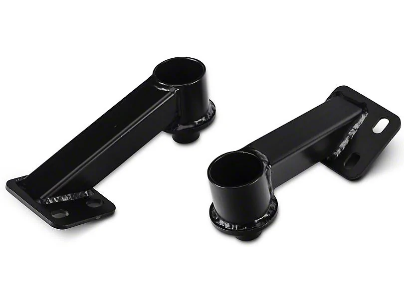

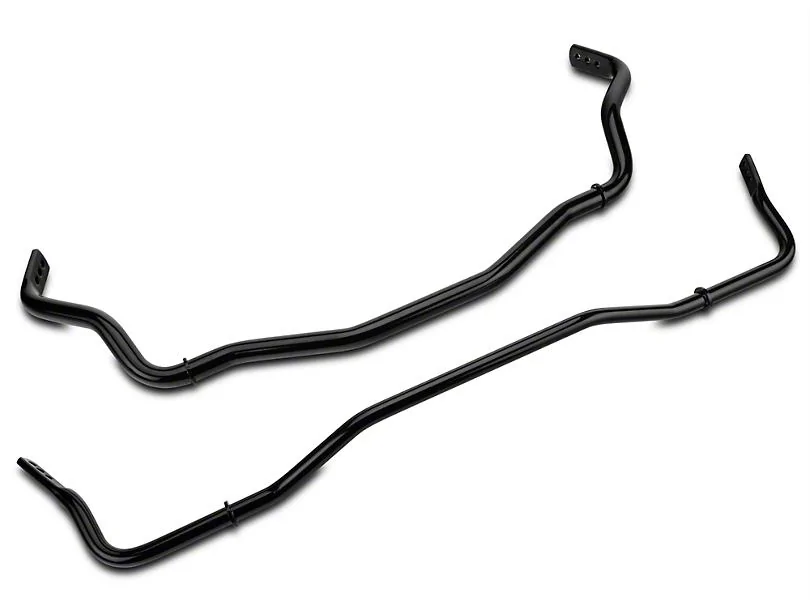

Next: suspension.
Waay to soft for my taste, waay to high for my taste. This is what I removed:
Parts: Eibach lowering springs, KONI yellow adjustable shocks, Steeda jacking rails, SR sway bars, vertical links and IRS tie down kit from AM:
Plus Ford Racing oil separator by the same time because why not:
No more wheel hop, the car is planted and super stable at high speeds. Initially I started with 50% for KONI setting but reduced it later
to 25% and it's still a tad too hard for my taste(for daily). I think something around 5-10% should be OK for street driving.
