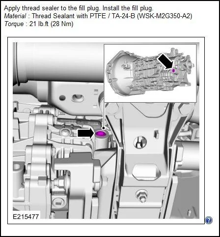

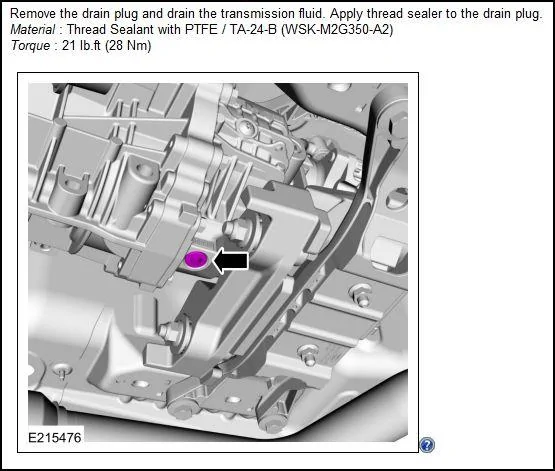

WHOOP...on edit, I see you are asking about the TR3160 transmission and not the engine oil pan. Hang on, I'll look it up...

The fill plug, on the side of the transmission, uses the same torque figure as the drain plug. Pay attention to the note regarding cooler equipped TR3160's.
