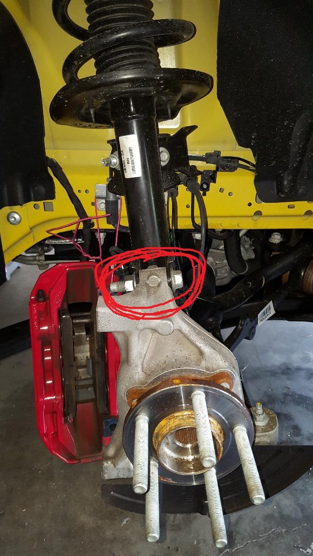

Vorshlag gives an approximation of 200 ft lbs and then tells you to refer to the OEM manual for the strut to spindle M16 10.9 bolt. A google shows varying different numbers.
I don't want to under or over torque the bolt. Does anybody have a shop manual with the specification?
Thanks!

184 ft-lbs is what my manual says too.
You're supposed to replace the bolts and the nuts, by the way. Cheap insurance at about $8 per side.
I'm going to be out at the dealer tomorrow. I'll pick up a set. Thanks very much to both of you!
